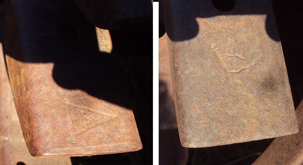

Rich, I like the little flag markings

The pennant has MSC in the legend. That stands for Michigan Stamping Company, a supplier of later Ford frames.
The other major frame supplier was Parrish & Bingham, typical marking is P&B in a circle.

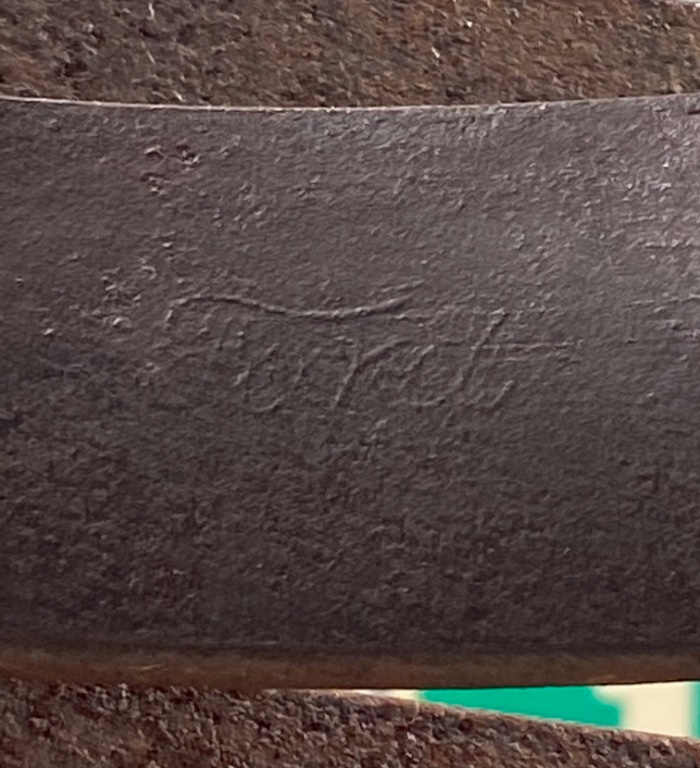

Then there’s this one which I would love to find out! Owner from long ago?
