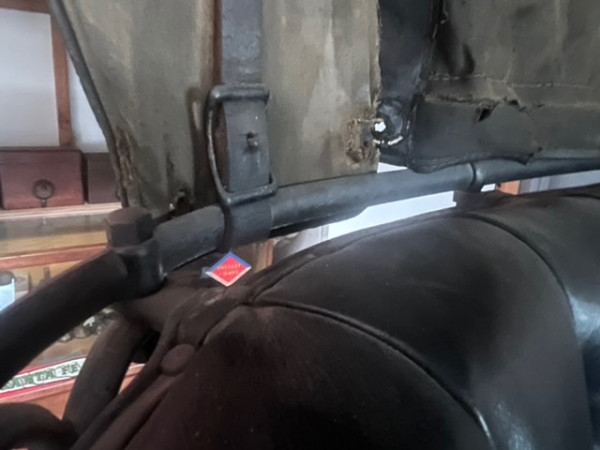

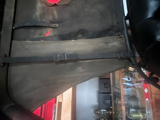

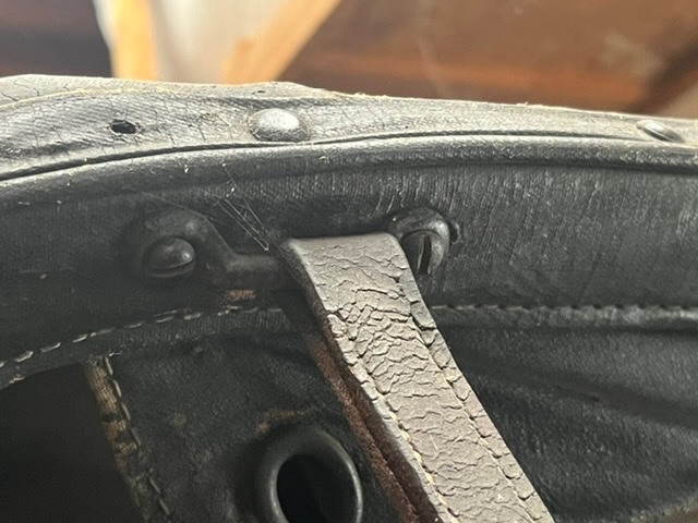

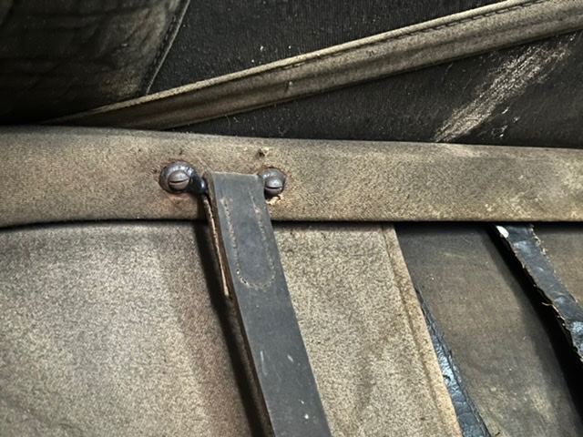

Re: Top installation on a 1910 touring
Post by KimDobbins » Fri Aug 05, 2022 10:48 am
Strap locations

Post by Belliott3 » Fri Aug 05, 2022 12:32 pm
Those pictures really help, Kim: thanks! But my rear straps have a black ring on the one end, so I’m guessing it attaches to the buggy rail supports on the back of the rail and doesn’t loop on itself like yours.

Post by Russ T Fender » Fri Aug 05, 2022 7:57 pm
For what it's worth my '10 has adjustable straps like Kim shows. My '14 has the rings.

Post by Aussie16 » Fri Aug 05, 2022 8:20 pm
Wonderful that Kim was able to share those original photos of 1910 top installation. If you want an authentic/correct installation you should try to copy the installation of those straps both front and rear. The front panel which fixes to the underside of the front bow is also quite unique to the 1909/10 Models. Some of this detail that is unique to the early tops may have been overlooked in the supply of your your new top?

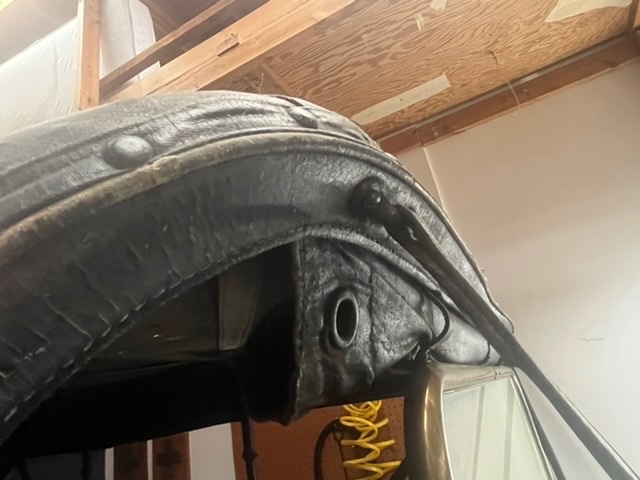

Post by Belliott3 » Sat Aug 06, 2022 11:27 am
So I’m curious: what is rolled up under the front bow? Is it a flap to cover the gap between the windshield and top?

Post by KimDobbins » Sat Aug 06, 2022 1:56 pm
A roll down windshield in case you didn't get a metal/ glass windshield with your car.
