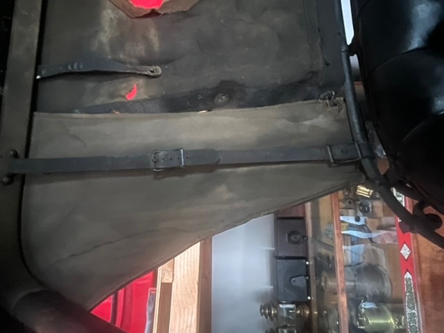

- Posts: 1627
- First Name: Kim
- Last Name: Dobbins
Topic author - Posts: 366

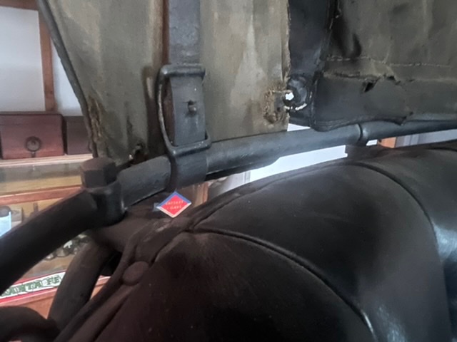

Re: Top installation on a 1910 touring
Those pictures really help, Kim: thanks! But my rear straps have a black ring on the one end, so I’m guessing it attaches to the buggy rail supports on the back of the rail and doesn’t loop on itself like yours.
For what it's worth my '10 has adjustable straps like Kim shows. My '14 has the rings.
Wonderful that Kim was able to share those original photos of 1910 top installation. If you want an authentic/correct installation you should try to copy the installation of those straps both front and rear. The front panel which fixes to the underside of the front bow is also quite unique to the 1909/10 Models. Some of this detail that is unique to the early tops may have been overlooked in the supply of your your new top?
So I’m curious: what is rolled up under the front bow? Is it a flap to cover the gap between the windshield and top?
- Posts: 1627
- First Name: Kim
A roll down windshield in case you didn't get a metal/ glass windshield with your car.
