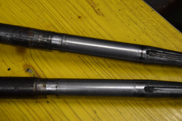

I examined all parts of the rear axle. The largest part is absolutely fine and can be reused.
The thrust washers are made of Babbit, already cracked and of course need to be replaced.
The Hyatt bearings on the Pinio as well as the inner Hyatt bearings are good and the dimensions are practically new. But the outer bearings are loose and worn. The axle shafts have also shrunk on the outside and the Pinion Bearing Spool has pitting. If anyone knows of an intact Pinion Bearing Spool or Hyatt outboard bearings it would be very welcome.
Due to the defective Hyatt bearings and worn shafts and also for safety, I thought of safety hubs.
But I don't like cutting the axis. That's why I'm interested in your offer, Mr. John Zibell. Would it be possible for you to send me some photos of the safety hubs and the axle halves? Preferably by email to betschartbeat@gmx.ch

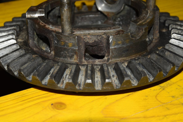

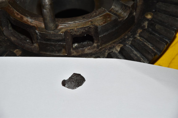

By the way, during dismantling there was another surprise. In a hole from the differential case there was still a remnant of the casting. Barely a touch and it was gone!
If only that had come between the sprockets!

If the spool only has that worn side, turn it 180 degrees. You only need a good thrust surface opposite the ring gear. Give it a light cylinder hone.
Axle bearing outer surfaces look ok. They originally measured 1.062" . if smooth & near 1.060, you are good. Bearing rollers originally are .500" .498" rollers are real good. Some of the suppliers bearing sleeves are thicker than stock & can tighten the wear issues.
I wouldnt worry about breaking original axles, unless they were run with the type inner seal that cut a shallow groove in the shaft.
Stay with stock, original parts if possible. The exception would be one of those double timkin pinion bearing conversions if you cant find a good original hyatt bearing.
By no means use the solid hyatt solid replacement rollers unless its going into a museum as a static display.

I checked my axle shafts. They still measure 1,057" on the outside. They were also operated with the incisive seals. Furthermore, the keyway for the hub is no longer quite 100%. I think they would still be sufficient for operation with safety hubs. Without them, I have my doubts.
The outer Hyatt bearings are loose and worn on one side.
The spool tip is great.
In an emergency, I could imagine using them like this. But I'm looking around to see if there's anything else I can find.
Regards

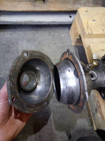

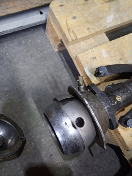

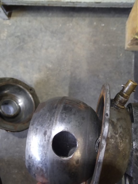

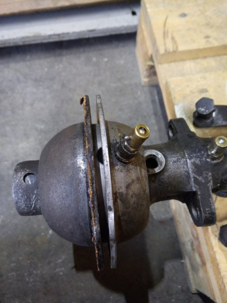

I have now discovered another problem. What's the best thing to do when the ball is loose at the driveshaft? Tried to put in a disc from Snyders. But then it gets too tight.

Since adding a ball "shim" makes for too tight, you dont have a problem of "excessive" wear or loosness.

The shims as they are made a too wide. Trim a little strip off the side of the shim towards the drive shaft. If there is still a gap between the flange and the ball cap a paper gasket can be installed between the two so the bolts can be tightened without causing the ball to bind up. I've done it this way several times and was able to eliminate all play in the ball connection. Getting the fit tight again here will often eliminate an annoying clunk when shifting into high and can also cure noises as the car comes to a stop with the transmission brake.

Agreed!speedytinc wrote: ↑Thu Jul 28, 2022 8:28 amSince adding a ball "shim" makes for too tight, you dont have a problem of "excessive" wear or loosness.

I would not worry about it. It is just a housing for the universal joint. Most important is to make sure the 4 th main is straight on the crankshaft and pan. Is it still loose when all four bolts are tight or just now in the picture. When you have it all installed it may not be loose anymore.

The ball cap is widened quite a bit on the back.
It would be best if I could replace these as I have now disassembled the whole driveshaft and rear axle.
But I can't find a replacement for a 1926 from any supplier. Is there really no replacement for the ball cap?

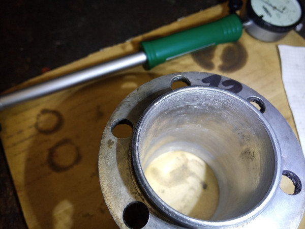

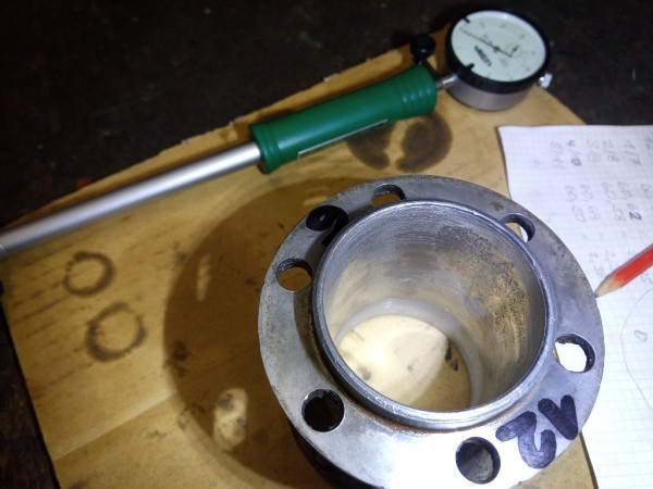

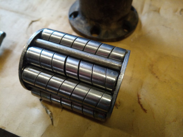

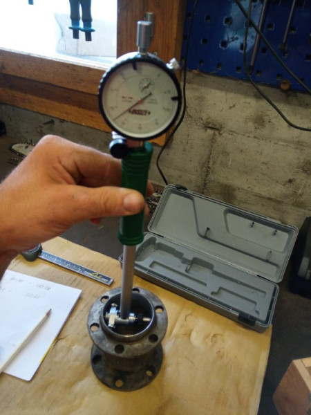

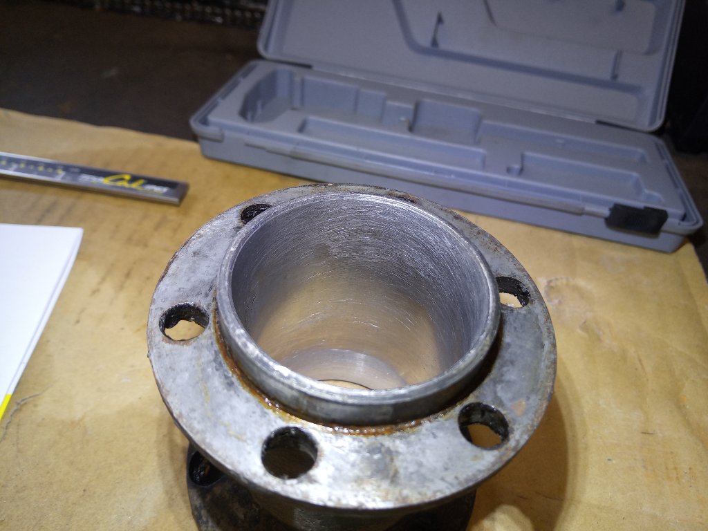

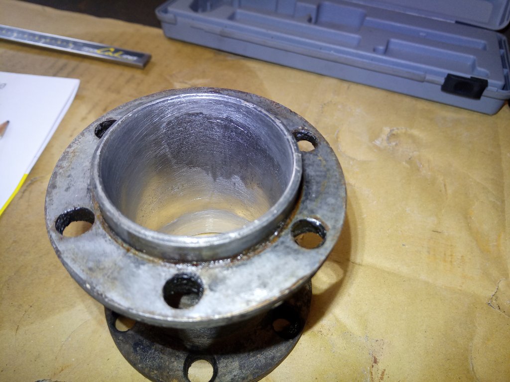

I checked and measured my spool and the Hyatt drive shaft bearing again. I would like to keep the Hyattbearing.
The spool measures 2,377 to 2,387 inches on the inside.
The Hyattlager is nicely parallel and measures 0.559 to 0.560 inches.
Can these parts still be used? Does anyone have a spool in better condition that they would sell?
Greetings from switzerland
- Posts: 4955
Re: Rebuild Touring 1926 rear axle
The spool only needs 1 good side, the thrust side.(opposite the ring gear) Give it a quick hone. If you have a good side, you are good to go.
The bearing measures good.
Any of that little bit of wear will be taken up during the new ring & pinion mesh setup.
Spool std size is 2.375 & bearing is .562"

What thrust side do you mean? The bottom side, that takes pressure during braking? The top side, that sees pressure while driving? The far side, (away from the ring gear), that sees the pressure of holding the gears in mesh?speedytinc wrote: ↑Thu Aug 18, 2022 3:44 pmThe spool only needs 1 good side, the thrust side.(opposite the ring gear) Give it a quick hone. If you have a good side, you are good to go.
I do see your point. But, I'd only do what you say as a last resort. I'd search out a better spool rather than use one .012 out-of-round.

Hi
I'm also afraid the wear and tear is a bit high. Further, this will make it difficult to set the gears green. But finding a good spool is difficult?
Greeting

Of course, I would consider finding a better spool. Real nice ones are not that common. (I look @ everyone I see @ swap meets & rear end part outs.)Jerry VanOoteghem wrote: ↑Thu Aug 18, 2022 4:30 pmWhat thrust side do you mean? The bottom side, that takes pressure during braking? The top side, that sees pressure while driving? The far side, (away from the ring gear), that sees the pressure of holding the gears in mesh?speedytinc wrote: ↑Thu Aug 18, 2022 3:44 pmThe spool only needs 1 good side, the thrust side.(opposite the ring gear) Give it a quick hone. If you have a good side, you are good to go.
If I was particular, I would find an enclosed spool & get a new bearing race. They are available new.
But with one side only .002" worn, It could be a very good part functionally. Turning the spool 180 degrees puts the virgin part of the spool in play. That area got no use. I get your concerns in accelerating & braking regarding the pinion's up & down movement. Let me address that.
If I had the part in my hand for proper scrutiny I could make a definitive decision either way. My experience with these spools suggests what I would expect.
Thrust side 3 o clock.(Virgin race, may be standard) ["The pressure side holding gears in mesh"]
2.377" measured @ 12 & 6 o clock. [Braking/driving pressure]
Worst wear @ 9. This worn area(bad spot) runs from 8 to 10 o clock. This is closest to the gear mesh & is not contacted with the bearing.
Between 7 & 8 and 10 &11 the wear tapers.
I hope my explanation is clear enough to get my view clear on the subject.
To my thinking, this spool still has very good dimensions where it counts.
I have used spools in the pile that measure 2.380" & 2.382" deemed good enough to save. This one in question could be a much better part IMO.

Thank you for your detailed description. I have now measured my spool again. It's close to your guess.
12&6 o clock 2.378"
1&7 o clock 2.380"
2&8 o clock 2.387"
3&9 o clock 2.385"
4&10 o clock 2.387"
5&11 o clock 2.382"
The worn area can be seen in the pictures. 11 to 1 o clock is also porous. That was below. Maybe rust due to water / condensation in the gearbox?
Can I risk it with this spool?
greetings from Switzerland

- Posts: 4231
In all likelihood, if you positioned it in the best possible way, as described above, you would probably be okay. I don't imagine the rear end was needing a rebuild solely because of this issue. I'm sure many of us, with cars restored long ago and lots of miles on them now, have this same situation and don't even know it. Still, I would at least attempt to find a better one first.
- Posts: 4955
Agreed. A quick hone will confirm the best of the bearing wall. I think its usable. Look @ the worn spot & make sure there is no metal flaking away. If there is, I wouldnt use it for risk of the metal doing damage to your bearing & new inner race.Jerry VanOoteghem wrote: ↑Sat Aug 20, 2022 1:06 pmIn all likelihood, if you positioned it in the best possible way, as described above, you would probably be okay. I don't imagine the rear end was needing a rebuild solely because of this issue. I'm sure many of us, with cars restored long ago and lots of miles on them now, have this same situation and don't even know it. Still, I would at least attempt to find a better one first.

- Posts: 4955
I stay with original parts.
I understand that F/P type conversions work very well. I would consider that a good option.
