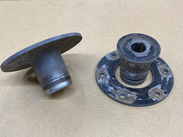

Unusual to me, anyway. 1924 Speedster, pulling away from a stop sign and GRAUNCH. Car coasted to a stop about eight blocks from home. Almost pushing distance.
The cause was clear after pulling it apart the next day, but it has me wondering... did Ford make some of these hubs in two pieces? That's an awfully clean break otherwise, considering I pushed the car maybe only 40 ft after it failed, hardly enough to 'polish' the mating surfaces against each other.

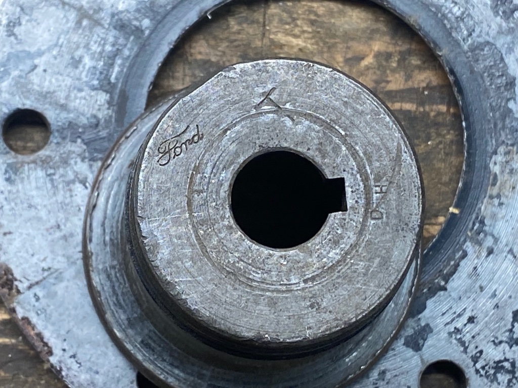

The failed hub has a Ford script, along with a T and a separate D H stamped in the end. The D H looks like my set of stamps, but I don't remember doing it or if I did, what it might mean. This hub has been on the car since 1992 or might have been replaced during a major overhaul around 2009.
Anyone else seen this kind of failure?

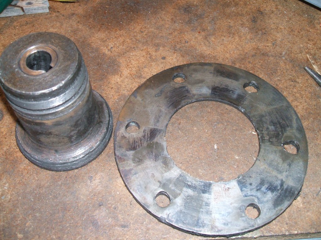

Yup, happened to me exactly the same way. I had never seen this particular failure before but Forum members assured it does happen. It happened while on the steep part of my driveway (scary!) but parking brakes got the car slowed in time to prevent taking out the sheep paddock fencing, a good reason to keep the parking brakes in good condition. I might consider some AC brakes, but no ugly discs.

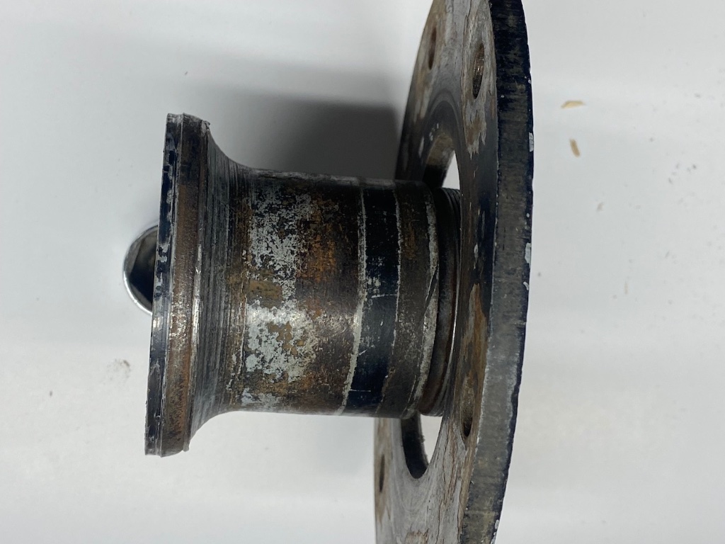

Here's mine:
