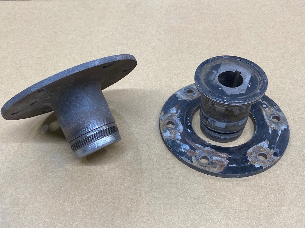

Unusual to me, anyway. 1924 Speedster, pulling away from a stop sign and GRAUNCH. Car coasted to a stop about eight blocks from home. Almost pushing distance.
The cause was clear after pulling it apart the next day, but it has me wondering... did Ford make some of these hubs in two pieces? That's an awfully clean break otherwise, considering I pushed the car maybe only 40 ft after it failed, hardly enough to 'polish' the mating surfaces against each other.
The failed hub has a Ford script, along with a T and a separate D H stamped in the end. The D H looks like my set of stamps, but I don't remember doing it or if I did, what it might mean. This hub has been on the car since 1992 or might have been replaced during a major overhaul around 2009.
Anyone else seen this kind of failure?

I'd guess the circular wear cuts had something to do with it failing.

Seen it several times before.
It's uncommon but not that rare.
A wheel that wobbles will fatigue that stress point.

It happens to 26/27 wire wheel hubs too.
Really, they should be Magnafluxed prior to installation in a wheel, though I admit, I've never had that done. I do however clean the hubs very well and visually inspect for cracks. Better than nothing, but maybe not much better... Also, no guarantee that a hub that passes Magnaflux won't eventually do that anyway.
Interesting break. The large radius between the flange and hub nose is obviously there to reduce stress concentrations and prevent this sort of thing. However, there is no such provision on the backside. In fact, there's a sharp corner adjacent to the pilot diameter that the brake drum locates on. Looking at the angle of the fracture, I'd say that the crack began in that sharp corner on the backside of the flange.

I have seen it before. It can leave you with no transmission brakes, just like a broken axle. I have also come across a couple of welded up hubs!

I think that I can describe it better than I did in 2015. You're rounding a corner fairly fast and the spokes and are saying "this is tough I need to bend a little." The backing plate that they're bolted to is saying "well, okay, I'll try." The hub stem is saying "hey, you're a part of me and I can't bend because I'm attached to this rigid axle and it won't let me". so if the spokes are solidly pressed against the hub backing plate (tight hub bolts) and hub stem, you have a strong unit somewhat not breakable and nothing breaks, it all stays rigid. But if the spoke butts are not really real tight against the hub stem then that weakens the unit a little and it breaks at the weakest point. The wheel and backing plate break from the hub stem. Sound logical?

Just to add to Ed's explianation above. If you think about the forces on the flange, the outer wheel plate, when securely bolted to the face of the wood spokes, effectively carries a radial load against the wheel hub, preventing the hub flange from reversed bending in a turn. If the outer plate can slip on the spoke face, the hub flange carries all the flexing motion. This motion and the resulting reversed bending is actually the cause of the flange fatigue failure. If the cars were only driven in a straight line, this failure mode would most likely never be seen.

Ford rear hubs are steel, not CI. The front hubs are malleable iron. This is a classic fatigue failure that is due to repeated bending cycles. Ford must have recognized this failure mode was possible given the generous radius in the corner of the flange which prevents a stress riser that a sharp transition would create. Bottom line is keep your hub bolts tight.

I have seen hundreds of failures like this in testing for rotary fatigue. Car companies are well aware of this type of failure Prevention includes hardening in this area, geometry, and material type
Normally, hard cornering causes this problem. I cannot comment about spoke influence, I am not old enough to have worked during the wooden wheel Era

Dan, the generous radius on the outer side of the hub next to the spokes does indeed make for a less stressed transition between hub and flange. However, there is no radius between the flange and the shoulder which supports the brake drum on the inside of the hub. My guess is the failure begins here.
