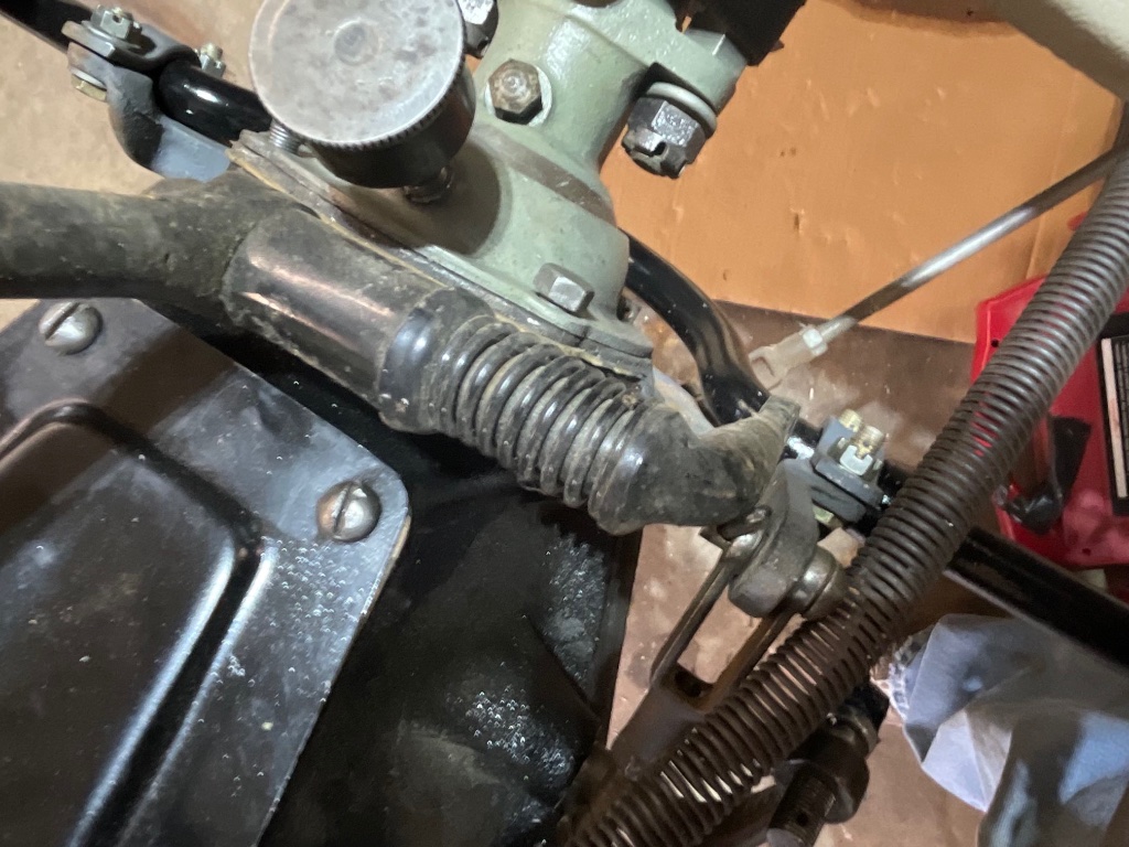

I’m sure there’s a way to run both but my shifter is hitting the rocky linkage from the brake pedal. Do I have to run the hand brake shifter or something?

Try turning the shifter around so the spring is on the other side.
Your shifter is mounted backwards.

Sometimes you can’t see the forest for the trees, thanks
