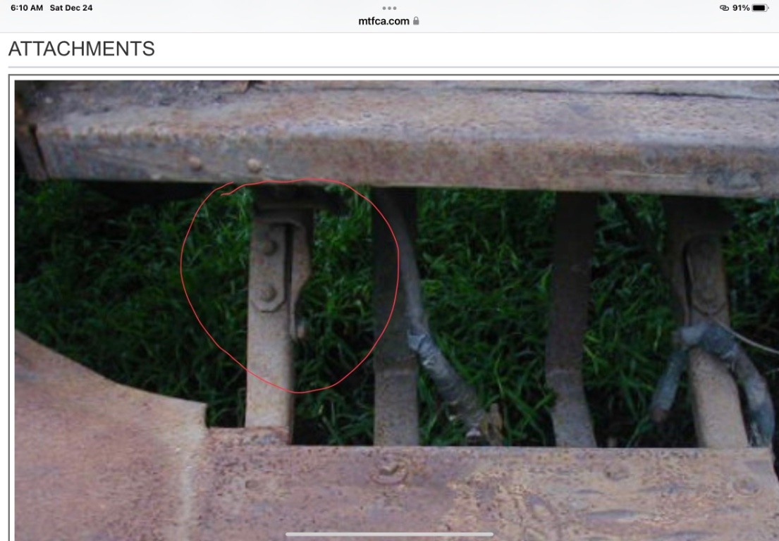

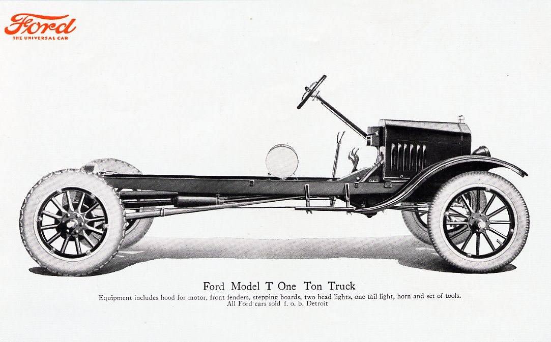

Interesting running board brackets. I have not seen those in my perusing of the web.
- Posts: 6781
Re: TT Hood Forner
Mike
Re: running board brackets...
be careful with making any conclusions from Artist Renditions
they can be hilariously wrong sometimes

Re: TT Hood Forner
They sure are some funky looking running board brackets. Unless it was a tried and failed thing.
Artist's renditions sure can hold some stunning mistakes like Scott mentions! Then other times, they're spot-on accurate.

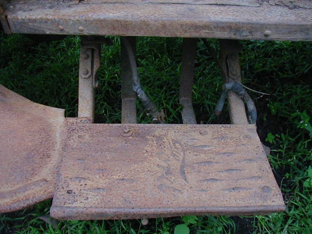

I'd imagine this is what your more used to. Me too. Best I can tell these two pics are from '24 or so TT here.
This driver's side running board was likely moved out to fit the Group 2 battery bought and they ran with it.
Group 1 is the standard size. Smaller.
That pic of the early TT chassis is gorgeous! Coil box ign switch, radius rods over the front axle and those funky brackets!

What are the partial brackets attached to the sides of the running board brackets in your pic? Is it part of the battery holder?
Two of my running board brackets have holes on same side. Guessing I have (2) of either the front or rear brackets on the same side?

I found my answer in another post with a TT battery holder pic posted by George House.
