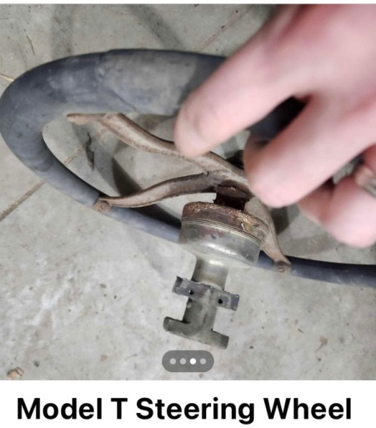

Since it's too cold to work in the garage and the car is in a really inconvenient spot in the garage, I'm stockpiling parts for warmer weather. I have new coils now! Anyway, when I bought this car, '26 Roadster, I've noticed that the steering wheel is....wiggly. I bought a stock steering wheel and braved the cold last week (sub zero) enough to see how it would look and disassemble the steering gears. I really can't tell much. There is some grease in there. A couple times when I was driving it if I turned the wheel while stopped I would hear a popping sound. Just a single pop. The car steers pretty good and isn't hard to handle. I see some new gears online. Would I just go with a new set of 'oversized' gears to make up the 'slop'?

I've found the most common cause of that pop to be the pitman arm on the bottom of the steering shaft to be a little loose.

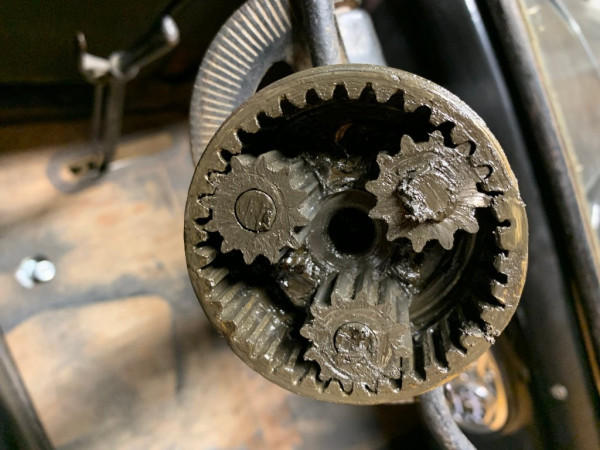

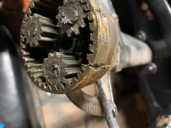

I’ll have to try to post pictures later, but I checked on it again tonight. It appears the threads on the gear cover and case are just worn out. If that little screw didn’t hold….I suppose the wheel would come right off? Is there any fix for this? I see new steering gear covers (3504B) are available, but what about the case?

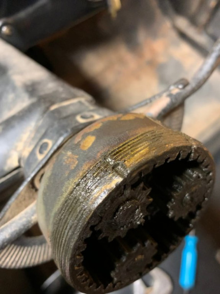

Post by CatGuy » Fri Dec 30, 2022 8:17 am
Posts: 4082
Re: Wiggly Steering Wheel
Post by Jerry VanOoteghem » Fri Dec 30, 2022 8:53 am
The bad news is that you need another steering gear case. Yours is badly split and somewhat dangerous as it might cause the steering to lock up on you. Others here might encourage you to repair it. My sincere hope is that you find a good used one. Do they make these new??

Post by CatGuy » Fri Dec 30, 2022 9:15 am
I wondered if I was seeing a split there. I might know of someone that has another one. It appears that the threads are so bad that the only thing holding it together is that little screw. :shock:

I would degrease , clean , and then braze that crack in the steering case. Reinstall regrease, put a new cover on that would compensate wear on the center gear that the steering wheel attaches. Replacing the case requires drilling out the old rivets and then installing the replacement case with new rivets. That would be the next step if you could find out who can do your rivet work

The popping sound you heard was probably the sun gear jumping a tooth, or could have been the case splitting. Either way, I'd replace the case, cover, pins, and gears, or find a good used assembly. If your steering wheel can be turned left and right without moving the front wheels, that is "slack", or "free play" and it can be caused by wear or loose parts anywhere in the steering system. "Wiggle" suggests that the stub shaft the steering wheel attaches to is loose in the steering box cover, allowing the steering wheel to wiggle or wobble on the column. A car can have both conditions. A T with good steereing is a pleasure to drive on any decent excuse for a road.

You're assuming he can't install two small rivets, but also assuming he can braze the case back together safely? That case is toast. The threads are shot to the point that the cover falls off without the retaining screw in place.

I would not even try to repair that steering box. It is very important for your safety to have a good one. I can't say why or how that happened, but you could lose all control of steering if you drive it that way. imagine going around a corner and not being able to straighten out.

Exactly, Jerry. I can push the cover on the case without threading it on. The threads are gone. The only thing that is holding the cover on is that screw!

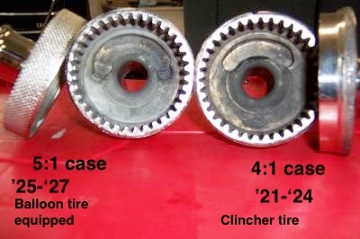

As noted in the previous replies, do get the proper '25-'27 steering case for your '27 with balloon tires, the ratio of the cluster gears will be the later 5:1 and that steering case to use is the one with the wider groove for the stop pinion.
And find a good used one with good gear teeth too, you can then use the reproduction 5:1 gear sets, and change out your pinion posts on the steering shaft too. Makes for proper repair to use good used parts or new parts.

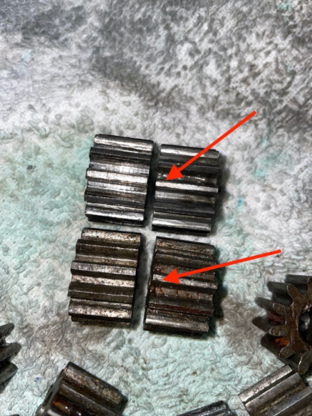

late and early case with groove .jpg (43.29 KiB) Viewed 8352 times
Note the condition of used cluster gears, some are so worn out with sharp teeth, you can't have good steering.

As of noon today, we found out the threads on the case are shot. Pictures did not show that, and some had assumed that the grease on the threads was blocking the condition of the threads. Having something in front of us to observe in person is a lot better than unclear pictures and comments, pro or con.... Cat Guy., Keep us informed of your progress, 👍

I've been playing with T's for over 50 years and have never seen a more worn out steering box than this before. Why would anyone waste 10 seconds thinking about any sort of repair? It's a '26-'27 column (not 1909) and there has to be hundreds if not thousands of decent used ones around (I must have seen 30-40 at Hershey 2022 and I wasn't looking for one). As well, after seeing this totally worn out steering box still in use, a great big red flag would go up about the condition of the rest of the steering system along with all other mechanical components of this car. Model T steering is just one step above go-cart steering to begin with so don't take chances or settle for any quick patch-up fix. Sorry if I offended anyone but this is not something to take lightly as your life and the lives of others are at risk with this sort of stuff on the road. Good for you for questioning it and getting help.

I need to be educated here on what makes this one bad before I buy a ‘new’ one. I need to know what I’m looking for. I know that the steering wheel wobbles and the threads are bad, but beyond that what are other possible red flags?
Scott Rosenthal
Post by Scott Rosenthal » Sat Dec 31, 2022 9:10 am
No good reason to repair this very common, heavily damaged part.
I would expect this replacement part to cost approximately 75.00. Fair amount of work in changing this out, but no where near the work required for the earlier (2) piece style.
Scott
Posts: 7391
Post by TXGOAT2 » Sat Dec 31, 2022 9:16 am
The steering assembly you have shows clear evidence of extreme wear and abuse. The steering gear case is actually split apart. The condition of these parts may, or may not, reflect the condition of other mechanical parts of the car, but I would expect that it might, and I would inspect the entire chassis, engine, brakes, wheels, etc, before driving the car. You're dealing with a century old car. Some people will drive a car with steering issues until something breaks, while spending time and money on cosmetics or engine issues. Your car may be in good condition overall, but the steering box certainly isn't!
Posts: 4082
Post by Jerry VanOoteghem » Sat Dec 31, 2022 9:56 am
CatGuy wrote:
Sat Dec 31, 2022 7:59 am
Bruce Compton wrote:
Fri Dec 30, 2022 9:12 pm
I thought we've covered that fairly well... Cracked. Worn out threads. Unsafe. What else is left to say?

Just wanted to make sure that there wasn’t something else like the gears being bad, are there spacers or bushings in the column that need replaced? I just have lots of questions. Sorry.
Posts: 4082
Post by Jerry VanOoteghem » Sat Dec 31, 2022 10:30 am
CatGuy wrote:
Sat Dec 31, 2022 10:09 am
Nothing to be sorry about. The gears do appear to be fairly well worn also. At this point, every piece needs to be inspected for wear. Also, the 3 pins that the gears roll on. Are they tight in the steering shaft? What is the condition of the steering box cap? Are its threads also very worn? How well does the steering wheel shaft fit in the cap? If you end up buying 3 new gears, you should also buy a new steering wheel shaft.
First however, see what you can come up with as a replacement for your gearbox. Maybe you'll end up with a complete replacement column that will also address any other issues.
Posts: 4634
Post by Norman Kling » Sat Dec 31, 2022 10:35 am
I would suspect that the pinion (the gear in the middle was being pushed very hard against the planetary gears(the three which rotate around it) into the ring gear (in the case) and pulling very hard on the steering wheel over the years caused the bronze to crack. The whole thing should be replaced with a better one. The big swap meet I was thinking about is in Chickasha Oklahoma in the spring. Someone who regularly attends it would know the date and location.
Posts: 4433
Last Name: Kuehn
Location: Texas
Post by John kuehn » Sat Dec 31, 2022 10:52 am
Yes.
Getting yourself a good replacement steering column is the way to go. I wouldn’t try to overthink what you need to repair the one you have. What you could is to plan to get another good column assembly and remove the one you have from your T.
Consider this a learning experience and removing the column you have, taking it apart to see any wear it has and etc will put you on the way to learning about a T.
If your replacement column has some wear you’ll know how to work on it since you would have already taken apart your old one to see what’s what.
Bruce Compton
Posts: 665
Joined: Thu Jan 10, 2019 11:23 am
First Name: Bruce
Last Name: Compton
* REQUIRED* Type and Year of Model Ts owned: 1921 Coupe, 1925 Coupe
Location: Kemptville
Post by Bruce Compton » Sat Dec 31, 2022 1:56 pm
Lots of good advice on this topic, but it still amazes me that anyone would suggest repairing this mess. This damage shown had to be incurred by driving this vehicle on the road, either by the current owner and/or by probably several previous owners, so if anyone of the previous drivers felt secure when driving this car on the road with steering this bad, I can only imagine that there may also be several other mechanical issues taken for granted as well....(brakes, tires, wheels, bearings, rear end thrust washers, spring shackles, lights etc.). I personally know some T owners that drive their cars with obvious problems that they accept by saying "that's the way all T's are supposed to run", or "they're 100 years old....what would you expect" . The brutal truth is that if you're involved in a collision with your T on the highway, you will be very lucky to just end up in the hospital. I recall watching a video where a new Chevy Cruise and a 1959 Chevy met corner to corner (head on) at 50 MPH. The Cruise driver (dummy) walked away and the '59 driver (dummy) died. Imagine his chances in a Model T.................

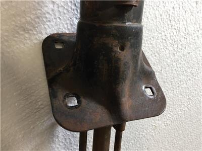

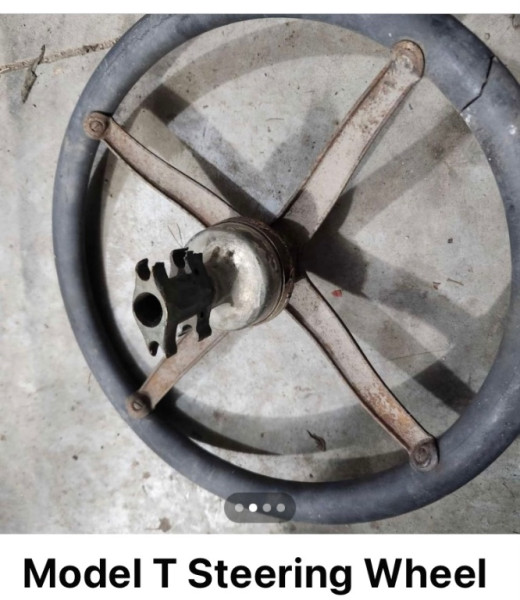

Will only 26-27 steering columns work in my '26 Roadster or will other years? How do I tell these apart?
Posts: 4433
Last Name: Kuehn
Location: Texas
Post by John kuehn » Tue Jan 03, 2023 9:49 am
Since you have a 26 Roadster your steering column should have a rectangular mounting bracket.
All other earlier Model T steering columns have a round mounting bracket.
If you try to use an earlier one THEY WONT FIT to your firewall and it will make things more difficult for you.
The steering column mounting bracket is the one that mounts directly on the firewall.
If you going to a swap meet this is what you look for and the easiest way to tell the difference.
I would suggest you contact one the T parts suppliers and tell them you want a good steering column for your 26 Roadster. Start with Lang’s as they and the other suppliers will be able to help.
I would suggest you get the Ford service manual, part supplier parts catalogs and other T publications to see and learn the differences in the 26-27 T’s from earlier Model T’s. They can really help you.
Posts: 4082
Post by Jerry VanOoteghem » Tue Jan 03, 2023 4:09 pm
As John described, your steering column mounting flange should look like this...

CatGuy
Posts: 317
Joined: Wed Apr 06, 2022 9:50 am
Last Name: Hunt
* REQUIRED* Type and Year of Model Ts owned: '26 Runabout
Location: Pella, Iowa
Post by CatGuy » Tue Jan 03, 2023 4:42 pm
Thanks! I looked at mine again and it looks like that, as we'd expect. I'm checking around and will contact Lang's.

I’m still searching for a complete column, but I found this. Would it fit mine? It looks like it.
Posts: 4433
Last Name: Kuehn
Location: Texas
Post by John kuehn » Wed Jan 04, 2023 9:44 pm
To see if it’s a 26-27 case you need to remove the steering wheel nut and take off the steering wheel. You cant tell from the outside as far as the gear case is concerned. The gears inside will be the determining factor along with the groove inside the case. Once the wheel is off remove the small screw that holds the cover in place and look at the gears and case groove. There are some comparison pictures on this thread that show the gear differences and the differences in the grooves in the bottom of the case.
Bruce Compton
Posts: 665
First Name: Bruce
Last Name: Compton
Post by Bruce Compton » Wed Jan 04, 2023 10:13 pm
That looks like a 15" or 16" wheel and '26-'27 were 17" diameter. You don't need to remove the steering wheel from the main shaft, just remove the locating screw and unscrew the cover. The 4:1ratio planetary gears are the same size as the drive gear and with the 5:1 ratio, the drive gear is smaller than the planetary gears. BTW, you should also check the "bushing" at the bottom of the column where the main shaft exits, as well as the support box (at the frame) for wear on the shaft and the bushing(s) if you're thinking of re-using your original column..
Moxie26
Posts: 1863
Last Name: Jablonski
Location: New Jersey
Post by Moxie26 » Wed Jan 04, 2023 10:33 pm
Looking at your pictures, and the markings on the steering case cover, I would say it has the 4 to 1 gearing.
Posts: 5171
Post by RajoRacer » Wed Jan 04, 2023 10:50 pm
Steering gear covers are a "fit all" on any gear case - although the '26 - '27 5-1 cover has full knurling whereas the earlier cover appears partially knurled at the top as shown in the photos.

Posts: 6523
Post by Scott_Conger » Wed Jan 18, 2023 8:38 pm
Personally, I cannot understand where confusion comes from if a few seconds is spent looking at Dan Treace's supplied photos... but for those who deal better with words rather than pictures, I submit the following (BOLD Font is likely the most pertinent to the topic):
Below is a list of changes to (just) the steering case. For every change in steering cases there often was a change in steering linkage geometry. All of the parts work as a system. Swapping one vintage part for a different vintage part can have unforeseen consequences.
Over the years the Forum has been littered with folks trying desperately to get their car to steer safely; spending many $$ and hours unraveling a grab-bag of mismatched parts installed by a series of previous owners which ultimately make the car all but undriveable at speeds over 5MPH.
So,
Can I just change gearing? Yes, if your pitch is consistent with FORD gear pitch (and FORD had 2 different gear pitches...which pitch is your replacement gearing?
Can I just change one gear case for another? If you understand what steering parameters the various changes affected and you safely adapt for mis-matched parts you just may be able to...or you can end up with a bucking bronco and simply write it off as "that's how they drove back in the day"
Of course there will always be those that look disparagingly at you, spit tobacco at your feet, and say "aw, hell, Pilgrim. Put on yer Big Boy Pants and just slap 'er ta-gether and jam in some grease and be done with it". It seems that I almost always end up with one of their cars in my shop, eventually. The puzzle of unraveling the wrong parts usually takes longer than doing the physical repair correctly.
