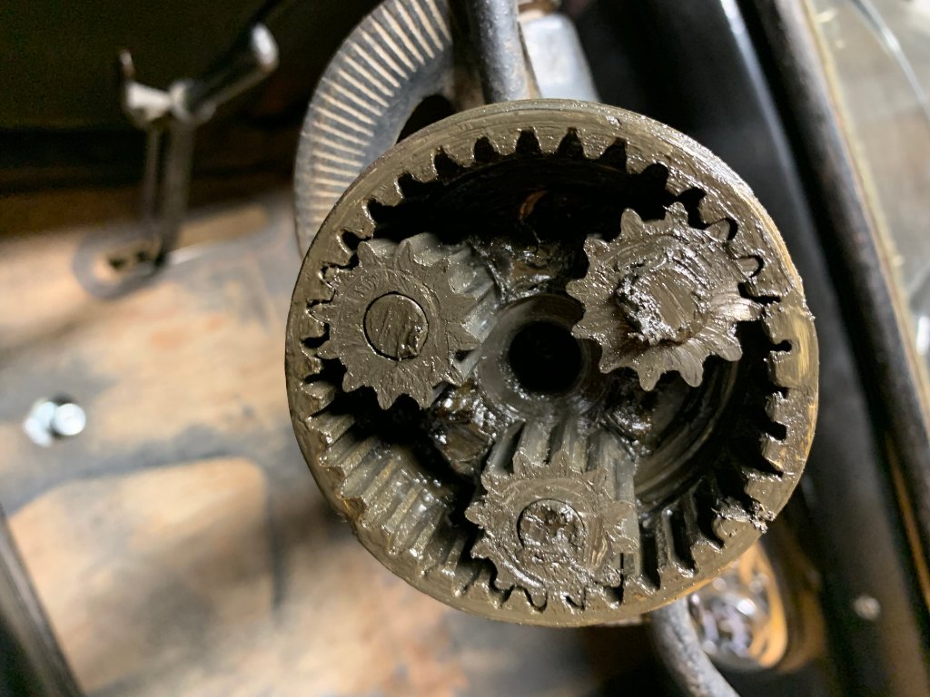

I’ll have to try to post pictures later, but I checked on it again tonight. It appears the threads on the gear cover and case are just worn out. If that little screw didn’t hold….I suppose the wheel would come right off? Is there any fix for this? I see new steering gear covers (3504B) are available, but what about the case?

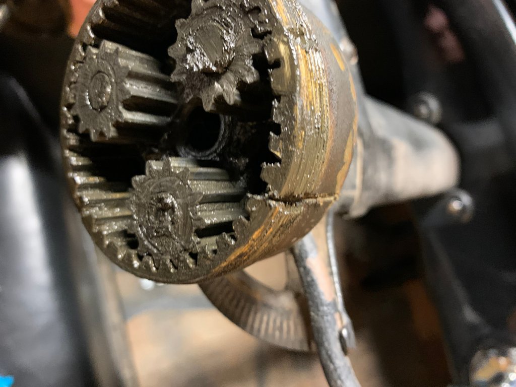

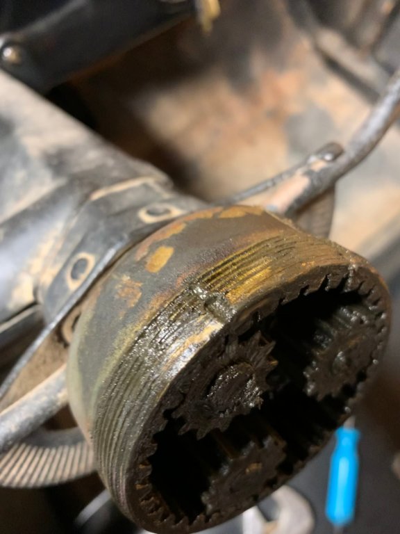

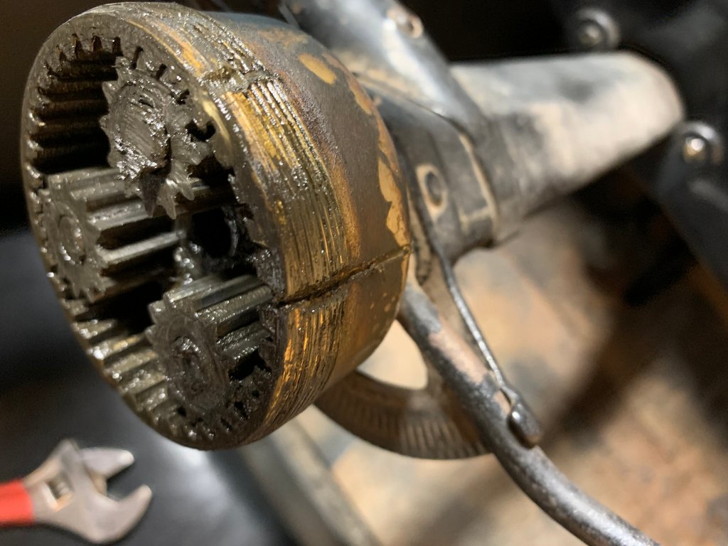

Post by CatGuy » Fri Dec 30, 2022 8:17 am

Post by Jerry VanOoteghem » Fri Dec 30, 2022 8:53 am
The bad news is that you need another steering gear case. Yours is badly split and somewhat dangerous as it might cause the steering to lock up on you. Others here might encourage you to repair it. My sincere hope is that you find a good used one. Do they make these new??

I wondered if I was seeing a split there. I might know of someone that has another one. It appears that the threads are so bad that the only thing holding it together is that little screw. :shock:

I would degrease , clean , and then braze that crack in the steering case. Reinstall regrease, put a new cover on that would compensate wear on the center gear that the steering wheel attaches. Replacing the case requires drilling out the old rivets and then installing the replacement case with new rivets. That would be the next step if you could find out who can do your rivet work

You're assuming he can't install two small rivets, but also assuming he can braze the case back together safely? That case is toast. The threads are shot to the point that the cover falls off without the retaining screw in place.

I would not even try to repair that steering box. It is very important for your safety to have a good one. I can't say why or how that happened, but you could lose all control of steering if you drive it that way. imagine going around a corner and not being able to straighten out.

Exactly, Jerry. I can push the cover on the case without threading it on. The threads are gone. The only thing that is holding the cover on is that screw!

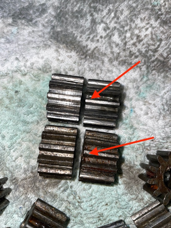

As noted in the previous replies, do get the proper '25-'27 steering case for your '27 with balloon tires, the ratio of the cluster gears will be the later 5:1 and that steering case to use is the one with the wider groove for the stop pinion.
And find a good used one with good gear teeth too, you can then use the reproduction 5:1 gear sets, and change out your pinion posts on the steering shaft too. Makes for proper repair to use good used parts or new parts.
late and early case with groove .jpg (43.29 KiB) Viewed 9466 times
Note the condition of used cluster gears, some are so worn out with sharp teeth, you can't have good steering.

As of noon today, we found out the threads on the case are shot. Pictures did not show that, and some had assumed that the grease on the threads was blocking the condition of the threads. Having something in front of us to observe in person is a lot better than unclear pictures and comments, pro or con.... Cat Guy., Keep us informed of your progress, 👍

I've been playing with T's for over 50 years and have never seen a more worn out steering box than this before. Why would anyone waste 10 seconds thinking about any sort of repair? It's a '26-'27 column (not 1909) and there has to be hundreds if not thousands of decent used ones around (I must have seen 30-40 at Hershey 2022 and I wasn't looking for one). As well, after seeing this totally worn out steering box still in use, a great big red flag would go up about the condition of the rest of the steering system along with all other mechanical components of this car. Model T steering is just one step above go-cart steering to begin with so don't take chances or settle for any quick patch-up fix. Sorry if I offended anyone but this is not something to take lightly as your life and the lives of others are at risk with this sort of stuff on the road. Good for you for questioning it and getting help.

I need to be educated here on what makes this one bad before I buy a ‘new’ one. I need to know what I’m looking for. I know that the steering wheel wobbles and the threads are bad, but beyond that what are other possible red flags?

Post by Scott Rosenthal » Sat Dec 31, 2022 9:10 am
No good reason to repair this very common, heavily damaged part.
I would expect this replacement part to cost approximately 75.00. Fair amount of work in changing this out, but no where near the work required for the earlier (2) piece style.
Scott
Posts: 8633
Re: Wiggly Steering Wheel
Post by TXGOAT2 » Sat Dec 31, 2022 9:16 am
The steering assembly you have shows clear evidence of extreme wear and abuse. The steering gear case is actually split apart. The condition of these parts may, or may not, reflect the condition of other mechanical parts of the car, but I would expect that it might, and I would inspect the entire chassis, engine, brakes, wheels, etc, before driving the car. You're dealing with a century old car. Some people will drive a car with steering issues until something breaks, while spending time and money on cosmetics or engine issues. Your car may be in good condition overall, but the steering box certainly isn't!
Posts: 4458
Post by Jerry VanOoteghem » Sat Dec 31, 2022 9:56 am
CatGuy wrote:
Sat Dec 31, 2022 7:59 am
Bruce Compton wrote:
Fri Dec 30, 2022 9:12 pm
I thought we've covered that fairly well... Cracked. Worn out threads. Unsafe. What else is left to say?

Nothing to be sorry about. The gears do appear to be fairly well worn also. At this point, every piece needs to be inspected for wear. Also, the 3 pins that the gears roll on. Are they tight in the steering shaft? What is the condition of the steering box cap? Are its threads also very worn? How well does the steering wheel shaft fit in the cap? If you end up buying 3 new gears, you should also buy a new steering wheel shaft.
First however, see what you can come up with as a replacement for your gearbox. Maybe you'll end up with a complete replacement column that will also address any other issues.

I would suspect that the pinion (the gear in the middle was being pushed very hard against the planetary gears(the three which rotate around it) into the ring gear (in the case) and pulling very hard on the steering wheel over the years caused the bronze to crack. The whole thing should be replaced with a better one. The big swap meet I was thinking about is in Chickasha Oklahoma in the spring. Someone who regularly attends it would know the date and location.
