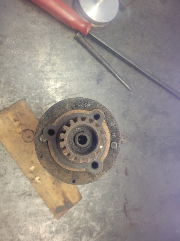

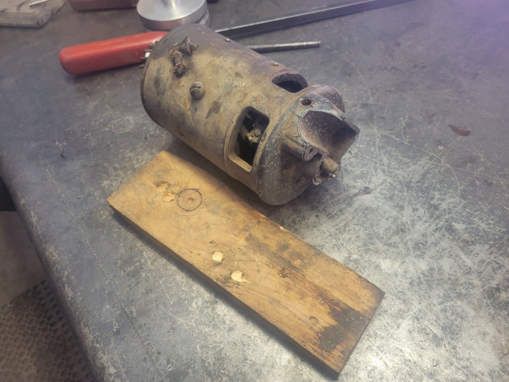

Found this in my junk. Someone put a T front cover on a Chevrolet generator. This got me thinking about a distributor on a T. Problem is a T engine crankshaft gear has a different tooth count on the crank gear VS the generator gear. This would have to be corrected on the distributor drive.

I have one with the disturbutor and have used it. Worked fine.

Looks an awful lot like ‘24ish Chevy…
