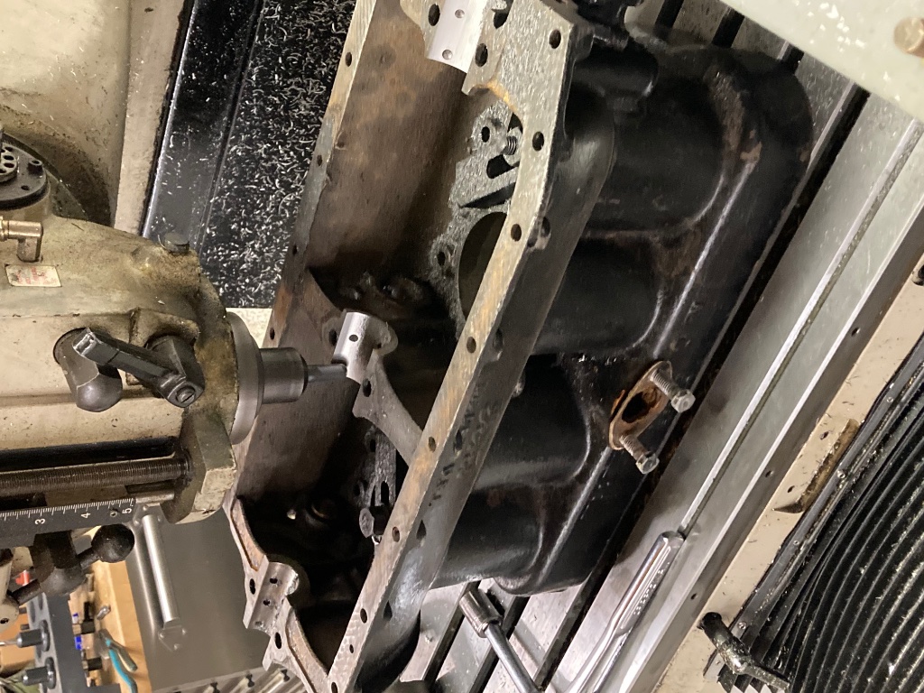

Modified Model A cranks are fairly common in T engines. 1-5/8” mains diameter and 1-1/2” rods. At this main diameter the babbit is extended right up to the main bolts, and so might be wise to bring the chebby crank to 1-5/8” mains at the largest. The stock Model A rods are a tight fit as well inside the block, but this could be due to the additional 1/4” stroke of the Model A crank.
The rod width issue could be resolved by screwing/welding thrust plates to the sides of the rods. But I’m sure there were plenty of ol timers that just ran em loose back in the day…
Here is a block being roughed out for an A crank with 1-5/8” journals

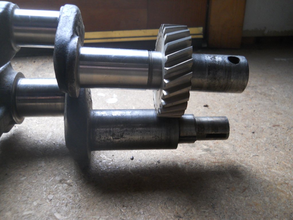

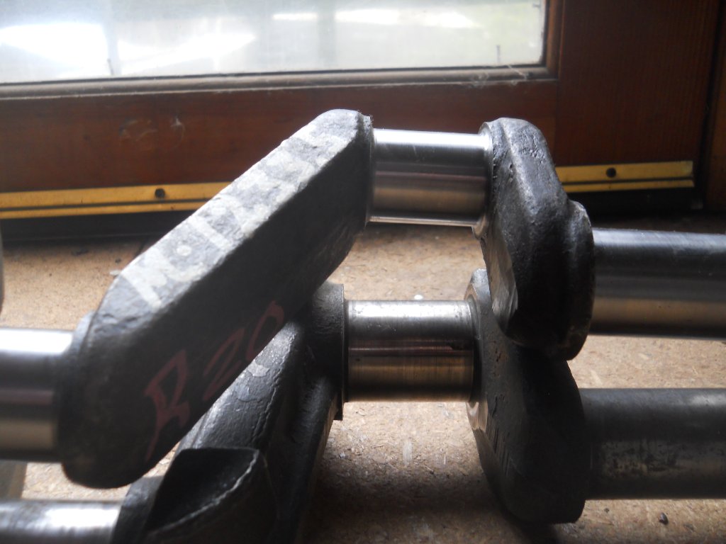

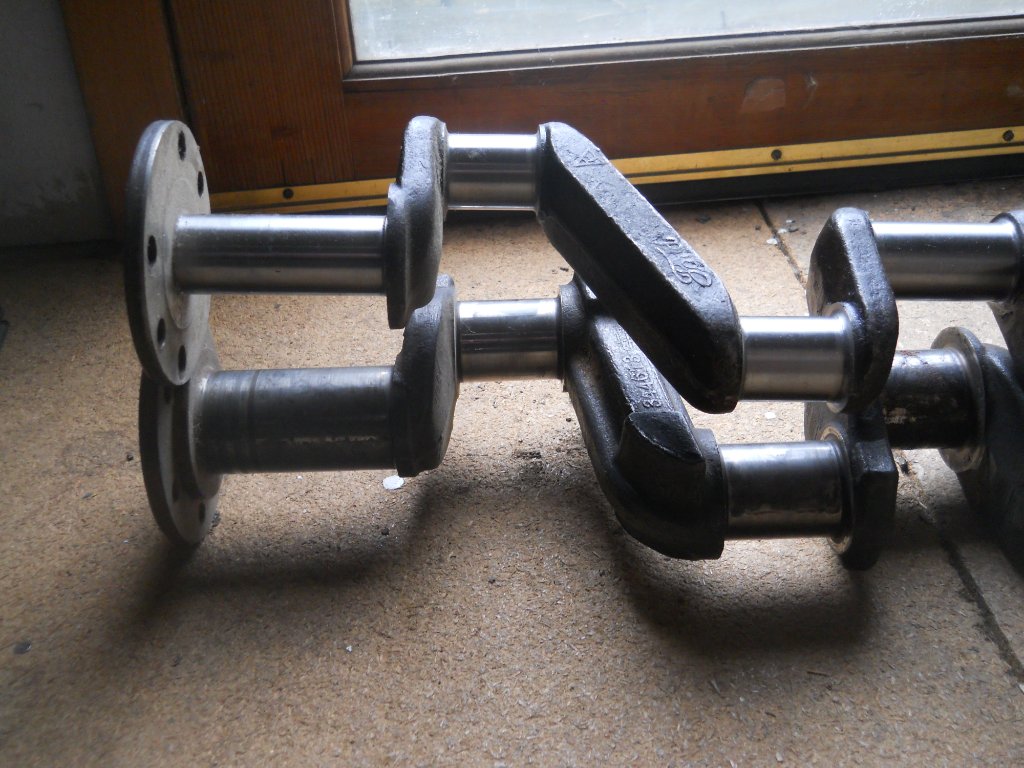

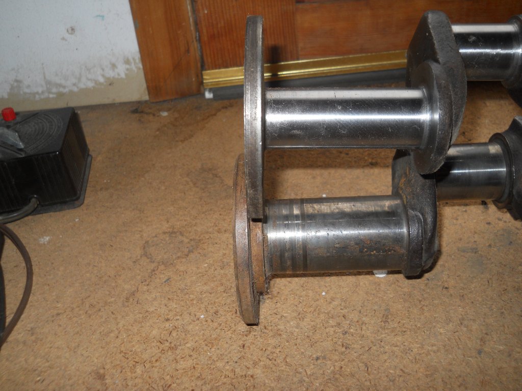

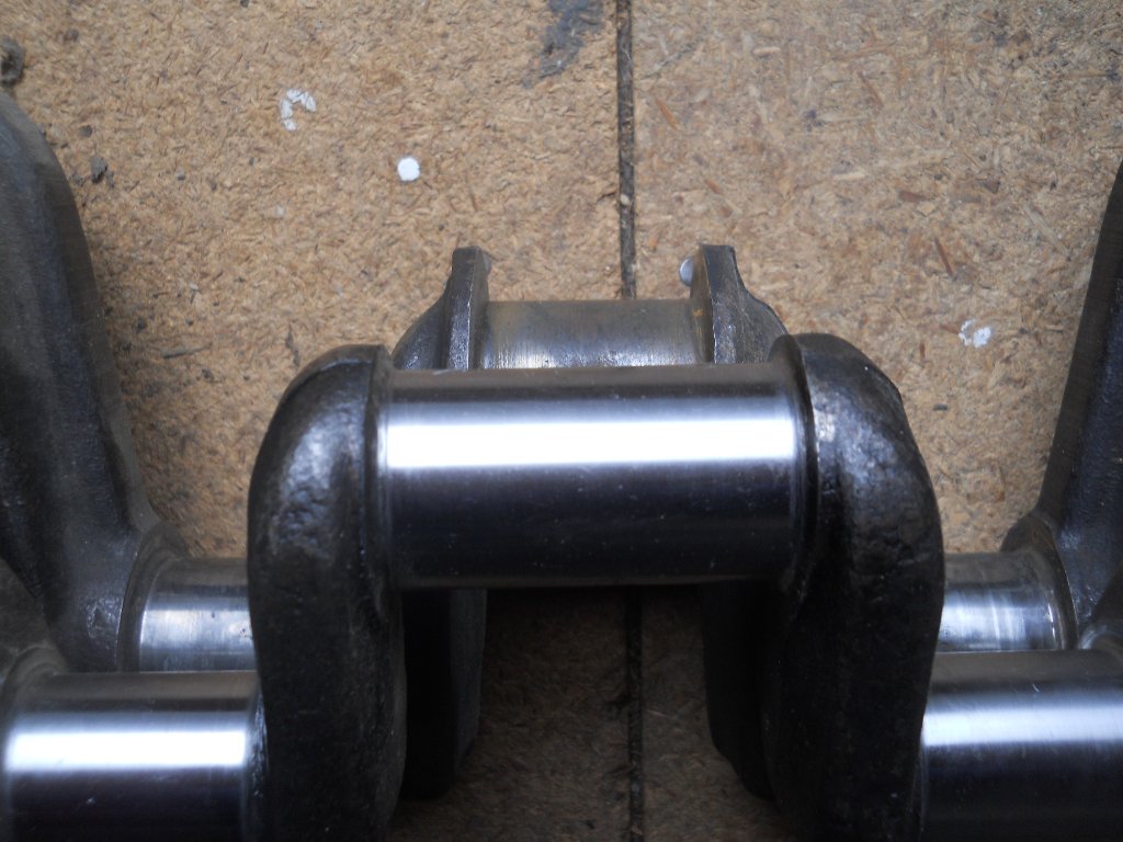

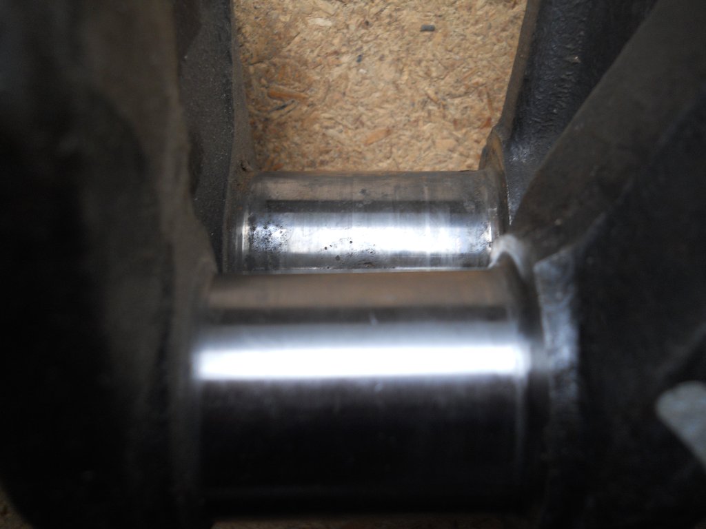

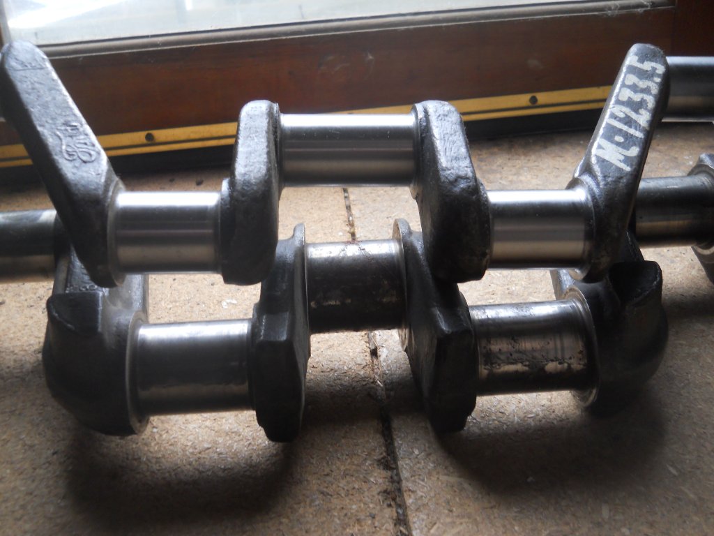

Took some photos of the T and Chevrolet crankshaft for comparison. Hope they show a little bit of the differences between the two.
- Posts: 5504
Re: Chevy crank into a T block
Couple more. While maybe not the best shots, the difference between the Ford center main and Chevrolet amount to quite a bit of the center saddle being cut away, especially in my opinion if you were going to use it for thrust. Note that in the photo of the flange, that to get things close to lining up, the flange on the Chevrolet would need to be moved. For the rods, looks to me like would either need to let them just float on the journal or would need to build up the thrust on one side only, something like, two to the front and two to the rear.
Anyway, for what it is worth, doing a quick look see, that is what I am seeing.
