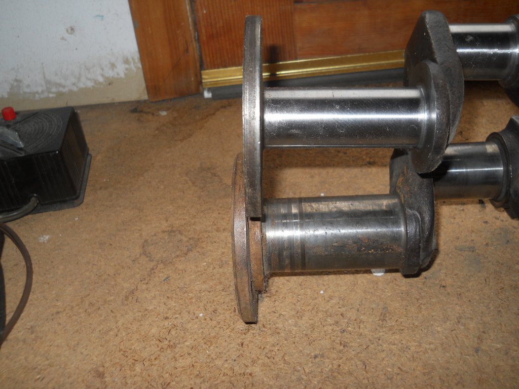

Took some photos of the T and Chevrolet crankshaft for comparison. Hope they show a little bit of the differences between the two.
- Posts: 5438
Re: Chevy crank into a T block
Couple more. While maybe not the best shots, the difference between the Ford center main and Chevrolet amount to quite a bit of the center saddle being cut away, especially in my opinion if you were going to use it for thrust. Note that in the photo of the flange, that to get things close to lining up, the flange on the Chevrolet would need to be moved. For the rods, looks to me like would either need to let them just float on the journal or would need to build up the thrust on one side only, something like, two to the front and two to the rear.
Anyway, for what it is worth, doing a quick look see, that is what I am seeing.
