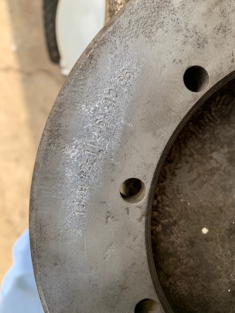

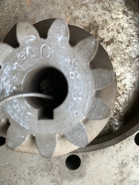

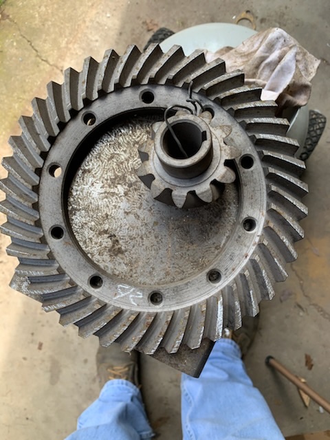

Anyone know what this ring gear and pinion fit.
11 tooth pinion 42 on ring gear. Shaft in pinion is tapered like a T. Looks to be same size as T. Any info would welcome. Thanks Dan

There is the possibility it is very early Model A before the changes to how the pinion was made and assembled. Not later V8/B enclosed driveshaft.
You might try posting it on AACA what is it section or over on Fordbarn.com in the Model A section.

Chevrolet used a ring & pinion very much like that. Have seen them sold as model T. And may be adaptable to model T?
Craig.

26-28 Chevrolet I believe.
