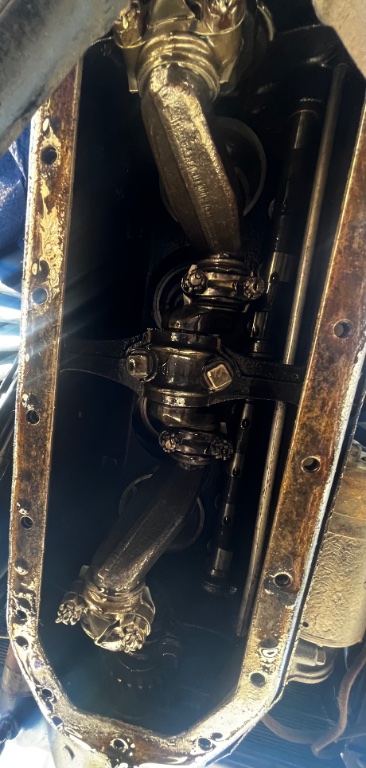

Also, it does leak a little from the inspection plate because it is somehow warped but it has not lost much oil. It still drips out of the top Petcock. I will be posting an ad in the classified section to look for a 1919-1925 HH. After that, I only need to find someone in town you can redo my spokes for me because I’m not sure I have the expertise and I do not have the right tools at the moment. I also need to find a TT rear hub puller.

Jacob - Sounds like you're well on your way to getting the TT on the road; congrats!
Also, a quick note on your oil level; If it' "drips" out of the top petcock with the rear wheels jacked up, you may have it a bit overfilled. Most recommend maintaining the oil level between the petcocks when checking on level ground. When adding oil, I'll typically open the top petcock and add slowly until it starts to drip. When it stops, I close the petcock and know that I'm at the right level. Using this method, when checking the level (without a sight gauge), open the lower petcock. If it runs out, you're fine. If it only drips a little, or doesn't drip at all, you know you're low on oil.

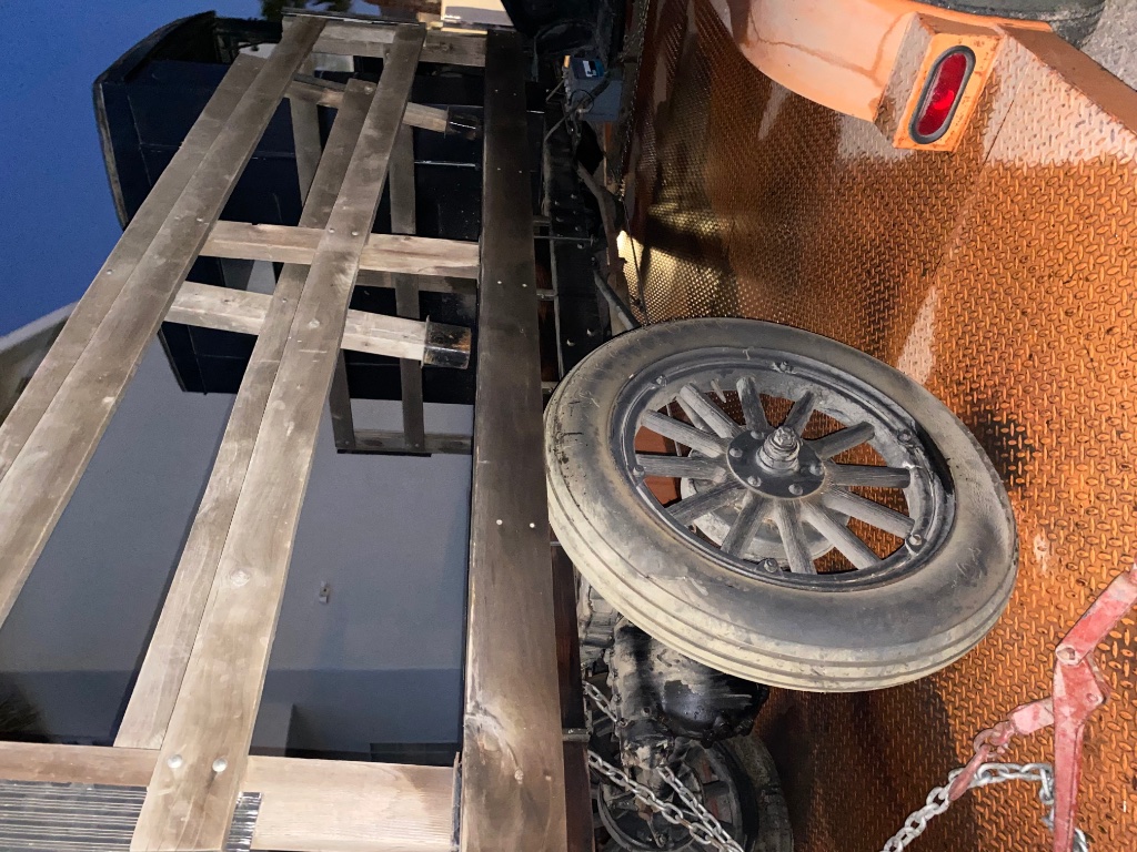

The spokes on the rear are the worst and 100 percent need to be replaced. The front ones aren’t as bad but still need some love.
Front Driver side
Front Passenger
Rear Drivers
Rear Passenger
Sorry about the pictures not being super good. They are the only ones I have on hand right now.

Jacob, are the spokes loose? Can you grab a spoke and move it or twist it? If not you may get by with cleaning them and scraping them to get the paint off. Treat them with boiled linseed oil until they won’t take anymore. Now a word of caution about being maimed or worse. The rear wheels may be the lock ring style, if so you must be very careful if you are considering taking them off. The lock rings can fly off once you try and pry the lock ring off to remove the wheel. People that are familiar with this type rim & are experienced in working with suicide rims will wrap chains over the wheel and through the spokes as a safety precaution if that tells you anything. People that know what they are but don’t want to take the chance may go to a knowledgeable tire dealer or truck stop and have them removed. They are dangerous disassembling & assembling. That said if you’re extremely lucky you may have rare TT rear wheel split rims. I could not tell looking at the pictures but before you proceed take better pictures and get feed back from more seasoned TT folks. Not trying to scare you, just trying to prepare you before you do anything with the rear wheels. Best John

Those rear wheels are 32 x 4 & 1/2 not lock ring type.

Even if they are lockring type, that has no bearing on removing the wheel. The need for care comes when demounting the tyre, not the wheel.Or am I missing something?

The front ones are not that wobbly at all so I will probably be able to get by with the linseed method. It is a different story for the rear wheel’s though. The rear end has play about 5 inches both ways when I push and pull it. Also, one of the spokes on the driver rear wheel has separated completely from its tenon from its fellow in the rim.

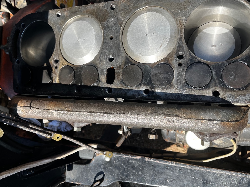

your engine most certainly was rebuilt at some time since you have modern valves and very clean looking oversize aluminum pistons.

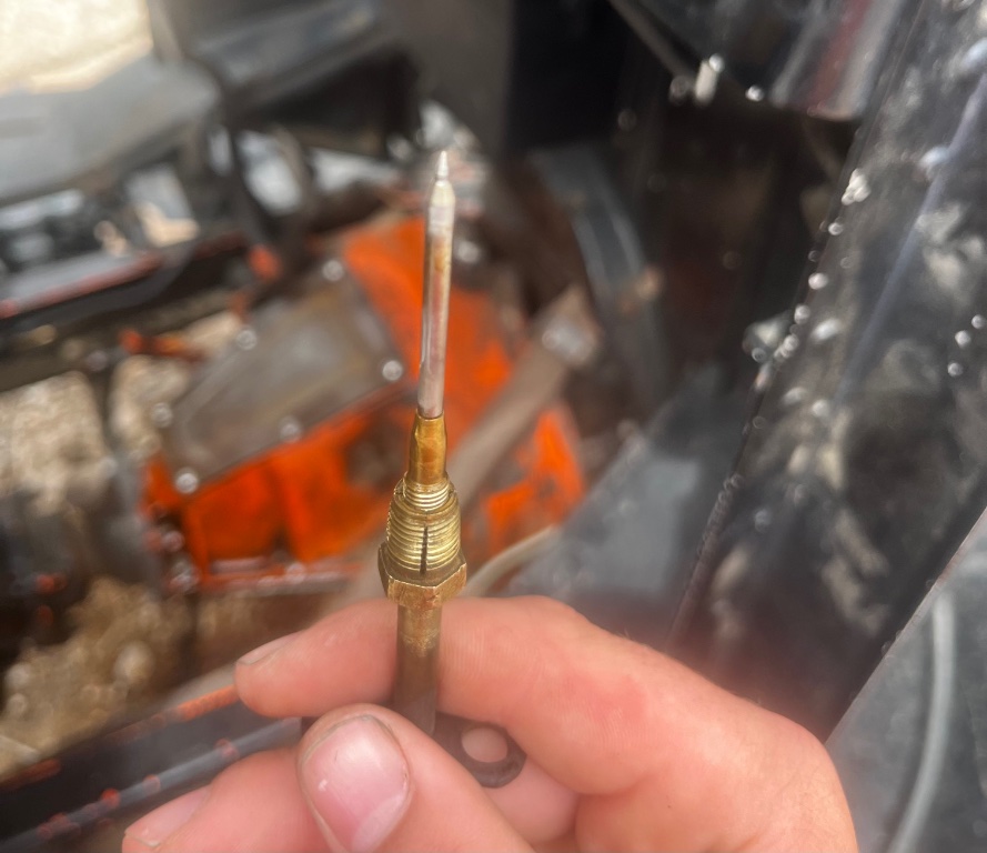

This is just a little update about my TT Truck. Yesterday finalised my carburettor idle settings and air fuel mixture. It ran best with the needle 3 full turns off the seat.
If your carb is a holly NH, your setting of 3 turns open points to a problem in that carb.
Read the service manual on carb overhauls. The initial carb setting is 1 & 1/4 open. This should be on the rich side, but will allow an easy start.
when warm, the needle is fine tuned leaner. (< 1 1/4 turns.) 3 turns would be extremely rich to the point of very poor running.
This could indicate a manifold vacuum leak or a maladjustment such as a very low fuel level, maybe a plugged idle circuit.
Something is amiss here.

I rebuilt the carburetor completely with 100% new gaskets. When I run it next, I’ll try it again and see where it runs best.

I recall that you mentioned that the car ran when the needle was unscrewed 3 turns. That is far too much and indicates other troubles. Without going into a "how to" tutorial for a rebuild, let me suggest that you review this video by a fellow Forum Member: https://www.youtube.com/watch?v=uTiStUTU9IE and see if your needle doesn't have some form of wear or distortion on the tip. If it does, then follow Steve's advice and rework it, reinstall it and see if you can't get the truck to run/idle a little better with a lot less unscrewing of the adjustment.

Well that was the issue.
Posts: 6710
Re: One Step Closer to Getting Her on the Road
Post by Scott_Conger » Thu May 04, 2023 9:25 pm
And now you know what you need to do!
use care to put a perfectly STRAIGHT taper back on the needle, and also use care to ensure that your jig will impart the EXACT same fine taper or at least a close facimile of it...if you must err, err to the side of a finer taper but never a stubbier one.
A proper taper that is perfectly straight and not barrel-shaped will give you a pretty good range of adjustment. If the taper is too short/quick, you will go from rich, to lean and back to rich with the mere's "tweek" of the needle and you don't want that.

Does anyone know the approximate angle I should make the jig. It looks anywhere from 15-20 degrees.
Posts: 7393
Post by Steve Jelf » Fri May 05, 2023 9:58 am
I didn't measure the angle. I just laid a ruler on the block, aligned it with the needle point, and marked a line. I think I may have used a 2 x 4 long enough for me to clamp it on a bench while I cut the block, but that was eleven years ago and I have trouble remembering what I did yesterday. :)

Be warned: Do not remove too much material.
The needle can be over cut or re shaped too much(to short) to where the needle will feel seated,

I’ve been getting a lot of things done on the truck because I signed up for my first car show with my T club at the beginning of October.
Anyways, I shipped my bands off to Mr. Guinn to get his wood lining put on my bands. I did my research and came to the conclusion that wood linings would be the best option for me. I took off the Hogshead to take my bands off so I could also clean out the oil line and also cleaned out all of the accumulated lint from my first drive. The transmission looks really good and the magneto looks like it should work. Hopefully when I reinstate everything, the mag will work.
I also sealed the toolbox and bolted it down to my bed. Now I just have to make new sides for it.
I also was able to save my spokes with a bit of 30 year old boiled linseed oil and some black wood stain. The wheels are nice and tight now and look amazing too.
I also got bored and decided to look at my crank and rods and was greeted with some very nice surprises. To start, I found dippers connected to the ends of my rods. I also found no unusual signs of wear or anything getting hot. Also, all my bearings, rods, and caps look to have been rebabitted. The rods also had absolutely no up and down play, either. The oil line was very straight and looked to be replaced at some point. The camshaft also seemed to be a regrind, as well. Nothing but good news came from looking in my pan. When I install the new bands, I will also be putting on the correct Hogshead but that is all I’ve got for now.
Thanks, Jacob Mangold

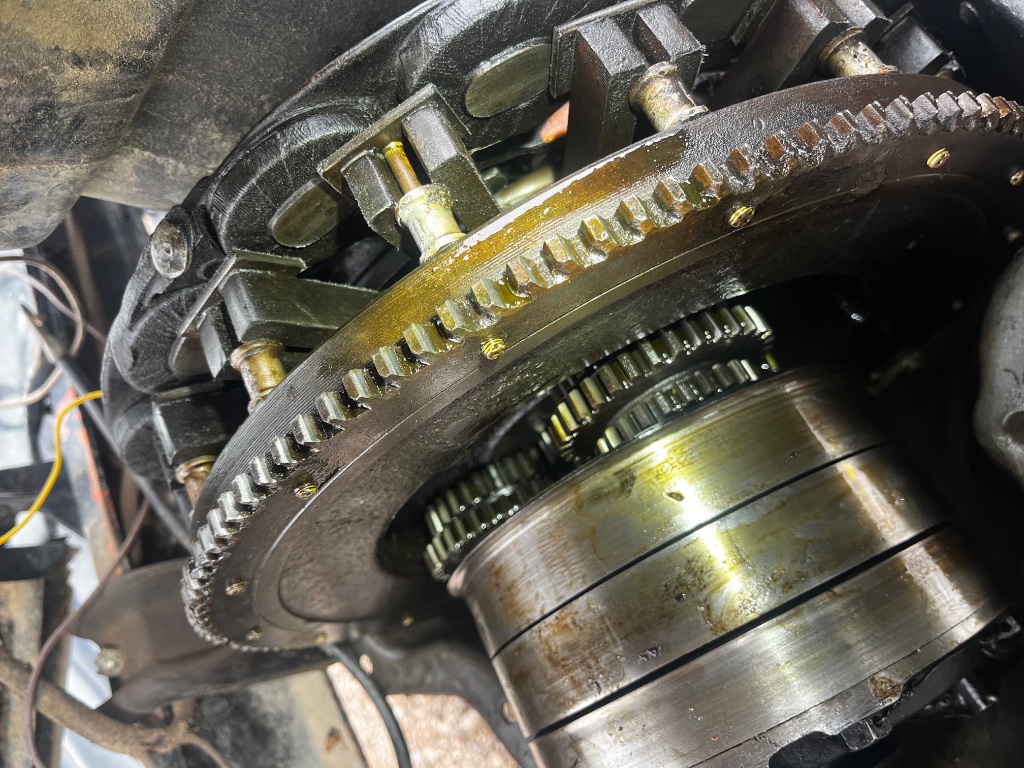

Did a band change yesterday as well as put the correct Hogshead on the early transmission. Decided to go with wood bands from Jim Guinn. Sent them in and he got them perfectly round and put his wood linings on. So far, I’ve only driven it in my backyard but it feels real good. There doesn’t seem to be much chatter at all. I also think I did a better job at sealing the gaskets with ultra black because it doesn’t puke oil like before. The whole process of reinstalling the Hogshead was a lot easier this time too. I also routed a brand new copper outside oil line. Unfortunately, there’s always bad news with good news. I tested out the brand new mag post. When I turn it to mag, there wasn’t as much as a stutter. Might as well have turned it to the off position. Seems kind of disappointing. My mag looks fine visually. Does it just need to be recharged? I know it at least makes a little power because I tested it with one of those outlet testing wands and it makes it beep. Tomorrow, I will add a video to my YouTube showing how it sounds when I try to flip it to mag.
Posts: 7393
Post by Steve Jelf » Tue Jul 11, 2023 9:50 am
Very unlikely. It may be weak and need a recharge, but that's not a reason for it to suddenly go too weak to run the engine. If I installed a new mag post and the mag output was suddenly weak, I would start there. Did the engine run OK with the old post? If so, put it back in. If that fixes your mag, there's your answer.

The mag never ran since I have had the truck. I thought that maybe since I snapped off the other one, that’s why it would not work but that is obviously not the case. It is evident that my magneto was rebuilt at some point though because I also inherited the KR Wilson magneto spacing tool from my great grandfather. :lol: When my TT was restored in the 80’s, virtually everything was went through. I will do more testing today.

Post by BUSHMIKE » Tue Jul 11, 2023 11:00 am
Check for continuity on the mag switch terminal.

Jacob ideally when you had the hogshead off you could have checked the gap on almost half the field coil & magnet keepers but that’s water under the bridge right now. BushMike made a good suggestion that might solve the problem. Really am enjoying your enthusiasm and work you’re doing. Very nice work on your truckbed.

Thank you for your complements. I did inspect the mag visually when the HH was off. The gap seemed consistent all the way around. No wobble in it. The field coils also were in good condition too. No tears or visible damage on the ones I could see. The magnets seemed a bit week though. They still would grab and hold a steel screwdriver but barely. I’m thinking my magnets need a recharge. Will post what I find when I test it later today.

Jacob the gap should be between .025-40 thou. You can buy an inexpensive set of brass feeler gauges, to use in checking the next time you have the hogshead off or pull the engine, off Tbay.

I think it would be ok to use some heavy 2/0 gauge wire and tap the soldered button, right. I’ll just strip the end in order to not short it on the Hogshead.

Jacob, if you do an in-truck magnet recharge, you want a solid connection where the mag post touches the ring. Do your tapping elsewhere (and away from the gas tank). That process will be more forgiving of where to tap.

I didn't realize this was an ongoing problem, not a sudden one. In that case, yes a recharge of weak magnets might be just the thing. Another possible cause of a weak magneto is too big a gap between the magnets and the coil ring, caused by excessive crankshaft end play. Check for that with gentle prying back and forth at the fan drive pulley.
The best magnet charge is done one at a time, off the flywheel. Done that way the magnets should hold at least two pounds, but I like to get them up to 4 - 4½ pounds. While an in-car charge is not as strong, it will make the magneto strong enough to run the car/truck.

Sounds like your dash switch is not making contact when you switch to magneto... Since you say you have power coming off the magneto post.

Robert, the mag post is not working. I tested it with a light tester and no dice.

Post by Moxie26 » Tue Jul 11, 2023 7:22 pm
Wouldn't hurt to replace the magneto post.
Jacob Mangold
Posts: 207
Joined: Sun Feb 26, 2023 2:57 pm
First Name: Jacob
Last Name: Mangold
* REQUIRED* Type and Year of Model Ts owned: 1926 TT, 1924 TT, 1928 A Coupe, 1976 Firebird Trans Am
Location: Henderson, Nevada
Post by Jacob Mangold » Tue Jul 11, 2023 8:46 pm
It is brand new. Just got it from snyders
Moxie26
Posts: 2037
Last Name: Jablonski
Location: New Jersey
Post by Moxie26 » Tue Jul 11, 2023 8:47 pm
Magneto then needs to be recharged

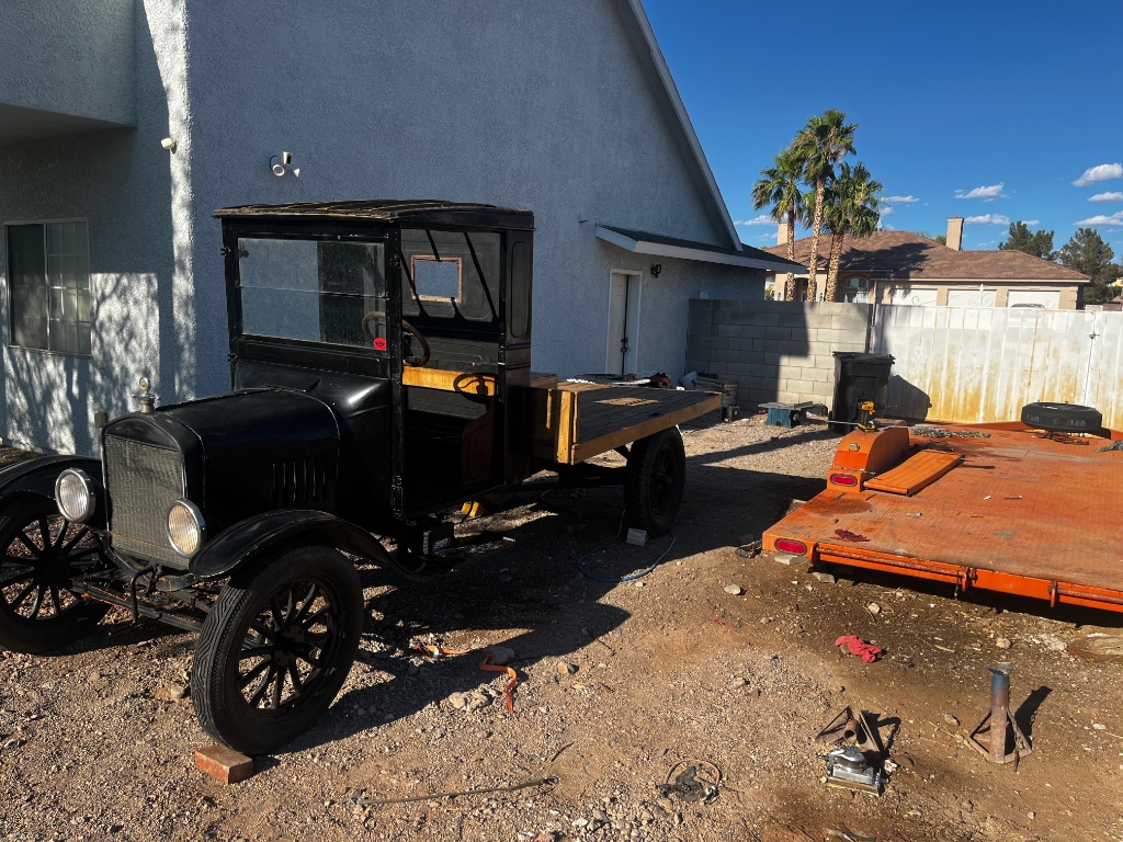

Post by Jacob Mangold » Wed Jul 12, 2023 9:06 pm
I installed the bed today!
