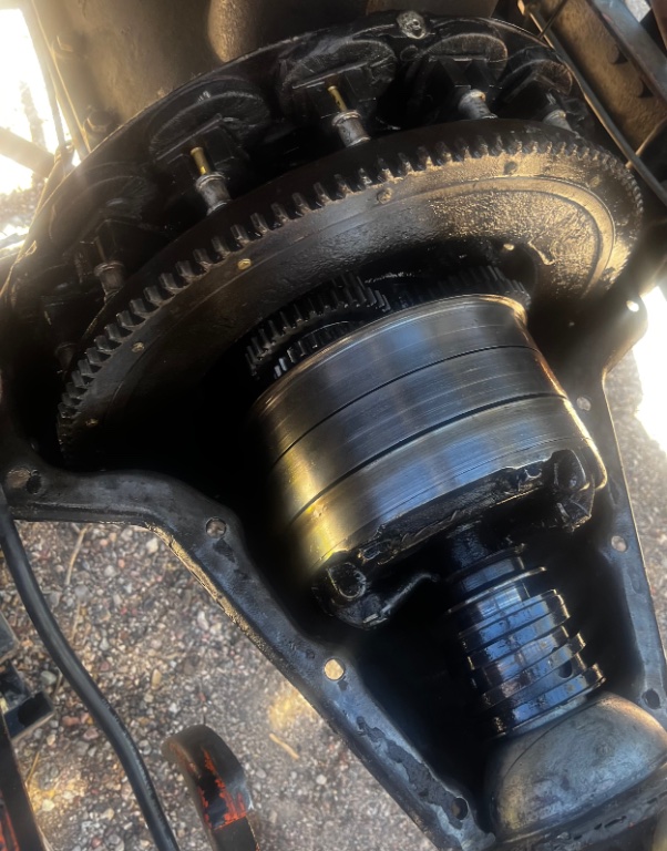

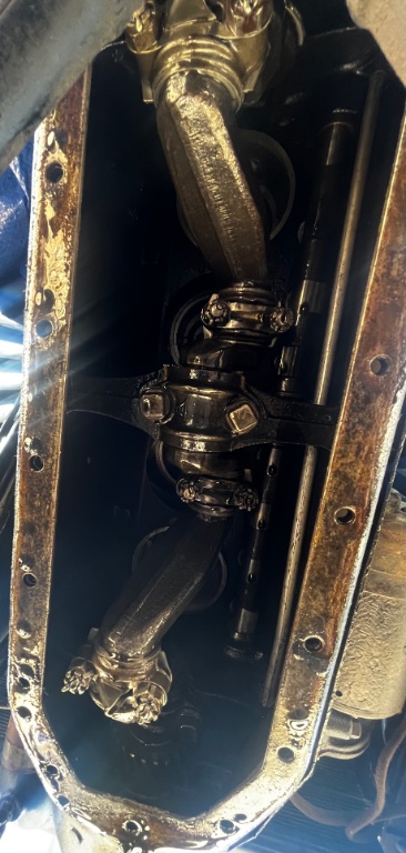

Congrats Jacob! Post some good pics of the engine and details. These guys can give a lot of really good advice based on looking at pics.

Well, I just found something out that makes everything make sense. I don’t have a 1924 TT, I have a 1926 TT. So somewhere along the line, the engine must have blown and was replaced with a 1923 block. This explains why I have a 4 dip pan and 26-27 HH. This is not a bad thing though because it means I most likely have good Babbitt and that my mag is probably good. This truck only gets more interesting every day. :lol:
Jacob Mangold
Posts: 232
Joined: Sun Feb 26, 2023 2:57 pm
First Name: Jacob
Last Name: Mangold
* REQUIRED* Type and Year of Model Ts owned: 1926 TT, 1924 TT, 1928 A Coupe
Location: Henderson, Nevada
Board Member Since: 2023
Re: One Step Closer to Getting Her on the Road
Post by Jacob Mangold » Wed May 03, 2023 10:58 am
Figured this out when I was on langs and I was looking for ignition plate screws and I say a 26-27 ignition plate and it looked like mine. I then did more digging and figured it out.

Thanks, Jacob Mangold

Did a band change yesterday as well as put the correct Hogshead on the early transmission. Decided to go with wood bands from Jim Guinn. Sent them in and he got them perfectly round and put his wood linings on. So far, I’ve only driven it in my backyard but it feels real good. There doesn’t seem to be much chatter at all. I also think I did a better job at sealing the gaskets with ultra black because it doesn’t puke oil like before. The whole process of reinstalling the Hogshead was a lot easier this time too. I also routed a brand new copper outside oil line. Unfortunately, there’s always bad news with good news. I tested out the brand new mag post. When I turn it to mag, there wasn’t as much as a stutter. Might as well have turned it to the off position. Seems kind of disappointing. My mag looks fine visually. Does it just need to be recharged? I know it at least makes a little power because I tested it with one of those outlet testing wands and it makes it beep. Tomorrow, I will add a video to my YouTube showing how it sounds when I try to flip it to mag.
Posts: 7411
Post by Steve Jelf » Tue Jul 11, 2023 9:50 am
Very unlikely. It may be weak and need a recharge, but that's not a reason for it to suddenly go too weak to run the engine. If I installed a new mag post and the mag output was suddenly weak, I would start there. Did the engine run OK with the old post? If so, put it back in. If that fixes your mag, there's your answer.
