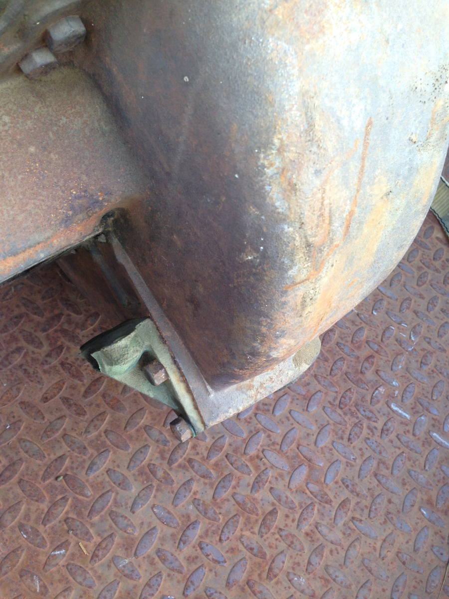

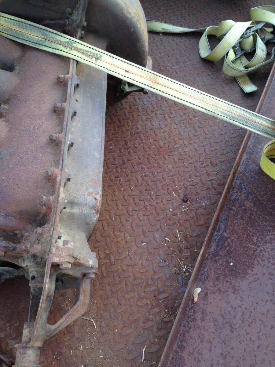

Here's a couple pan pics. The inspection cover is with it, and at first glance it looks to be a standard 4 dip cover. Note that the wishbone ball joint sits on top of the bracket instead of below it.
