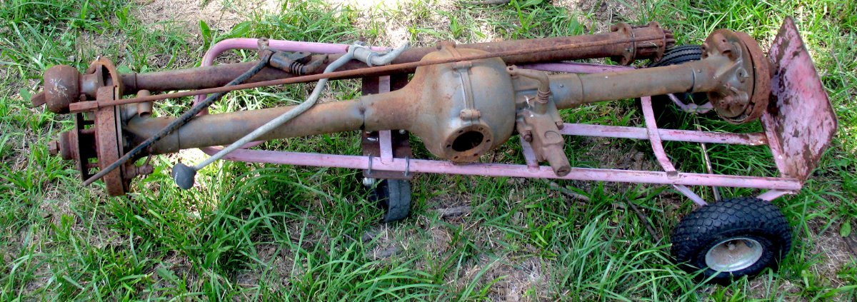

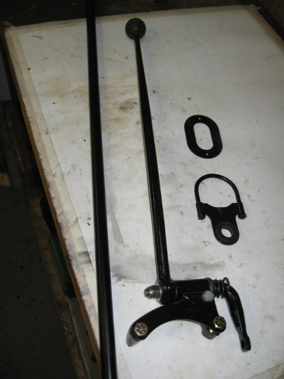

Yesterday I drove over to Pittsburg (almost Missouri) and fetched home a Ruckstell. The $700 I paid for it was a swell bargain or foolish overspending, depending on what I find inside.
This one came with two shift levers, one straight and one offset. The chap who sold me the Ruckstell wasn't sure, but I assume the 47½" rod with turnbuckle is part of the linkage. Or is it something unrelated?

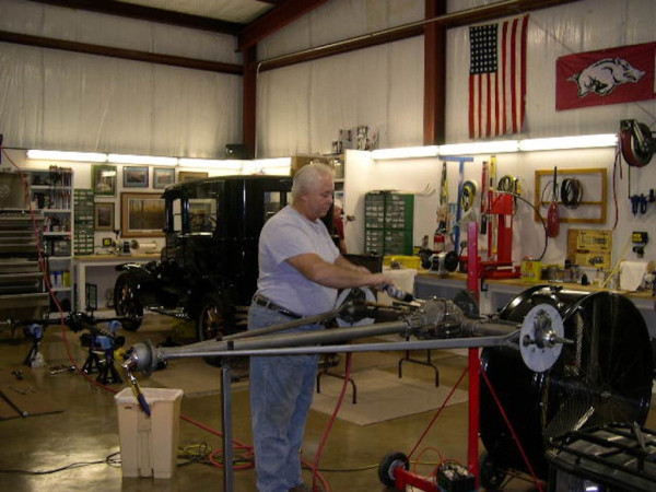

Seeing my mention of this on my blog, Mark Strange kindly forwarded some Ruckstell tips from Stan Howe, along with a photo of Stan in Ruckstell rebuilding mode.

Looks like you made a deal. I picked up a Ruckstell for $350 all I got was a usable Ruckstell housing, good inards, 2 axles & a broken early shift
lock no shifter With some trading I was into a complete for $500+ I concider that a winner. You have a late shift lock, two shifters good looking
housing & linkage. You may not be as lucky as me but I dought it's a foolish buy. Good luck let us know how it comes out.

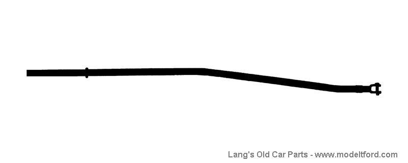

You might be able to make the long steel rod work as a shift rod, but the original rod (and the ones the vendors currently sell) are made of hollow tubing and have a strategically placed kink near the middle, see pic. There should also be a tube guide that fits over the middle of the rod and clamps to the driveshaft tube, it keeps the rod from buckling under compression.

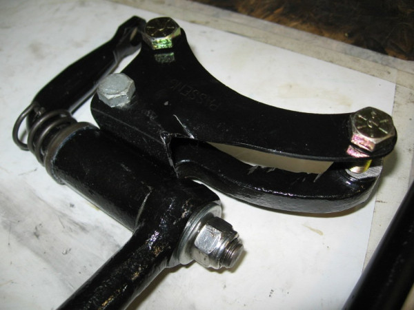

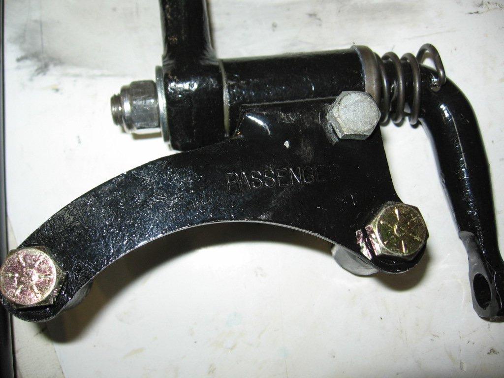

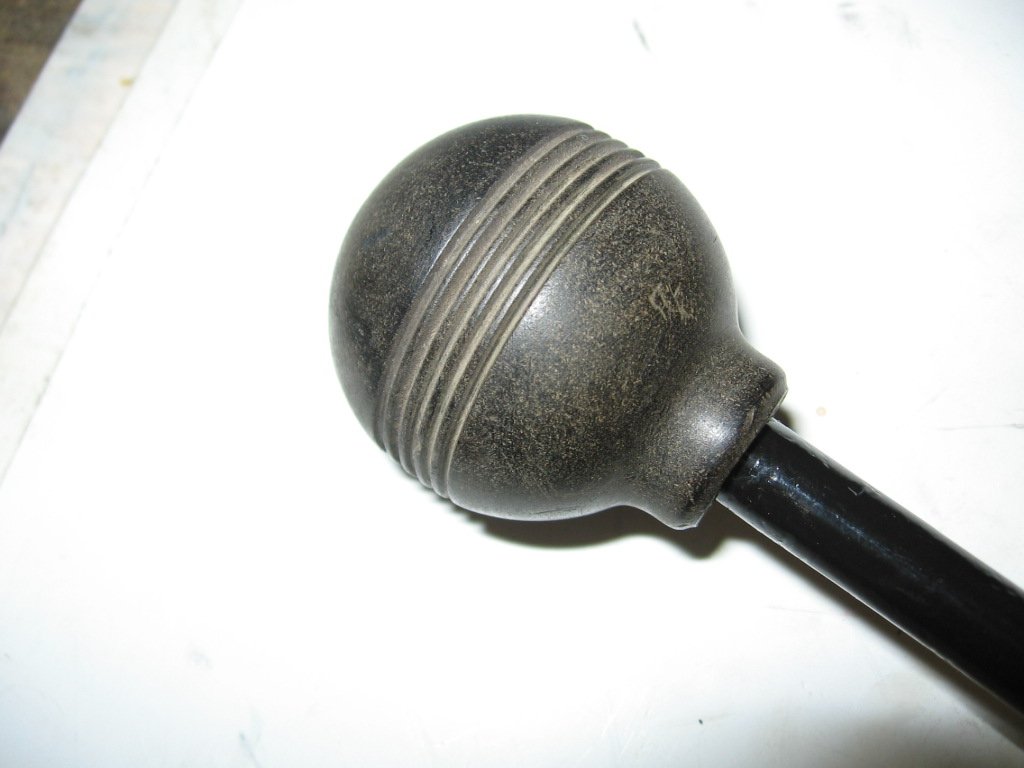

Some Ruckstell shifters came with a metal plate that helped to reinforce the casting, see attached pic. Also see a pic of the original style shift knob. I chose to drill my shifter pivot casting for a zerk fitting to help keep it lubricated.

Have fun! I have Ruckstells in all of my T's. Don't use that plate for the shift lever. They never had such a thing, plus you don't need a hole that size for it. I hope you find the components to be in good shape.
