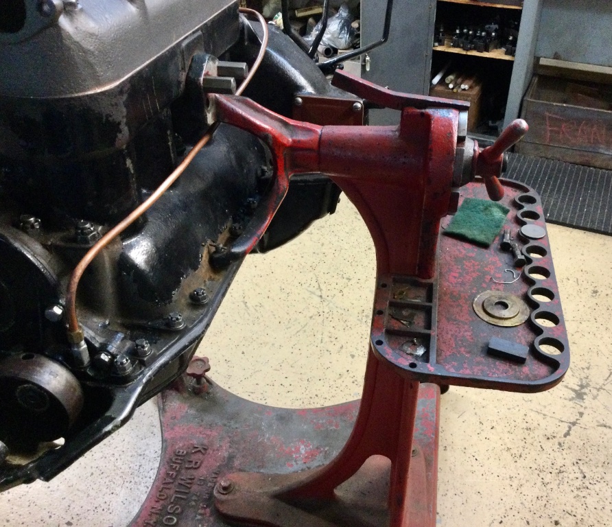

My personal favorite is the KR Wilson engine stand on a roller base.
The advantages I see in his stand is that there is very little flex of the stand with the motor on it. More modern stands made from welded square tubing always have some movement when holding a heavy Model T motor assembly.
Another advantage is the motor can be rotated to almost any position, making it pretty easy to,work on different parts during assembly/disassembly.
On the roller base, it is pretty easy for me to move the stand with the engine mounted around my shop.
Of course the KR Wilson stands are not cheap or easy to come by, a definite disadvantage.

- Posts: 6579
Re: Engine Stand help
There is no bracing in the rear around the transmission other than on the bottom. Wheels make it easy to move around if you don;'t have a large work area

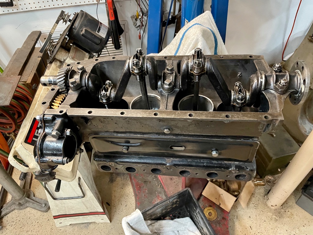

Here is a picture of an engine on my stand. The stand I built in high school as a shop class project. The plate is the one that the vendors sell.

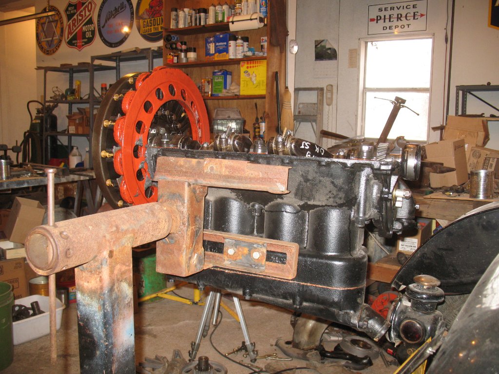

Hi Edwin,
This is what I came up with from a $25 swapmeet find some flat iron & some bolts. The flat slots make it eazy to from engine to engine & trans
to keep it balanced. It is tight geting to the main bolts. I also made a fixture to hold a rear end in the stand with 2 exhaust clamps.
Craig.

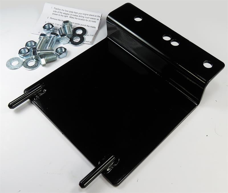

If I did not have a stand like Trent, I'd use a standard engine stand with this adapter: https://www.modeltford.com/item/6005-ADP.aspx it is the gold standard of adapters...
this plate that most folks buy, that bolts onto a stand is OK but not the greatest unless $$ are a concern, and I do not discount that being a factor for many folks
