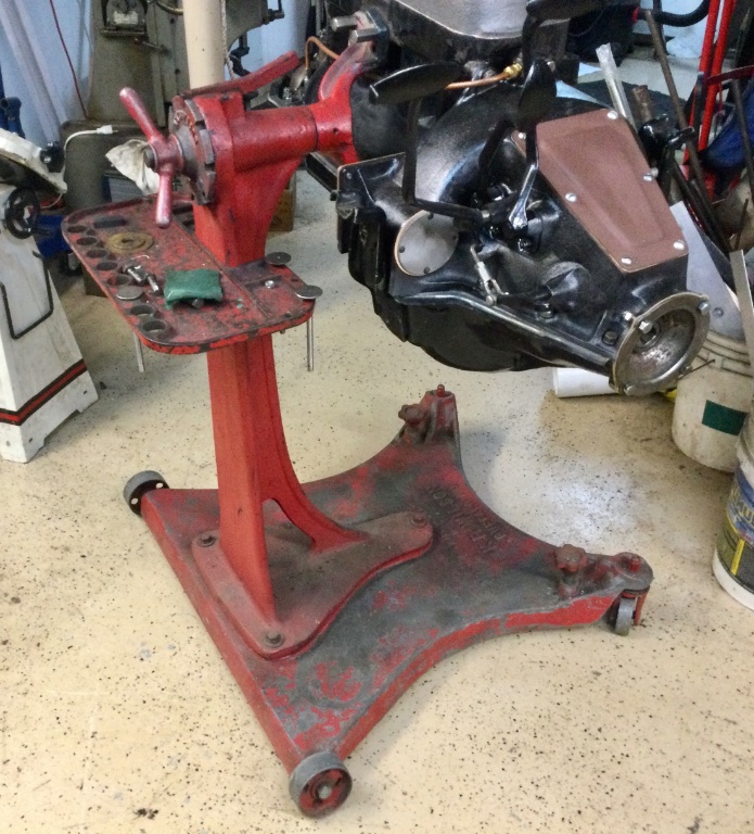

Scott C.
Posts: 863
Last Name: Clements
Location: Waynetown Indiana
Re: Engine Stand help
Post by Scott C. » Wed Jul 05, 2023 12:59 pm
Here is a picture of an engine on my stand. The stand I built in high school as a shop class project. The plate is the one that the vendors sell.

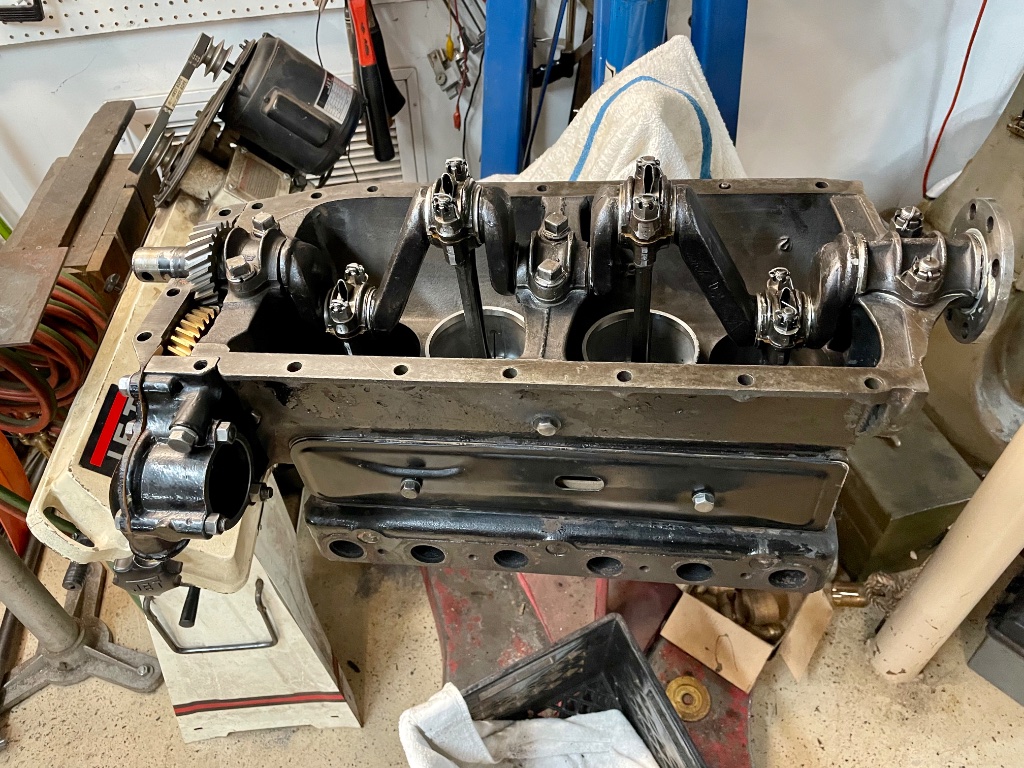

varmint
Posts: 1040
First Name: Vernon
Last Name: Worley
Location: New Orleans, LA
Post by varmint » Wed Jul 05, 2023 1:01 pm
Per instructions, I made a set of these in April.
3/8"
engine stand bolts.jpg (82.41 KiB) Viewed 2325 times

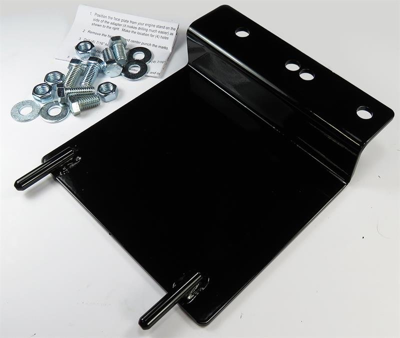

If I did not have a stand like Trent, I'd use a standard engine stand with this adapter: https://www.modeltford.com/item/6005-ADP.aspx it is the gold standard of adapters...
this plate that most folks buy, that bolts onto a stand is OK but not the greatest unless $$ are a concern, and I do not discount that being a factor for many folks

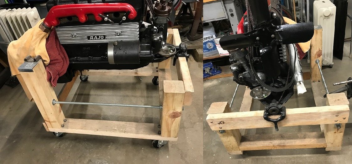

Flyingpiper59
Posts: 140
Joined: Wed Jul 20, 2022 6:02 pm
First Name: Edwin
Last Name: Douglas
* REQUIRED* Type and Year of Model Ts owned: 27 Tudor
Location: Millport, PA
Post by Flyingpiper59 » Sat Jul 08, 2023 9:27 am
Thanks all….. I now I have some ideas for fabricating a mount for my stand!
Cheers!
