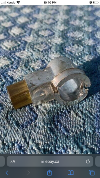

Got my new timer brush today and taking a quick look at it my car does not appear to have any key way or slot to make the brush point a certain way. Am I missing something or do they just point wherever? Should I find tdc and point it to that?
Posts: 6559
Re: Timer brush help
Post by Scott_Conger » Mon Aug 07, 2023 9:25 pm
looks like it has a keyway to me
take the old brush out and you'll see exactly how it goes
I hope you have a timer which actually uses that brush

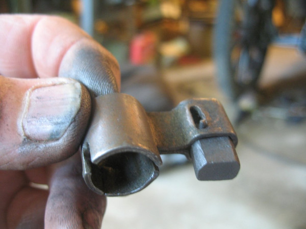

Post by Steve Jelf » Mon Aug 07, 2023 10:44 pm
The brush should have a notch, or slot, like this New Day brush. That goes over the hole in the shaft, and a small pin like a little nail goes in the hole to hold it there. A retainer to hold the pin in place is held by the nut on the end of the shaft. If your shaft has a hole all the way through it, you can easily install the brush 180º off.

Hi thanks there is no pin there anymore and no old roller. Seems to have the right cap by looking at it. Ill find a roll pin tomorrow hopefully I will have it running soon. Thanks again for the replies

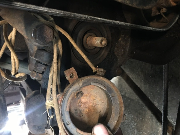

Please show a picture of the timer itself.
Post by Paradise Garage » Tue Aug 08, 2023 8:08 am
Pic of timer. Yes using a ford timer just replacing it to a brush cause that’s what I had

Post by Mark Nunn » Tue Aug 08, 2023 8:27 am
Robert, that timer housing needs a roller, not a brush.
My mistake. I was looking at the photo that Steve Jelf posted. I have a Tiger timer but have never seen a brush for it. I have a roller.

Post by RajoRacer » Tue Aug 08, 2023 9:27 am
That is an era "accessory" brush that will work with the timer pictured - notice the curvature of the brush - the timer appears to be a "Tiger" accessory commutator.

Post by Steve Jelf » Tue Aug 08, 2023 10:12 am
If that Tiger is as rusty as it looks in the picture I would derust it, paint the outside, and clean the inside thoroughly. Ideally it would be turned in a lathe to make a perfectly smooth path for the brush. Google Tiger Model T timer for previous forum discussions.

Post by Moxie26 » Tue Aug 08, 2023 10:17 am
Hand Crank the engine over one half to one turn, and you may find the hole in the camshaft to put that retaining pin to hold your brush along with a cap and nut that goes to secure.

Post by Paradise Garage » Tue Aug 08, 2023 1:15 pm
Thanks I got it all geared up. I cleaned up the cap the best I could it doesn’t look too awful where the brush tracks so hopefully it will work good enough. My radiator should be back this week so I am looking foreword to taking it for its first drive in 70+ years

Post by Jerry VanOoteghem » Tue Aug 08, 2023 2:52 pm
PLEASE, double check your timing if you use that accessory brush! Many accessory timers or timer parts require different timing adjustments than the standard Ford ones.
