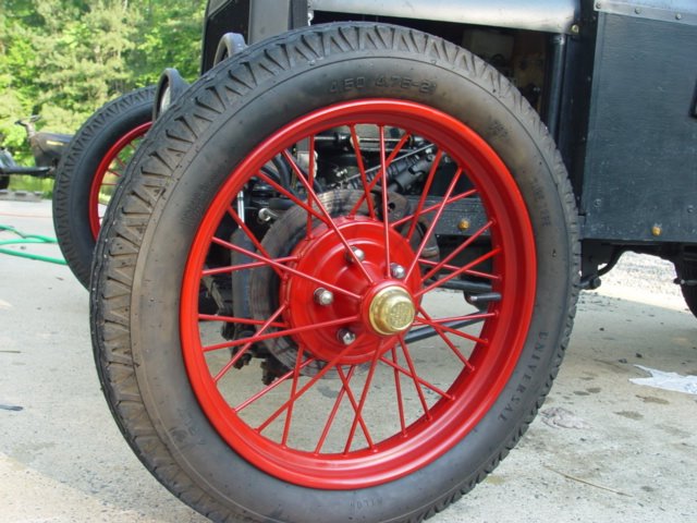

My speedster is lightweight and has a hard ride, bumps in the road can effect handling at higher speeds. The tires are Universal with balance beads and I had them filled to 45 lbs. I have been lowering the tire pressure and have found she rides much more smoothly at 20 lbs. Can I go any lower with the tire pressure?

21" are more forgiving than 30". You are asking for trouble at High speeds as Dallas explained.
How smooth is the wheel where the tire fits on it?

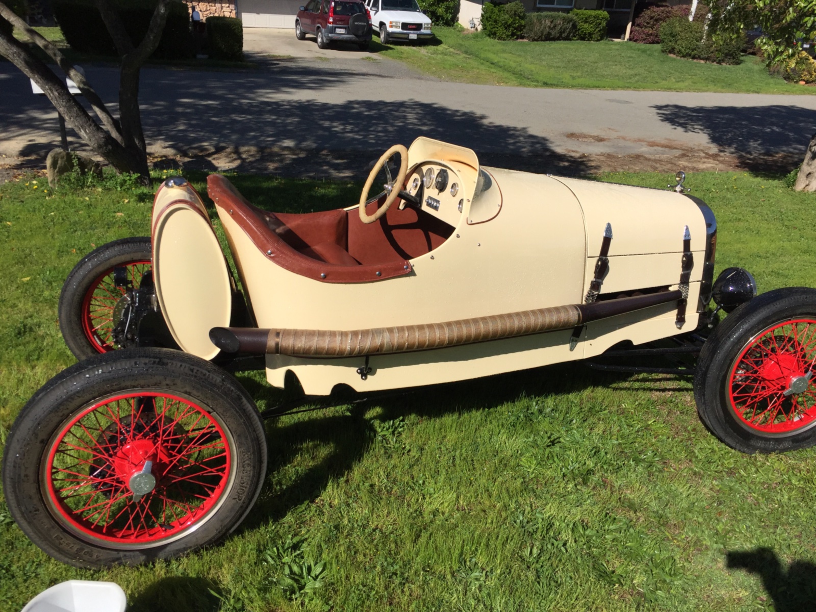

Since you have 21" tires (as shown in your pic), you don't need so much pressure. I run 35 in mine, and it rides great. I switched from years of running clinchers to a set of 21" McLarens a few months ago, and I was quite surprised at the major difference in how well they ride with the lower pressure. The problems Dallas mentions are what you need to observe with clinchers, not balloon tires.

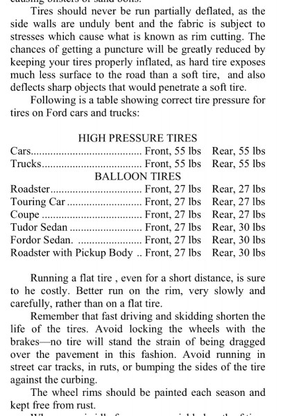

Adam
Posts: 1602
First Name: Adam
Last Name: Doleshal
Location: Wisconsin
Re: Tire pressure, how low can I go?
Post by Adam » Sun May 19, 2019 9:32 am
Tom Hicks
Posts: 761
First Name: Thomas
Last Name: Hicks
* REQUIRED* Type and Year of Model Ts owned: '24 TT, '26 TT, '24 Speedster, '26 Speedster
Location: Chesterfield, VA
Post by Tom Hicks » Sun May 19, 2019 9:44 am
Rich Eagle wrote:
Sun May 19, 2019 9:13 am
Smooth. The rims were new a few months ago.
Ruxstel24
Posts: 2383
Last Name: Hanlon
Location: NE Ohio
Post by Ruxstel24 » Sun May 19, 2019 9:51 am
While balloon tires run at lower pressure, I also believe damage to the tube/tire slipping on the rim, will occur with under inflation. It also adds heat.
Stick with the chart Adam posted and you'll be fine.
Post by Kevin Pharis » Sun May 19, 2019 2:51 pm
On a light speedster, I have found that bout 25-30 psi burns thru the center tread section pretty quick. Down around 10-15 psi will even up the wear... but also provides inevitable complications such as tire slippage and slushy ride. Not worth the trade off!! I usually try for 20 psi (it’s not unusual to be down around 15... oops), but spend a bit of time switching the wheels from right to left side to keep the valve stems from getting too bent out of shape.
If you zoom in on this pic close enough, you’ll notice the valve stems are laying flat against the rims... :shock:

Kevin
Good insight. IMO, have run 30-32psi in the '27 touring, it carries passengers most time. Tire wear hasn't been an issue, nor bent-over rubber stem.
Yours.....oh my.... :o
Am just wondering if those big disc brakes on that nice speedster are having most of the impact of pulling your valve stems flat!

Post by AndyClary » Sun May 19, 2019 6:22 pm
Dan. If you notice the direction the stem leans, it is from the pull, not the braking. Kevin's speedster runs "ok". ;)

Lol that valve stem lean means that Kevin just isn’t braking hard enough before the corners. A more aggressive speedster driver will pass him in the turns! (Just picking Kevin)

Post by Kevin Pharis » Sun May 19, 2019 9:05 pm
One may not have noticed the front brakes in the pic... but I do have issues with the front stems too :D

No expert on your tire pressures but to me it seems like 20 is really too low and the slip verifies it. Better a slightly bumpy ride than a tire problem. For the Montana 500 we run the Max pressure!! IMHOP
Hey, can you tell us more about those front disc brakes. Looks like the same on the back?

That chart posted by Adam D. is informative. Thanks, Adam. I assume it's from some of Ford's literature? Based upon the chart, it looks like I can reduce the pressure in my tires just a bit. I'll probably run them at 30 now. I'd rather err on the side of too high than too low. And as I said in my post above, even at 35 psi they ride 10 times better than what I've been accustomed to. One thing is for sure -- if you are seeing your valve stems lean, your pressure is too low for your car and your driving habits.
Adam
Posts: 1602
First Name: Adam
Last Name: Doleshal
Location: Wisconsin
Post by Adam » Mon May 20, 2019 11:10 pm
Chart is from the Ford Manual.

Reading the official Ford Data on Tyre pressure I rounded the pressure up from 27 to 30 PSI on my 26 T however minor signs
of under inflation wear tell me that 32 or 35psi maybe the go. Forget how low you can run tyres at but how high which is a worry when you understand how crappy the new stuff is!!!
