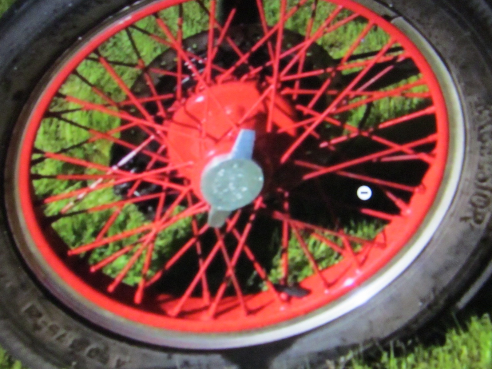

My speedster is lightweight and has a hard ride, bumps in the road can effect handling at higher speeds. The tires are Universal with balance beads and I had them filled to 45 lbs. I have been lowering the tire pressure and have found she rides much more smoothly at 20 lbs. Can I go any lower with the tire pressure?

Since you have 21" tires (as shown in your pic), you don't need so much pressure. I run 35 in mine, and it rides great. I switched from years of running clinchers to a set of 21" McLarens a few months ago, and I was quite surprised at the major difference in how well they ride with the lower pressure. The problems Dallas mentions are what you need to observe with clinchers, not balloon tires.

On a light speedster, I have found that bout 25-30 psi burns thru the center tread section pretty quick. Down around 10-15 psi will even up the wear... but also provides inevitable complications such as tire slippage and slushy ride. Not worth the trade off!! I usually try for 20 psi (it’s not unusual to be down around 15... oops), but spend a bit of time switching the wheels from right to left side to keep the valve stems from getting too bent out of shape.
If you zoom in on this pic close enough, you’ll notice the valve stems are laying flat against the rims...

Kevin
Good insight. IMO, have run 30-32psi in the '27 touring, it carries passengers most time. Tire wear hasn't been an issue, nor bent-over rubber stem.
Yours.....oh my....
Am just wondering if those big disc brakes on that nice speedster are having most of the impact of pulling your valve stems flat!
Yours.....oh my....

Dan. If you notice the direction the stem leans, it is from the pull, not the braking. Kevin's speedster runs "ok".

Lol that valve stem lean means that Kevin just isn’t braking hard enough before the corners. A more aggressive speedster driver will pass him in the turns! (Just picking Kevin)

One may not have noticed the front brakes in the pic... but I do have issues with the front stems too

No expert on your tire pressures but to me it seems like 20 is really too low and the slip verifies it. Better a slightly bumpy ride than a tire problem. For the Montana 500 we run the Max pressure!! IMHOP
Hey, can you tell us more about those front disc brakes. Looks like the same on the back?
