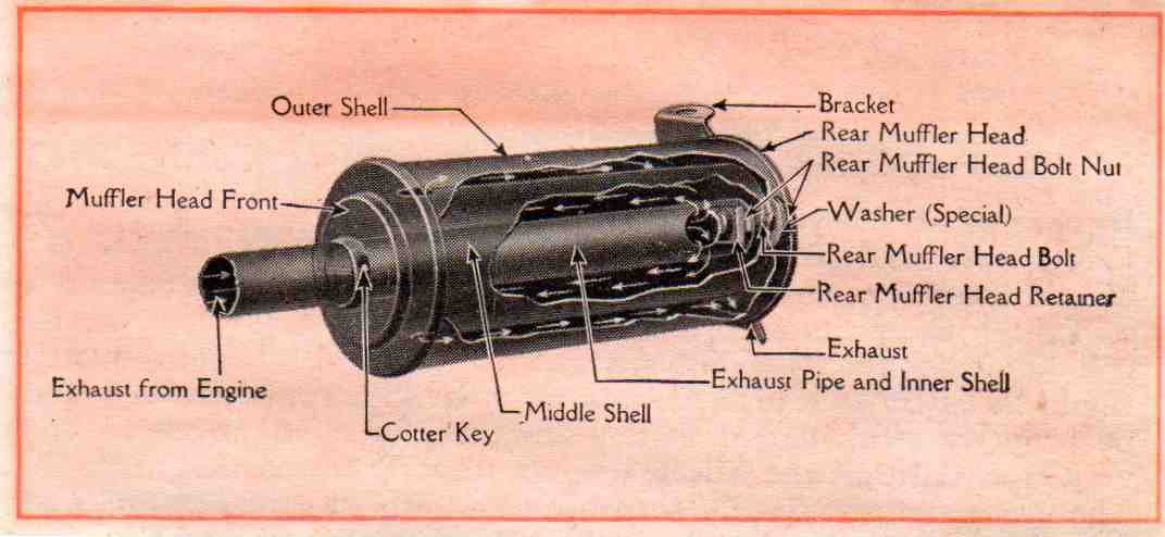

A different muffler might be more to your liking. As mentioned above, a muffler with cast iron ends and a heavy gauge shell might be a good idea.
If you have a performance camshaft and/or high compression head, your engine might be somewhat louder than a stock one.
If the exhaust pipe is touching the frame or hogshead, that might increase noise. A short tailpipe might reduce noise. My car has a glasspack muffler, and is fairly quiet. I added a tailpipe about 14" long, and it made it quieter still.

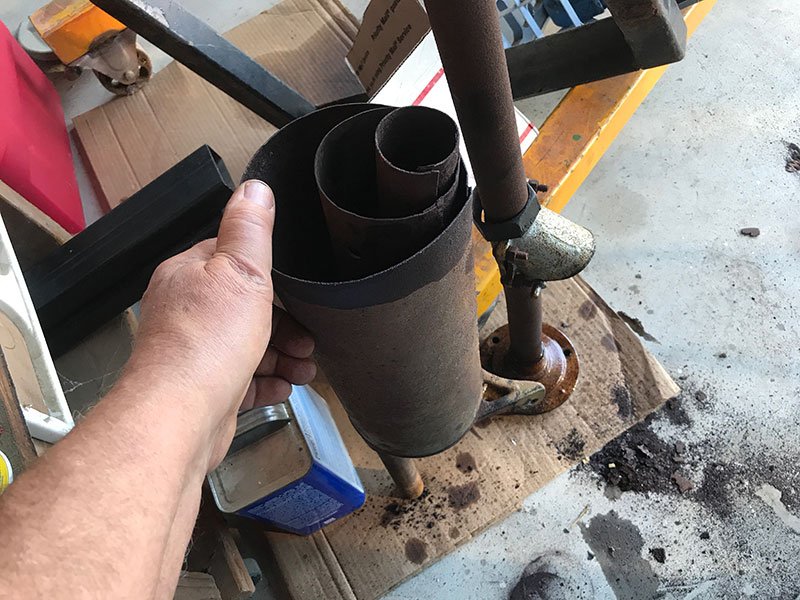

Assuming normal engine running & just focusing on the muffler issues. Not exactly sure what muffler you have
