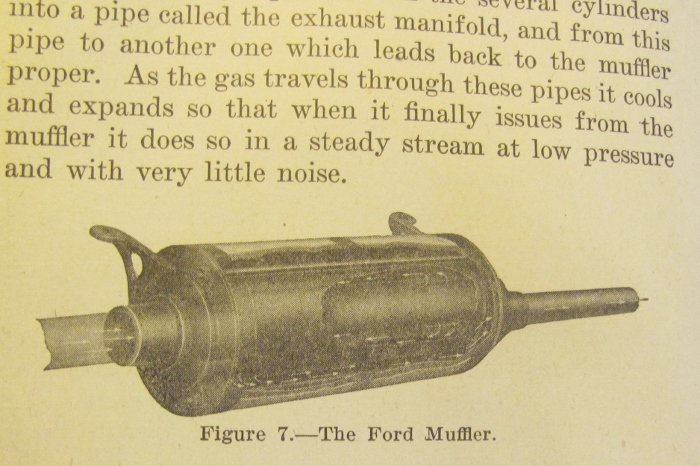

Re: What's the Secret to a Quiet T?
Secret revealed :
Leo van Stirum, Netherlands
