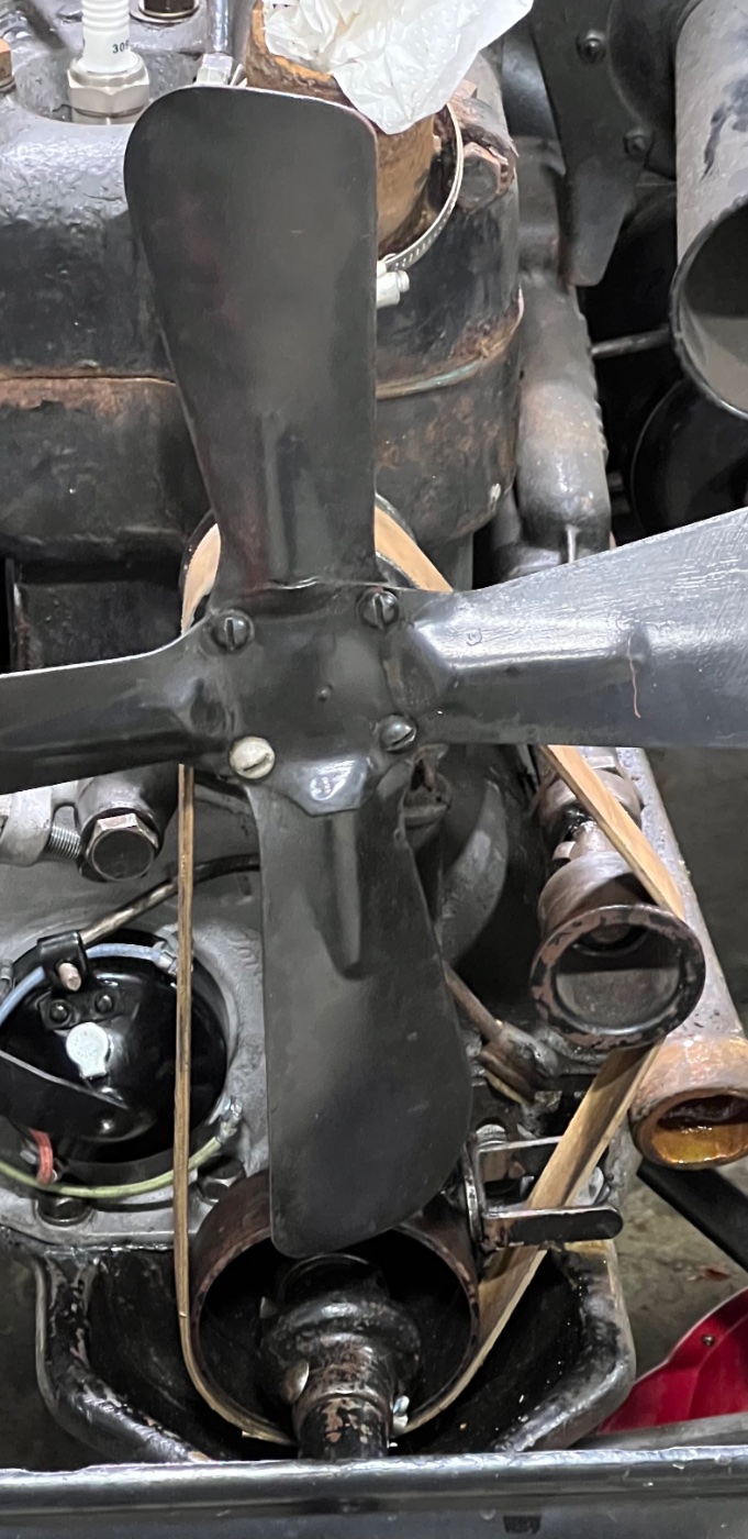

Hello! I’ve noticed my fan belt is rubbing on my timer and has created a small groove. I know that part of the problem may be the belt, which I plan on replacing. But I’ve noticed there’s a slight wobble in the fan and shaft itself. I’d like to rebuild it so that it doesn’t have play and so that I know it’s good to go. Can someone help guide me with perhaps a parts list so I can buy them from langs? It’s a 24 coupe. Thank you all!

Photos please. There is a variety of fans, pulleys/shafts/mounting arms. The recommended fix will vary.

I’ll get better photos tomorrow, but here’s the only one I have so far

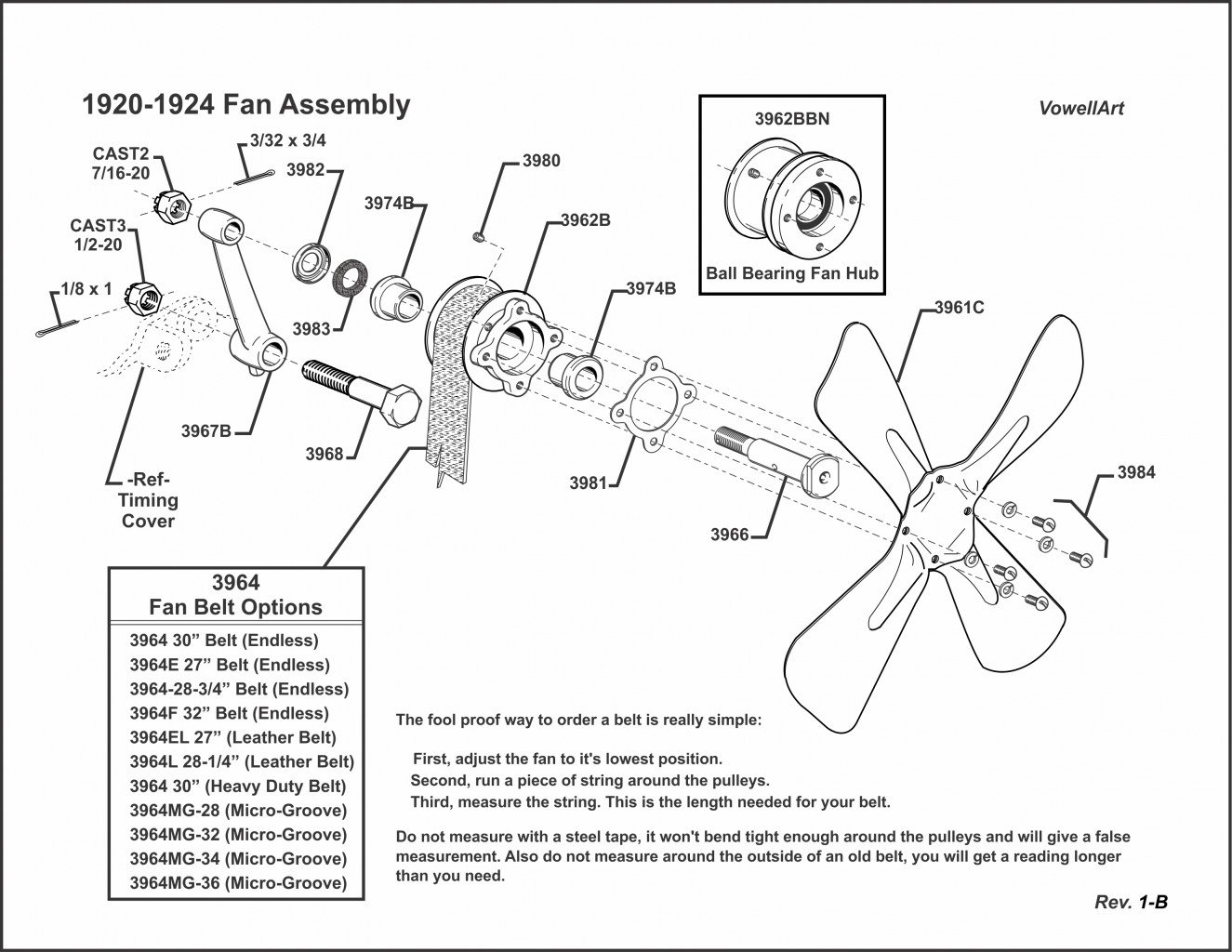

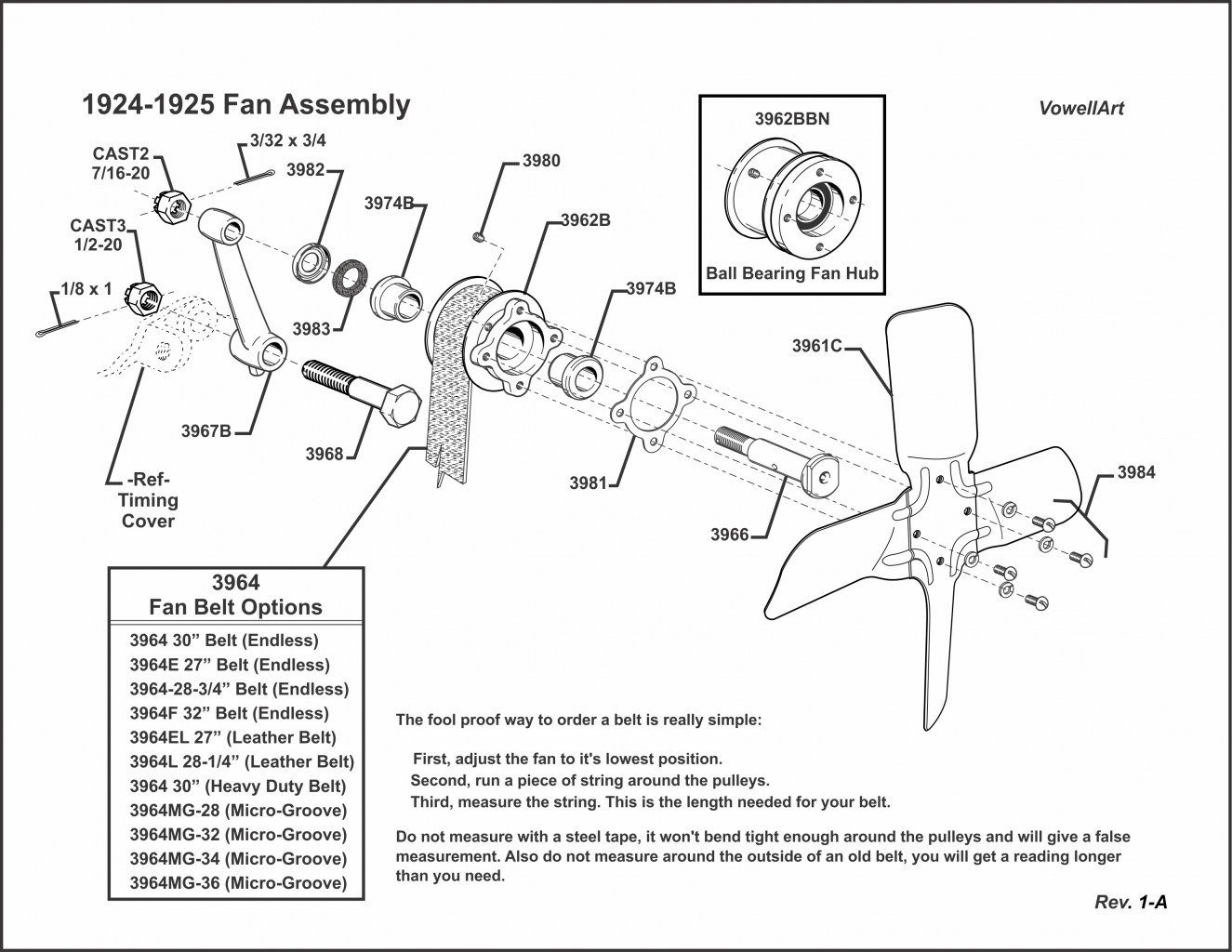

https://www.modeltford.com/item/3966B.aspx
Lots of parts here:
https://www.modeltford.com/pl.aspx?t=s& ... ley&page=1

Tim, play is usually due to wear in the pulley bushes and/or the shaft, both of which are available from the vendors. New bushes should not be a precision fit on a new shaft. There needs to be some clearance to allow oil to lubricate the bushes. The shaft is stepped so that it is screwed up firmly against this step when installed in the arm. If this locks or causes drag on the fan, then there needs to be some material removed from the thrust face on the bush to free it up. Do not be tempted to back the shaft off the step and rely on the castle nut to hold it in place as a locknut.
The water pump is a complication, and the belt may be too long. A standard fitment allows the fan arm to be lower, making the belt track further away from the timer housing.
Hope this helps.

Tim,
A little slop in your fan shaft and bushings may be OK, and as others have stated, too tight a fit is a problem, so you may or may not have an overly worn fan hub. Your issues appear to be self inflicted, your fan belt looks too long which is positioning your fan pulley and belt too close to the timer, caused by using an unnecessary water pump and belt aligner. The fan belt should be loose enough to allow the belt to slip and let you turn the fan blades by hand with just a little resistance (when the engine is not running). Water pumps need a tighter belt, something the T was not designed for. If you intend to run a water pump you might consider upgrading to a ball bearing fan hub so that you can keep your belt tighter.

You might consider a new ball bearing hub.

Is that a crack on the blade at 3 o'clock as you look at it from the front?
