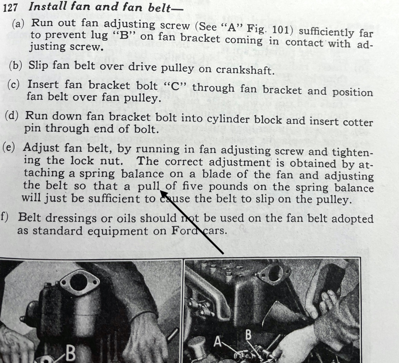

Post by DanTreace » Wed Nov 29, 2023 6:20 pm
Also, regarding fan belt tension, many times too much tension is used and that can cause undue wear on the bushings.
Same with water pump, if too much belt tension.
The long shaft of the pulley will be flexed and causes rapid wear of the shaft packings, resulting in leaks that deplete the cooling system.
The belt is to be tighten to a 5 lb. pull says Ford.
IMO, use two fingers, placed under a blade,* and pulling up with minor resistance to have the fan pulley slip on the belt.
That works to test tension. ;)
*Engine off :?
