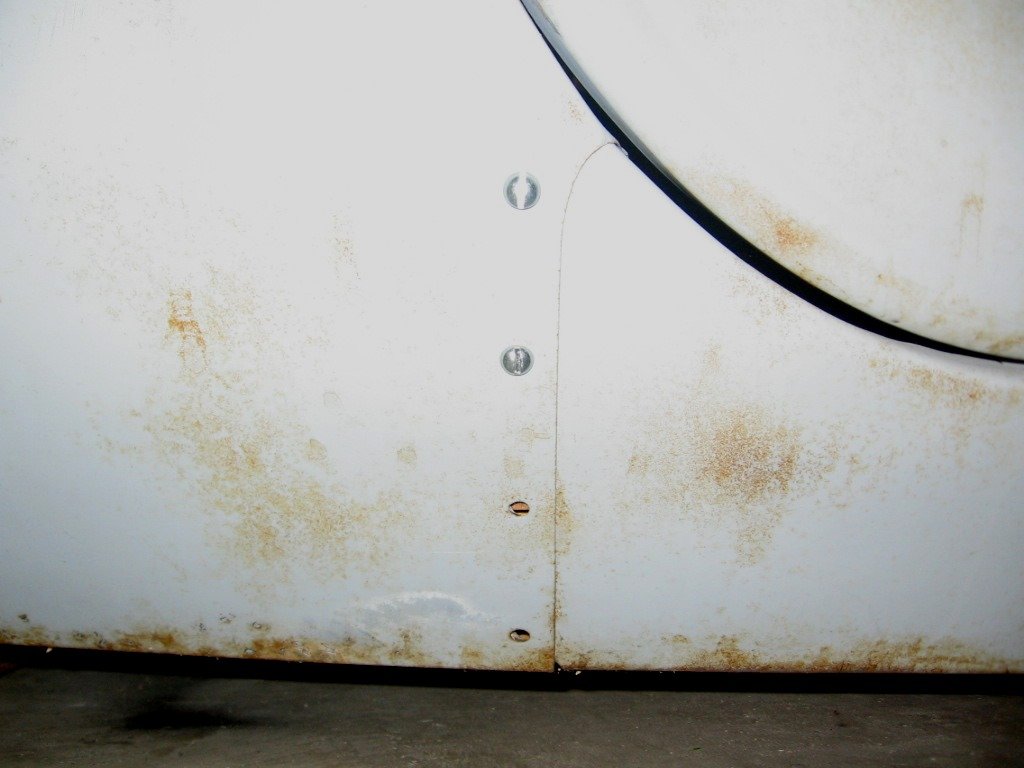

Here is that area on my 1925 Touring body. There is a seam, the parts are attached to the wood rail with four round head wood screws. I only have two screws installed on the picture because I can't reach the lower two with the body near the floor of my basement.
I have been told that this area is hidden below the rear fender on a finished car. :)

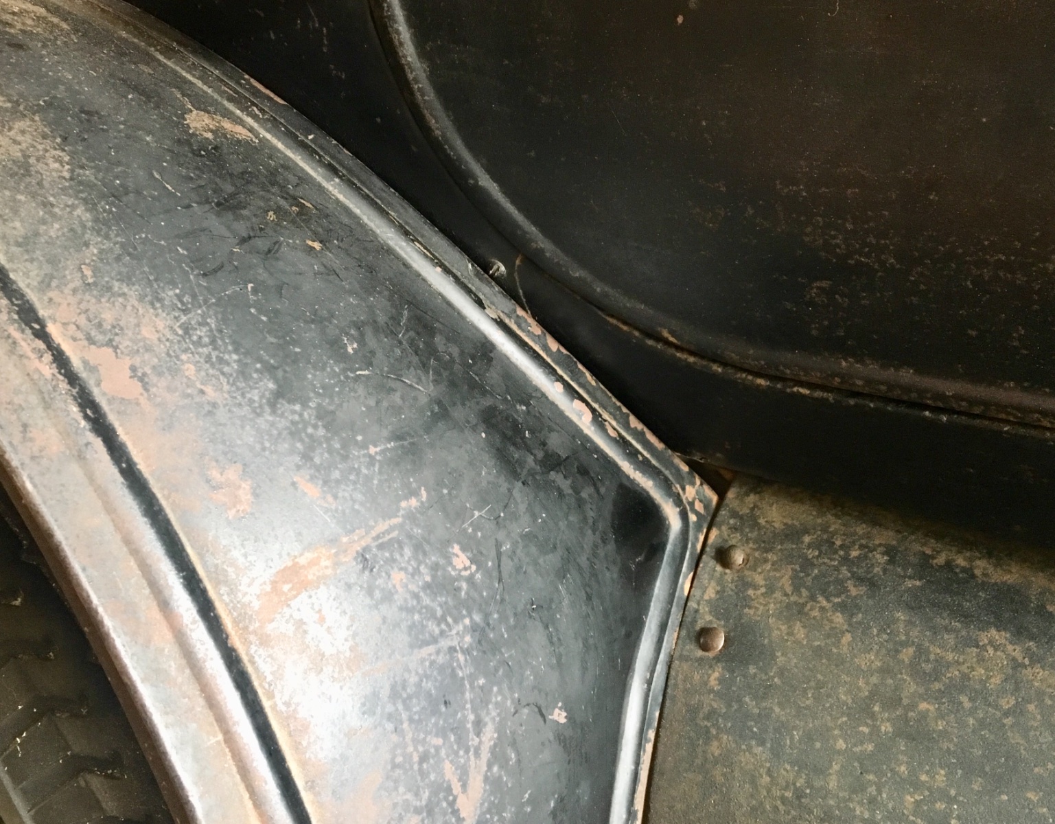

Post by RustyFords » Wed May 29, 2019 6:54 pm
24 Touring
1924 Touring

It appears as though the seam was intentional as the pieces were stamped originally separately. Was that the method originally used, screwing the pieces together into the wood frame? Interested to see if anyone has any other photos they could post for clarification.

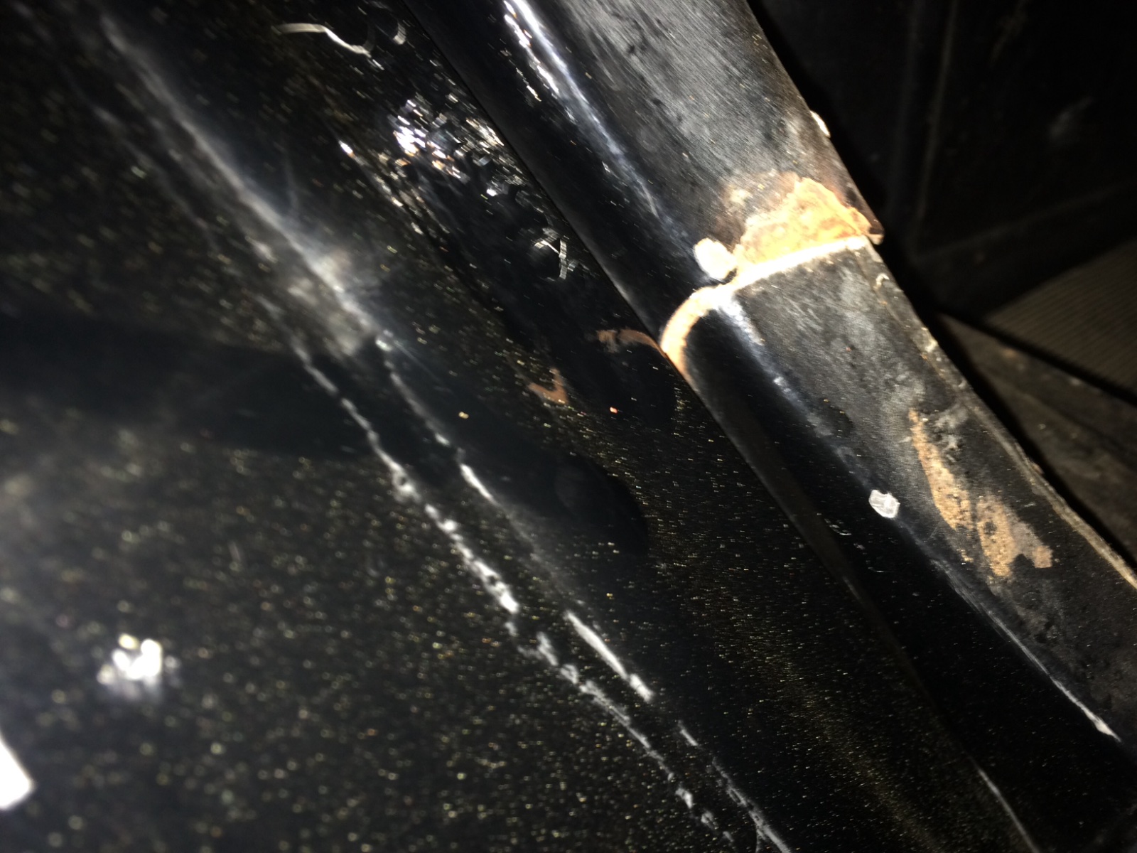

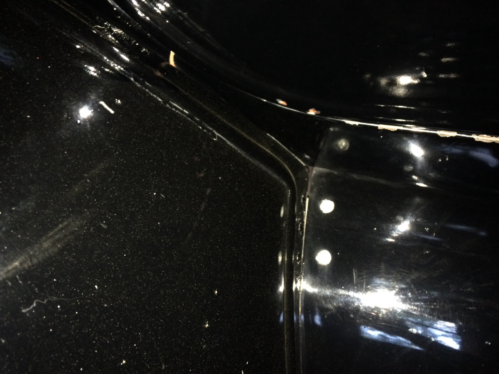

Post by Ruxstel24 » Wed May 29, 2019 7:53 pm
Seam on mine, don't see any screws...

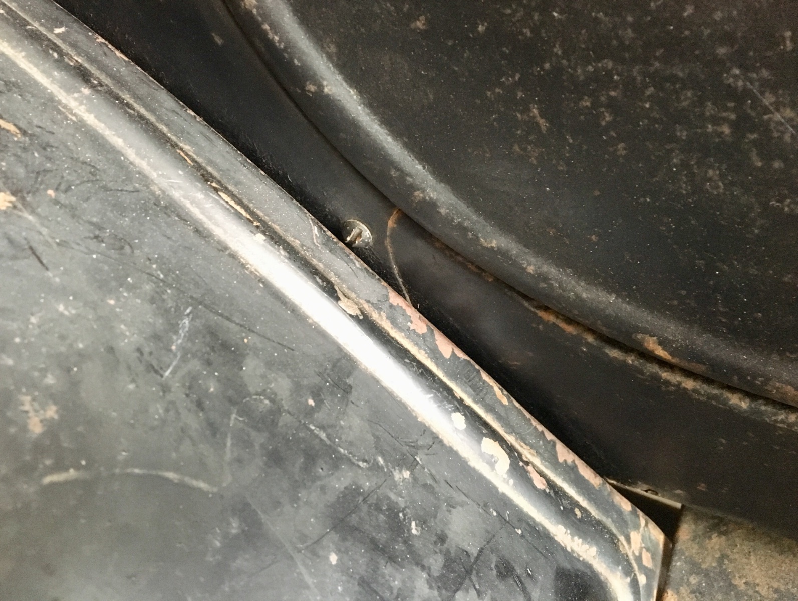

Post by RustyFords » Wed May 29, 2019 10:56 pm
My car saw a lot of farm repairs back in the day.
I wouldn’t be surprised if that screw was one of them...although it does have the exact same screw in the exact same spot on the other side
1924 Touring

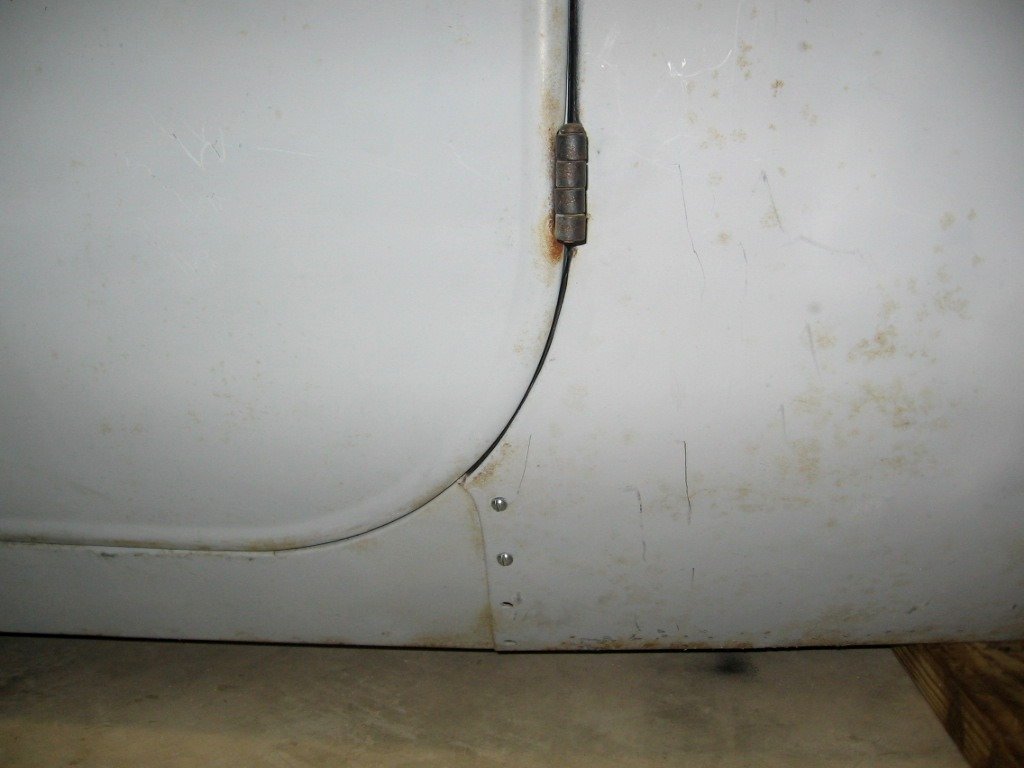

Post by CudaMan » Thu May 30, 2019 5:27 pm
Sure, here it is. I didn't take a picture of the passenger side before because it looks just like a mirror image of the driver's side. :)
