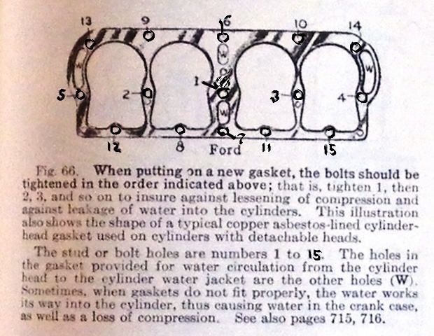

1. What order do I tighten them in?
2. How much do I tighten them?

Using the torque wrench. We did 20 then 30 then 55 pounds per the book.
After you run the car you will have to torque them again. Make sure that you clean out the holes and put the gasket on correctly. It has a front and a back that can fool you.

After cleaning the block holes very well, to be sure they are free of carbon debris, then spray the gasket with Copper Gasket coat, or use a high metallic content alum. spray paint.
Most important is the sequence to torque to squeeze the laminated gasket for best sealing against leak. Must do 1, 2, 3, 4 and 5 first as the cylinder walls are the closest and the gasket is the narrowest there.
45 ft/lbs is safe bet to prevent a sheared off used head bolt, better to use new head bolts.

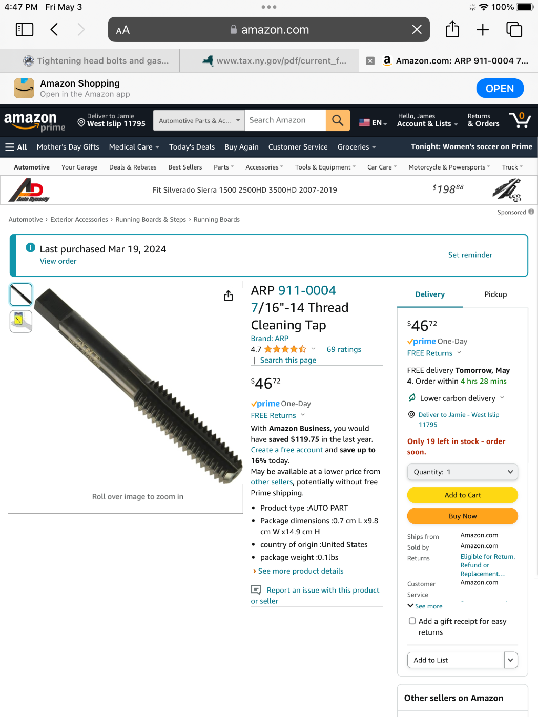

This is the proper tool to clean out block threads !

RajoRacer, where did you purchase that tap?

Goodson Engine Supply, I believe.

Craig - that tool I posted the photo of above does not remove metal - only carbon.

I didn't intend to step on your tap, I just wanted to caution guys on using a new sharp tap to clean out the threads in the block because some
taps will remove more than just carbon from the thread taking away precious metal. For those that don't know that tap pictured is a GOODSON
BCT-7/16 head-bolt hole clean-out tap specially designed for that purpose. It's used lubed ( not dry) to lift rust, dirt, chips & other debris as you remove the tool they will repair minor damage with out re cutting the threads. In my 2 year old catalog they are $60 I would think they are a
must have for anyone that builds a lot of engines.

This is what I bought to clean head bolt holes. Going to replace head in next 2 weeks.
