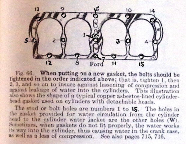

I am putting a new head gasket on my t and I had a few questions:
1. What order do I tighten them in?
2. How much do I tighten them?

It's in the engine Book.  But here is a video of what we did.
https://www.youtube.com/watch?v=p220qHzTJRw
https://www.youtube.com/watch?v=v8jDPK04Cgk
Using the torque wrench. We did 20 then 30 then 55 pounds per the book.

I prefer 45 lbs. - 55 seems high for steel threads into a cast iron block !
 - Posts: 3962
Re: Tightening head bolts and gasket protocall
After cleaning the block holes very well, to be sure they are free of carbon debris, then spray the gasket with Copper Gasket coat, or use a high metallic content alum. spray paint.
Most important is the sequence to torque to squeeze the laminated gasket for best sealing against leak. Must do 1, 2, 3, 4 and 5 first as the cylinder walls are the closest and the gasket is the narrowest there.
45 ft/lbs is safe bet to prevent a sheared off used head bolt, better to use new head bolts.
