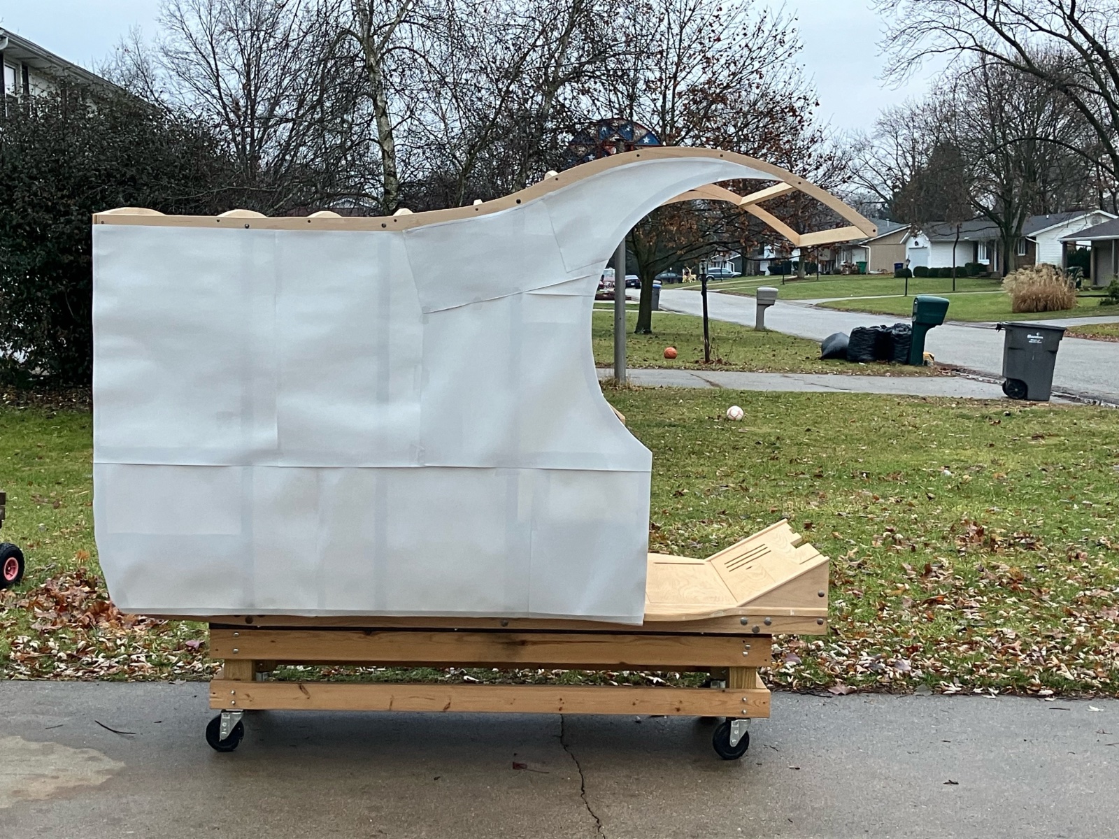

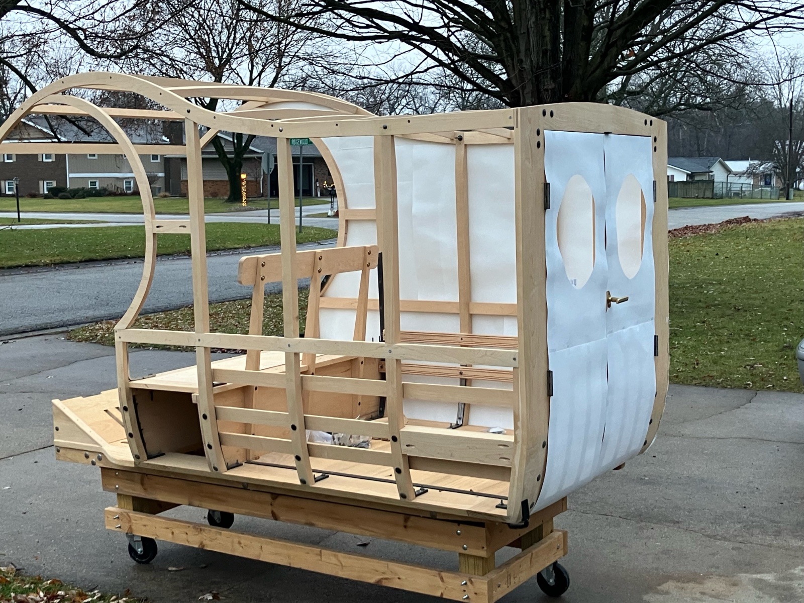

I need some advice, pointers, and tips. I have all my metal panels for the next phase of the Delivery Car project and need some pointers when it comes to fastening them to the wood frame. The floors are ash 1" thick, the rest of the framing is Hard Maple and mostly 3/4" thick where it will be nailed.
The metal panels on the sides consist of an upper panel and a lower panel that will be butt jointed along the long horizontal frame. The lower panel will have a 90 degree flange along the bottom so it can be nailed from underneath. Both panels will be nailed top, bottom and sides only. The door skins are just nailed along the perimeter of the door frame.
Questions:
- When nailing the metal on, should I start in the middle at the top of the panel or bottom of panel?
-How many nails should be placed in the panel 1 every 3", 4", 5"? etc..
-Should I pre-drill the nail holes?
-What tips do you have or things that were helpful to you when nailing sheet metal?

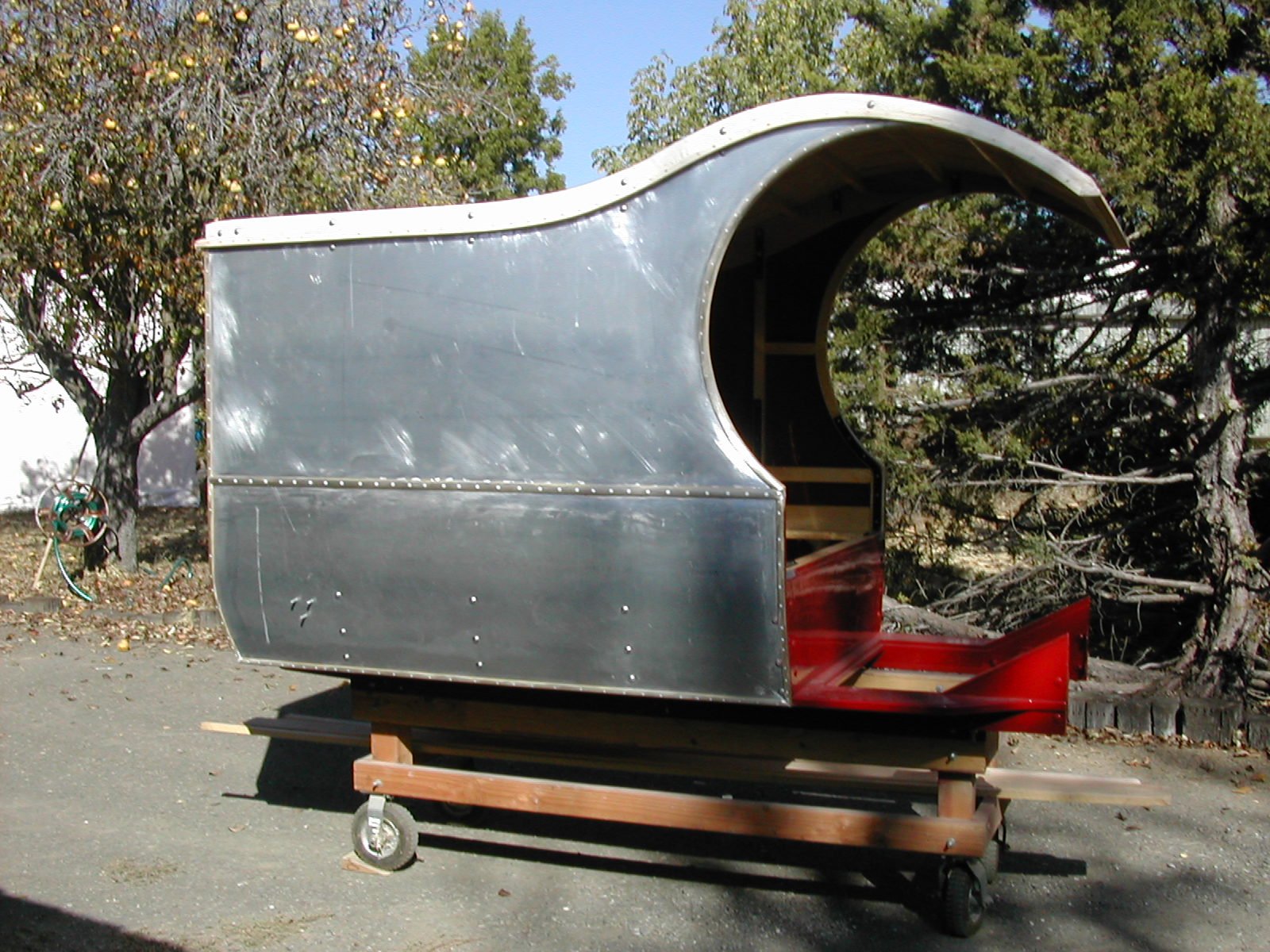

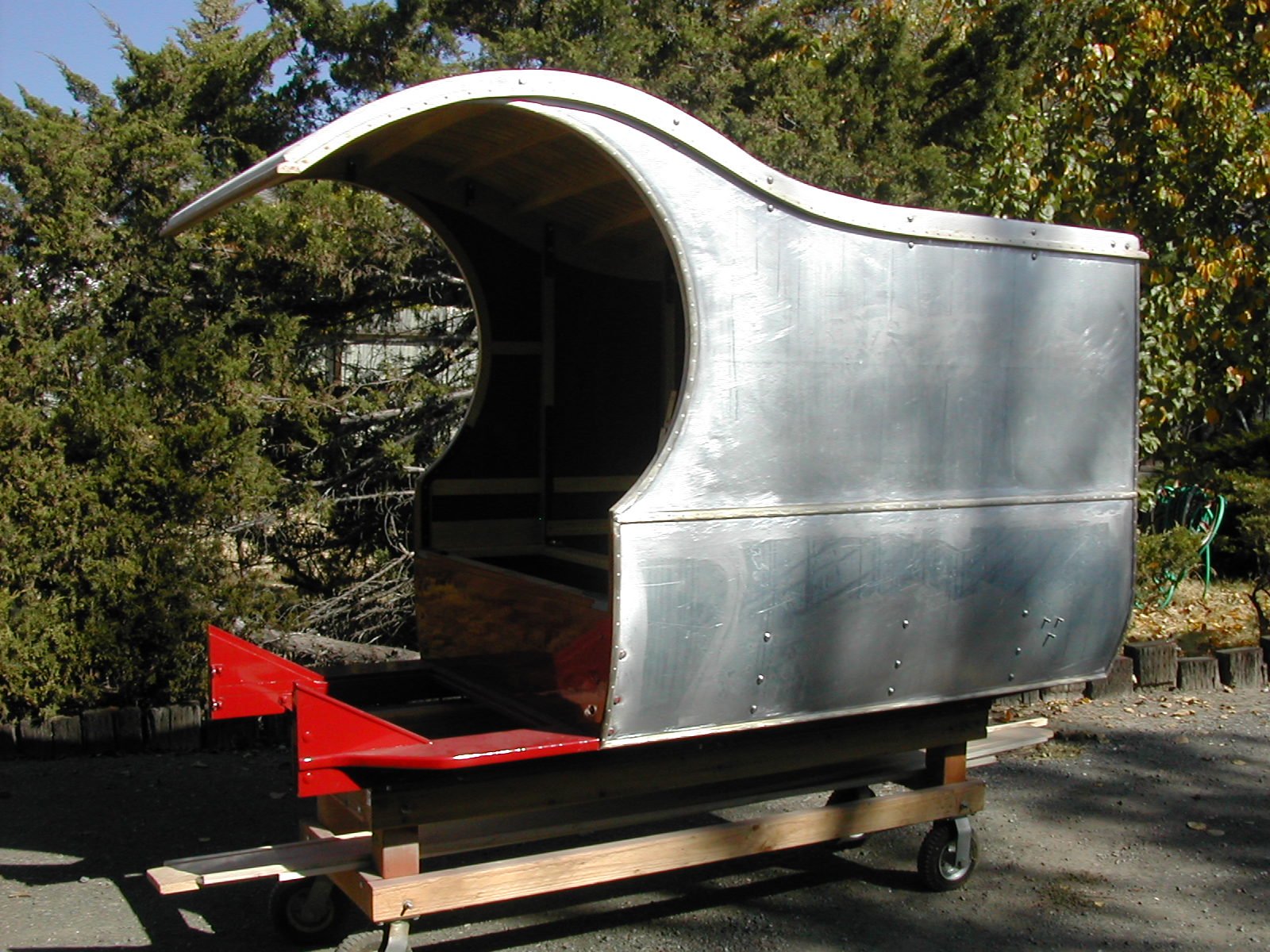

My chocolate van I panelled with aluminium sheets. Because the original van had C mouldings around the edges and at the joins in the panels, any fixings were hidden. I could use 3/4" nails with annular rings for the job. If you can find same in stainless steel, these will be less likely to bend when nailing and not corrode in place. It may be worthwhile experimenting with pre-drilling the holes.
I would recommend using an adhesive on the framework to bond the sheets to prevent rattles. The adhesive I used worked well for 20 years, but has let go in places now. Modern equivalents should be better. i clamped timber laths on the outside to load the panels in contact with the adhesive until it had cured. It was simply a matter of running the ends of the laths over a buzzer to machine a slight curve. When the ends of the laths were clamped, the centre put a little load on the panel to hold it to the framework.

Having worked with very large metal panels for a good amount of time. Heat is your best friend. If when the panel that is secured is warmer
than the frame or support it is installed on that when it cools it will be taunt & smooth. Oil canning is a issue that will take up tons of time to
correct. Just a observation I have found to help.

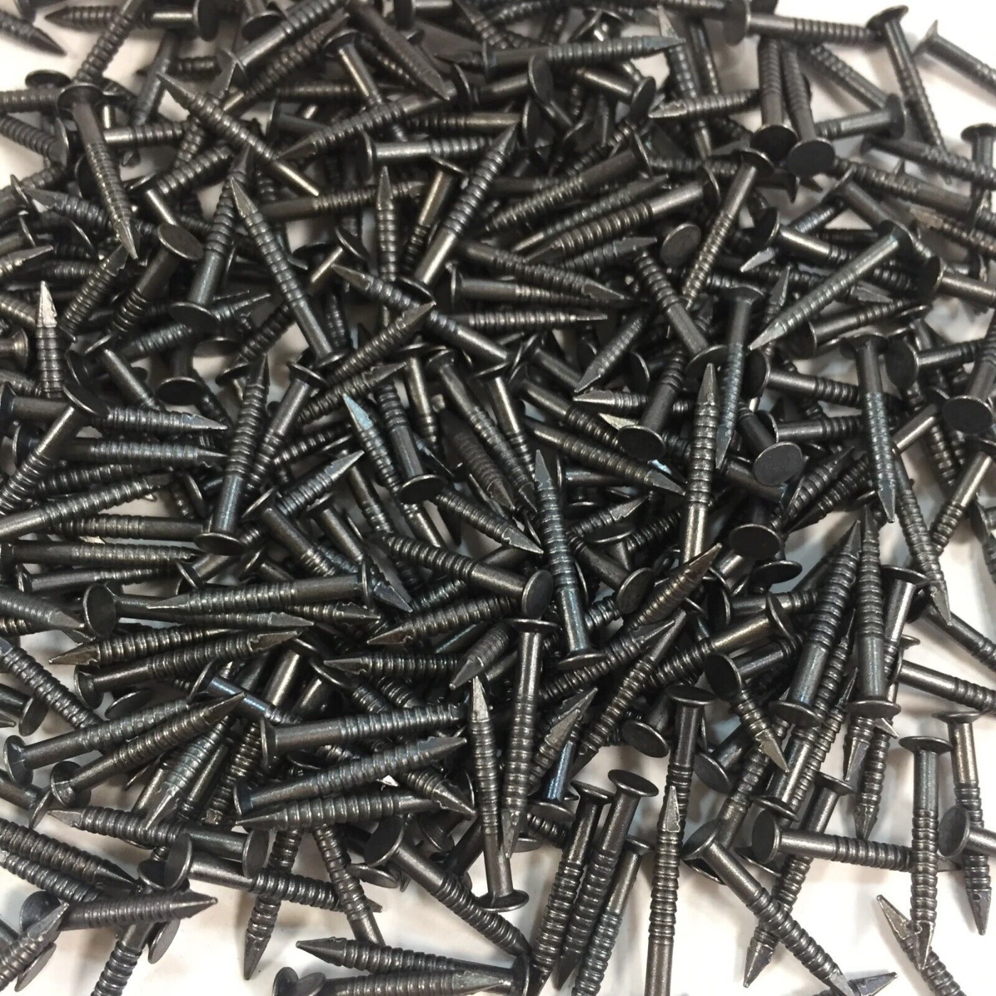

Mike, Lang's has body panel nails. They have worked great for me. Check out their catalog or give them a call. Good luck on your project. It's coming along nicely!

Mike, the panel nails are just part of the "hold" on the panels. When I built my chocolate van, the panels were cut to fit and then glued to the frame, both around the edges and on the intermediate body timbers, being held in place with clamped-on timber laths. Today I would use Sikaflex auto body adhesive rather than the construction adhesive that has let go after 30 years.
The nails then become insurance to make sure the panel stays in place. With panels in place, it is easier to mark out the nail lines to make sure they will be covered by the concave under the C moulding. My nails also had the annular rings. Fewer precisely aimed blows with a well weighted hammer is better than multiple multiple blows with a lighter hammer. I did pre-drill the panels, and if a nail was in a difficult position, I used a punch so the blow was on that rather than the nail.
I screwed the mouldings on using slot head countersunk stainless steel screws at 3" intervals. These to add to the fixing insurance. They were countersunk below the surface of the moulding and then hidden with body filler before painting. After 30 years some cracking has occurred on a few of the screws, but that is expected. On my 1917 shooting brake I used the same screw technique to finish the edges of the canvas top where they fold over the side timber. These are left with no filler.

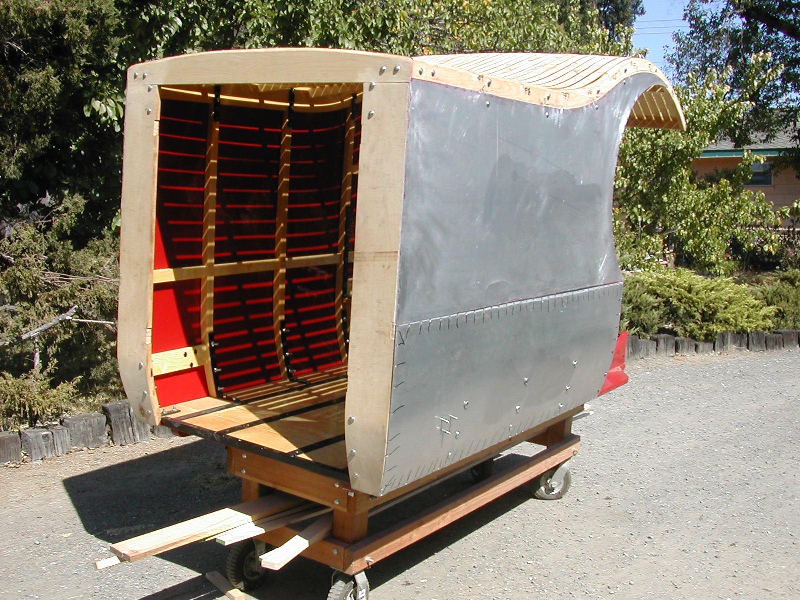

From Craig Beek's photo library of his Pie Wagon
Painted inside before nailed on
