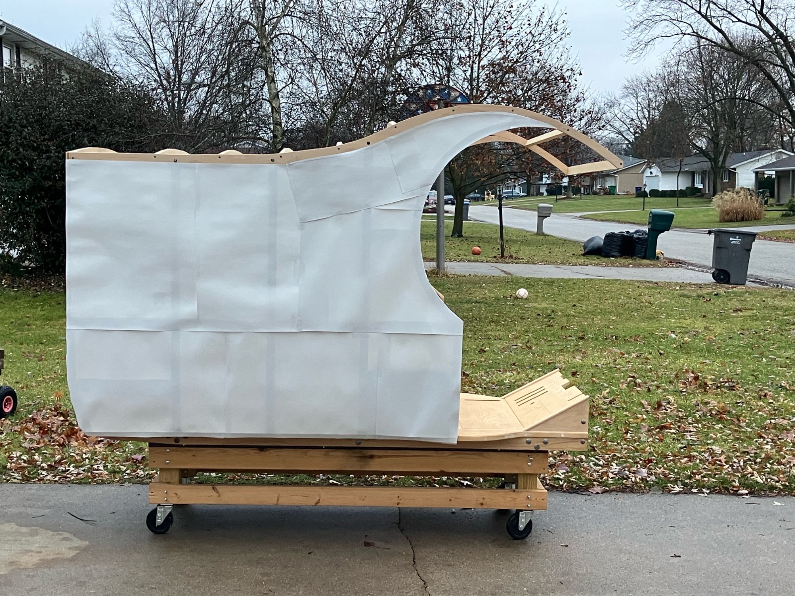

The sides use only use two pieces. A lower section that’s about 21” wide and 66” long . The upper section is about 37” wide and 81” long. The two pieces are butt jointed on the long horizontal piece. A piece of moulding covers the seam. The metal is 22 gauge steel. 3” sounds like a good idea. As to your question regarding using plywood for the sides. I can’t speak of other delivery (non Ford) bodies how they were constructed, but the Ford delivery cars consisted of a wood frame skinned in metal. Ply wood was never used originally.

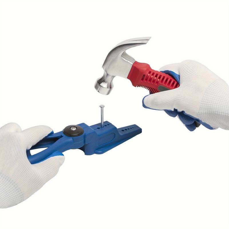

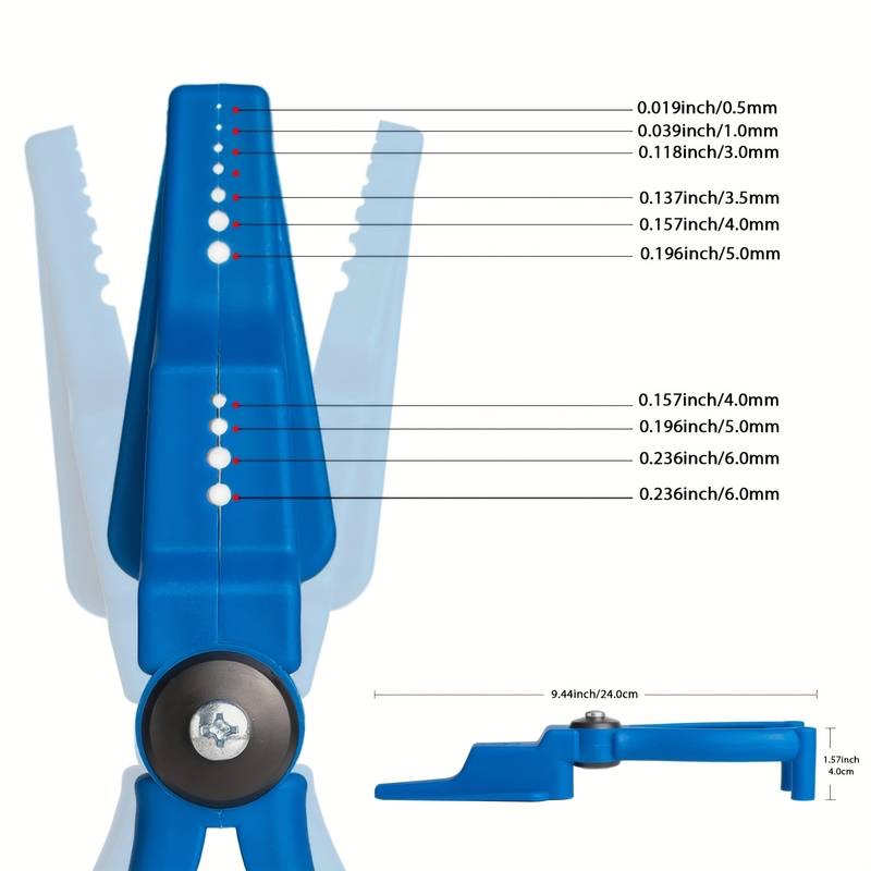

Here is another very useful tool you might want to consider. I have one of these and it is very useful for holding small, short nails and starting the nail straight while protecting the fingers. Jim Patrick.

Post by Les Schubert » Sun Feb 18, 2024 12:58 pm
Jim where can I buy that nail holder pliers?
Looks like something I need
Nail holding pliers - TBAY $8 & up

Post by jiminbartow » Sun Feb 18, 2024 11:36 pm
Les. Try www.temu.com. That is the name that came up with the image. $8.48. Amazon also has them under nail holder. If you want to find more, go online and search nail holder. They are very handy. Jim Patrick

Post by Les Schubert » Mon Feb 19, 2024 4:29 pm
Found them on Amazon. Should have them by Wednesday

Very good thoughts here guys. Very helpful. I especially like the nail holding pliers. I ordered a set should be here tomorrow. I also decided to use a #16 gauge brad nail with a head. Unfortunately I can’t find them any shorter than 3/4” so I’m going to be modifying a lot of them to be about 5/8”

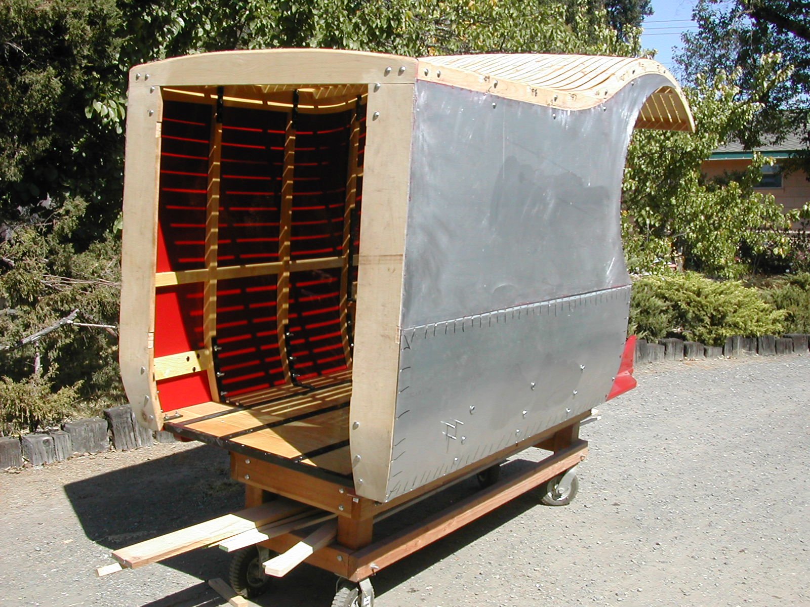

Post by TRDxB2 » Wed Mar 12, 2025 2:42 pm

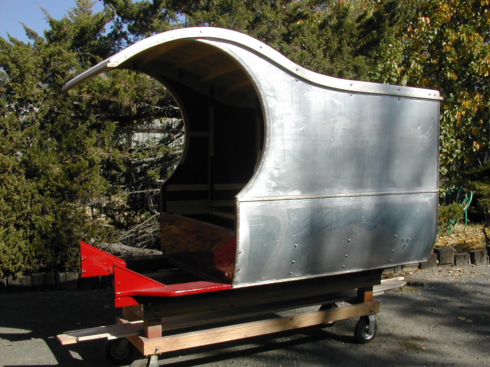

From Craig Beek's photo library of his Pie Wagon
Painted inside before nailed on
