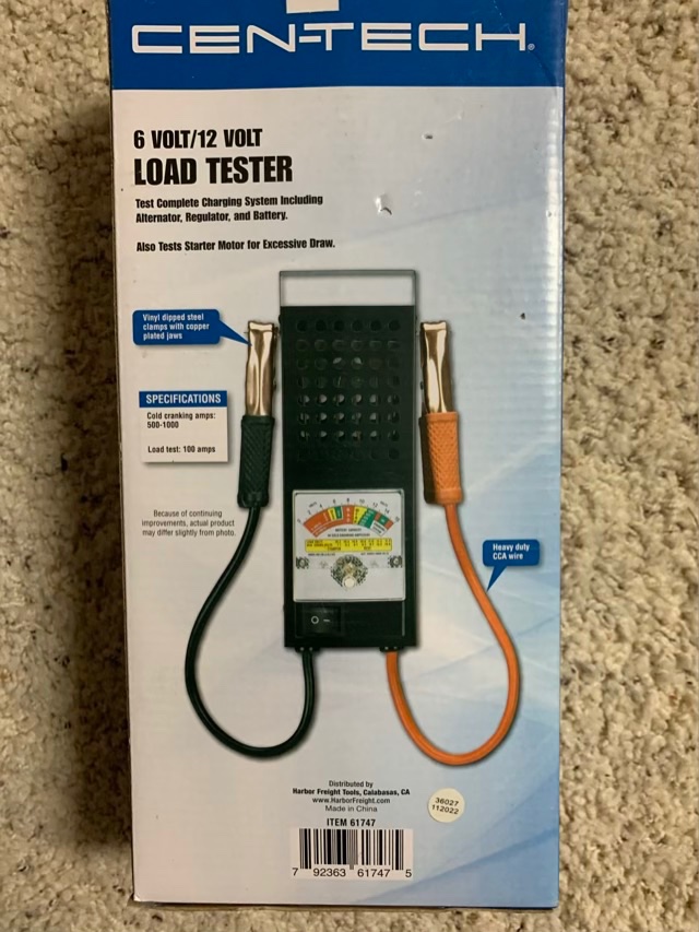

Post by jsaylor » Tue Apr 09, 2024 11:54 am
I highly recommend the Harbor Freight Centec load tester. It will give you quick look at your battery condition.
