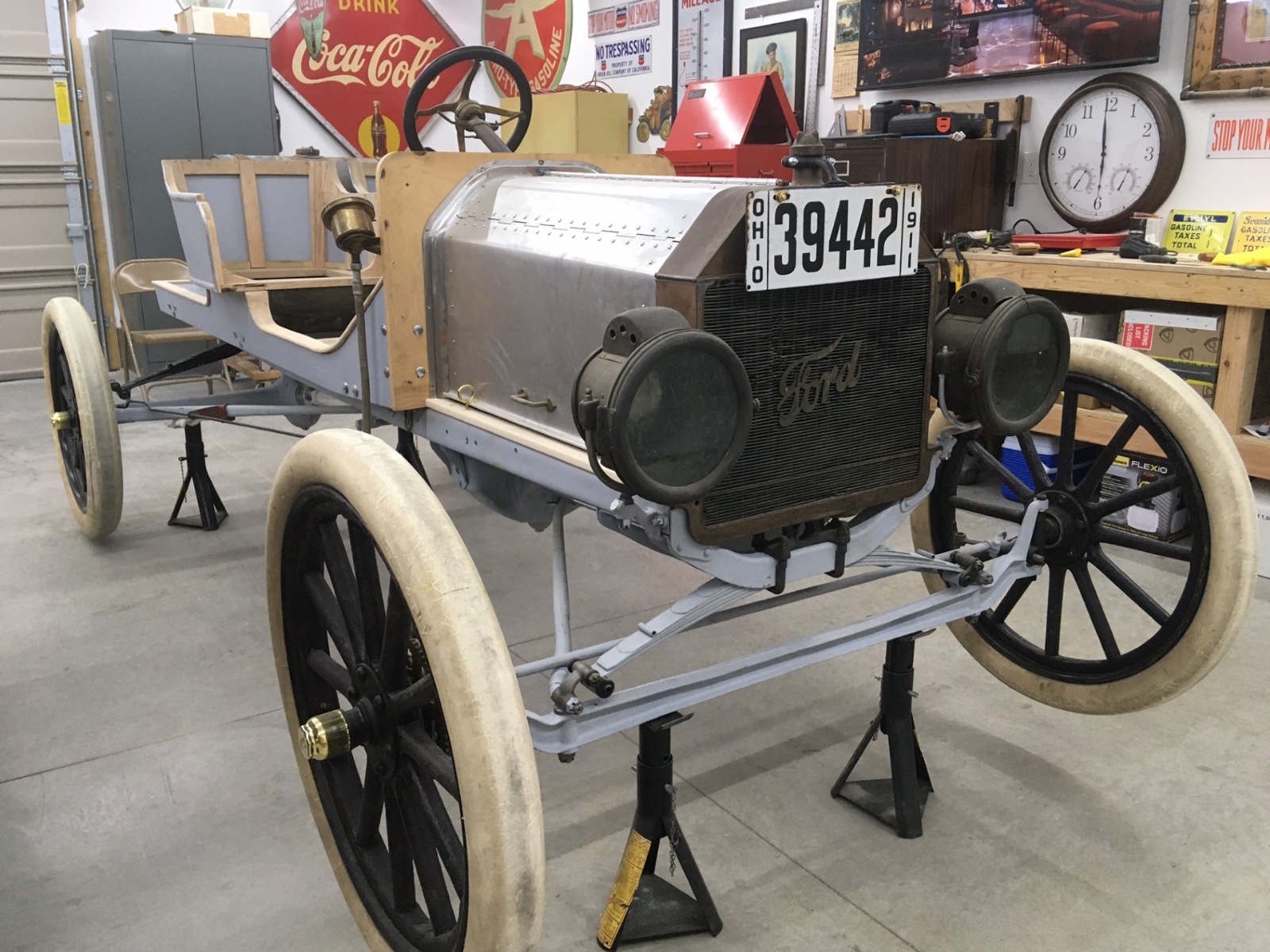

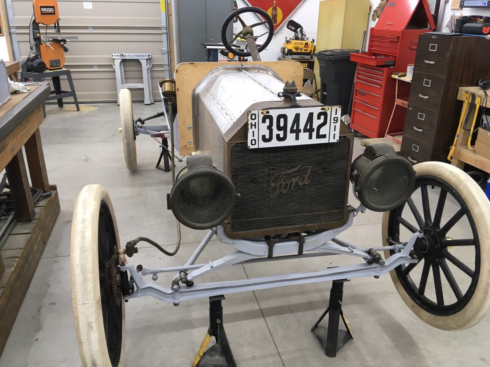

5” stretch frame with 5” stretch torpedo hood. Show me what you would do for a body.

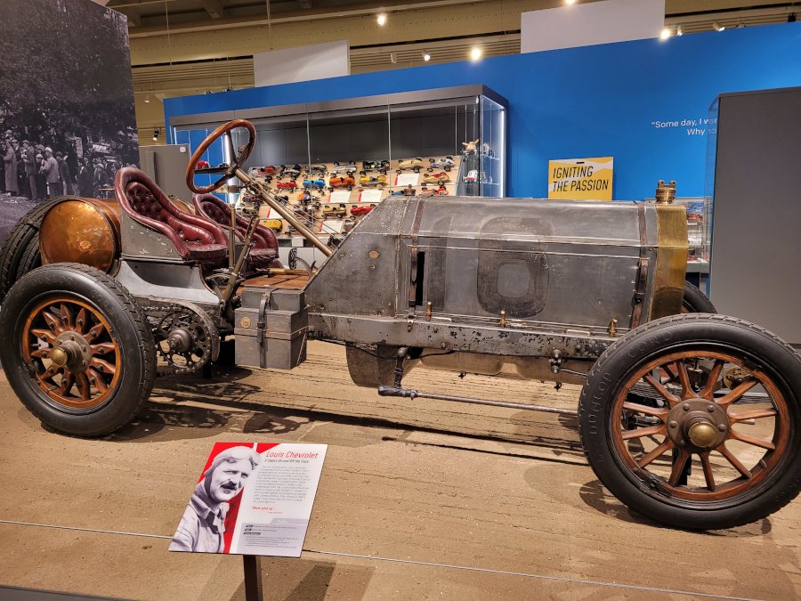

Sacrilege to go for the look of Louis Chevrolet's racer?

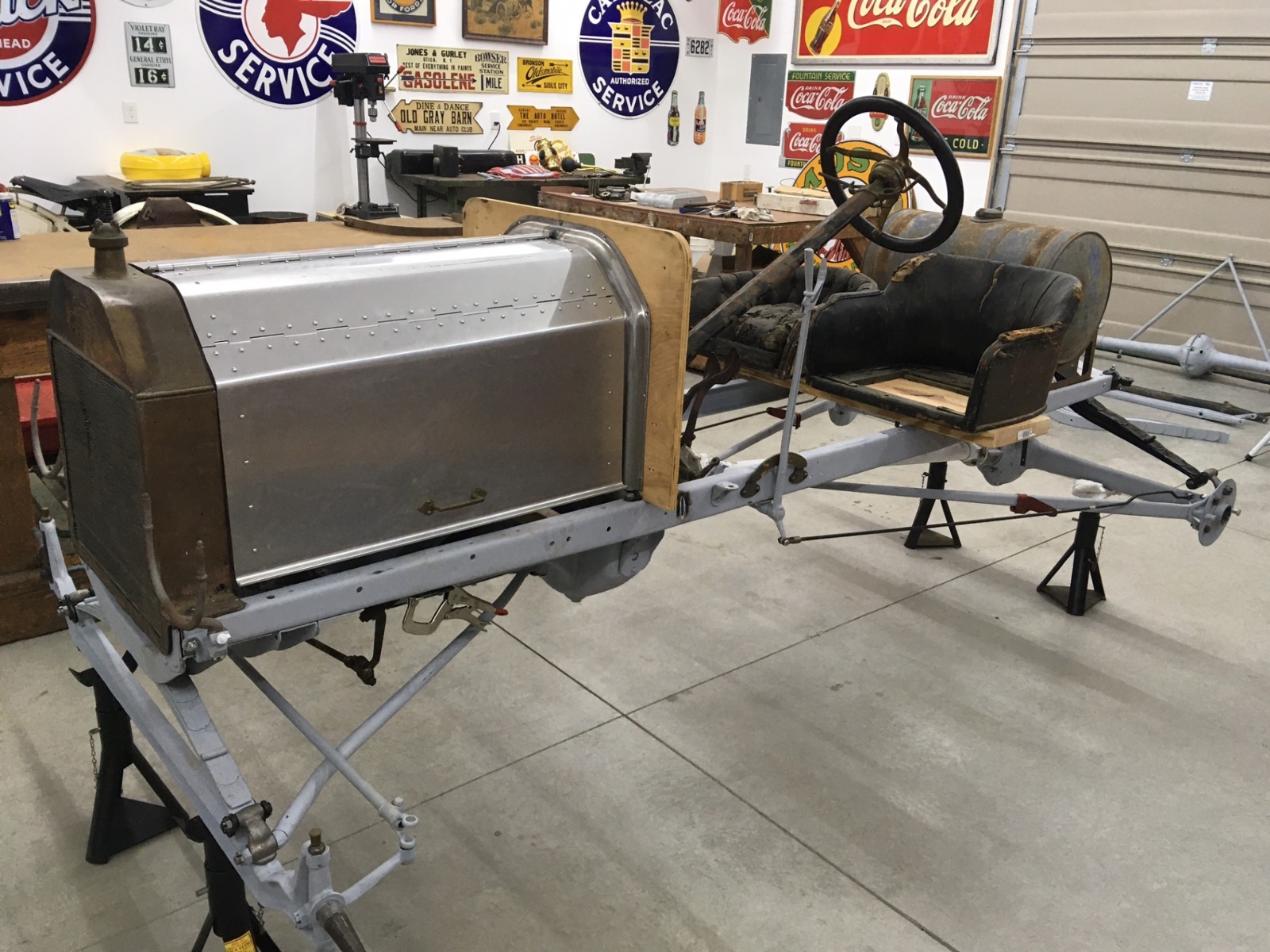

Posts: 3875
Re: You tell me
Post by Dollisdad » Sat Sep 30, 2023 9:09 pm

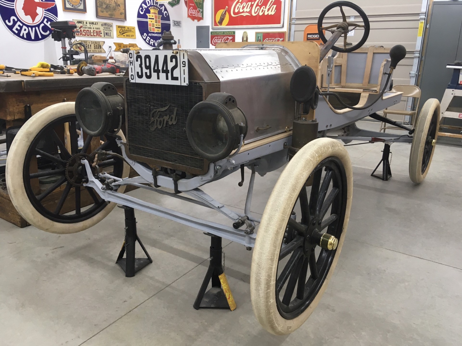

Well, I moved this to Ohio and have started to place some parts on the chassis to get a feel for what to do for a body. I like the basic feel of the spacing, but it needs a body platform of some type. Step in or step over. Flat dash or scuttle cowl. Tool box or ? on the tail end. Suggestions most welcome.
Posts: 3875
Re: You tell me
Post by Dollisdad » Sat Sep 30, 2023 9:10 pm
Posts: 3875
Re: You tell me
Post by Dollisdad » Sat Sep 30, 2023 9:11 pm
Posts: 4415
Re: You tell me
Post by Wayne Sheldon » Sun Oct 01, 2023 1:24 am
A simple floor/platform, cut down the firewall a little bit? I like it! Speedsters aren't supposed to be great travel vehicles, lack of luggage space an all? Although certainly Ed and Karen Archer would disagree with that!
What is the reason to be given for the long hood? You could have a six cylinder model T engine built for it? (Something I always wanted to do?)

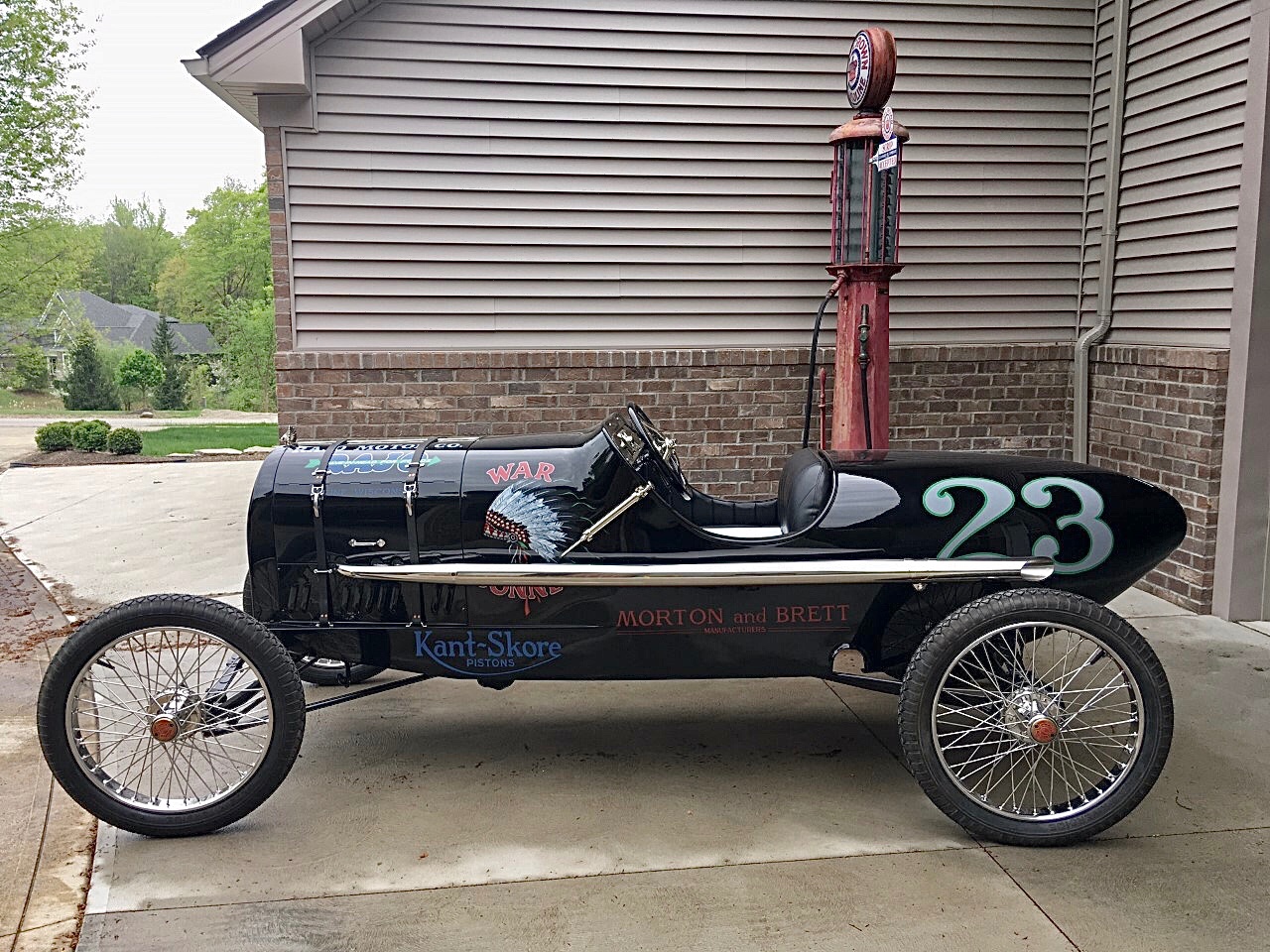

Wayne, I originally built this car to fill a need I had.
But that use has changed. And with the first car having a 5” stretched wheelbase, the car to replace it, also needed the 5” stretch. So that is how this car came into being. I used two frames and put the 5” in front of the firewall because I didn’t want to alter the drive train. So a 5” longer hood was a simple fix.
Warwick, you can see I already have one done to that style.
Ed, I remember seeing the picture of the dark blue car and thinking “What a beautiful car!”. I have not seen the red one before.
Mack, before I learned anything about cars, my father taught me how to push a broom sweeping out his body shop. He would always say to me “If you want clean work, keep a clean shop! Must a heard that a thousand times.

OK what about a bustle tailed speedster. Oh i sure like the way WE built the War Chief what a beauty cheers Warwick.

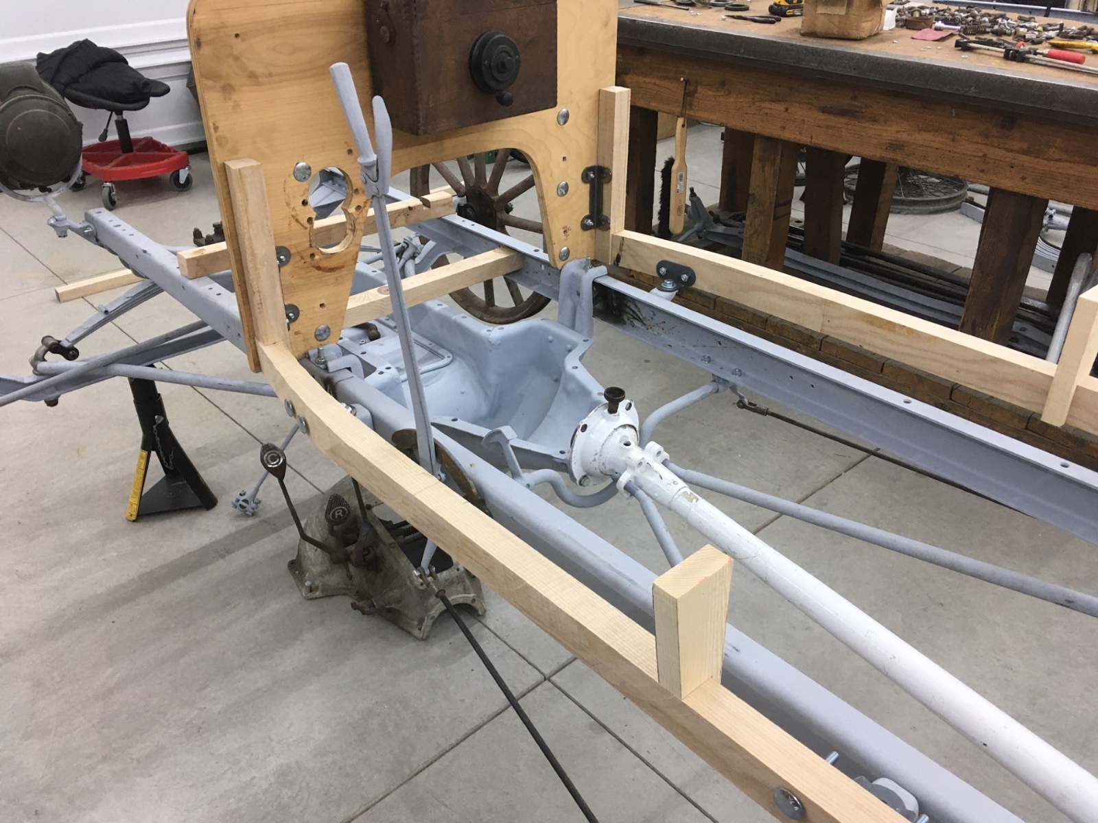

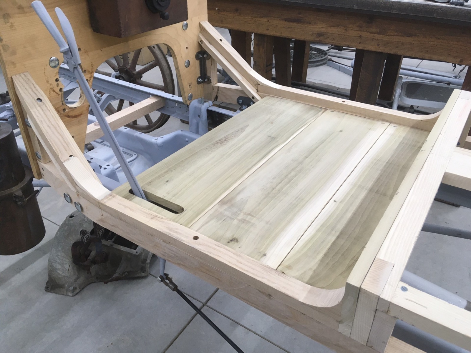

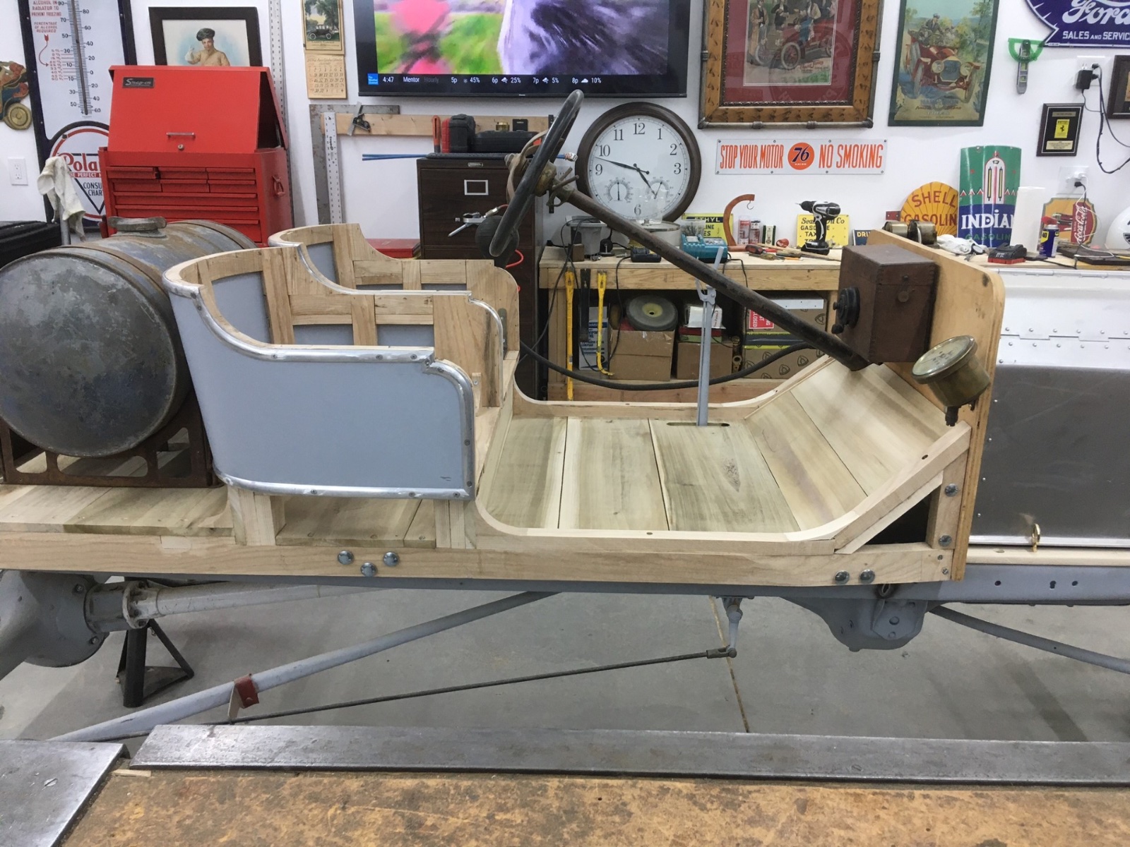

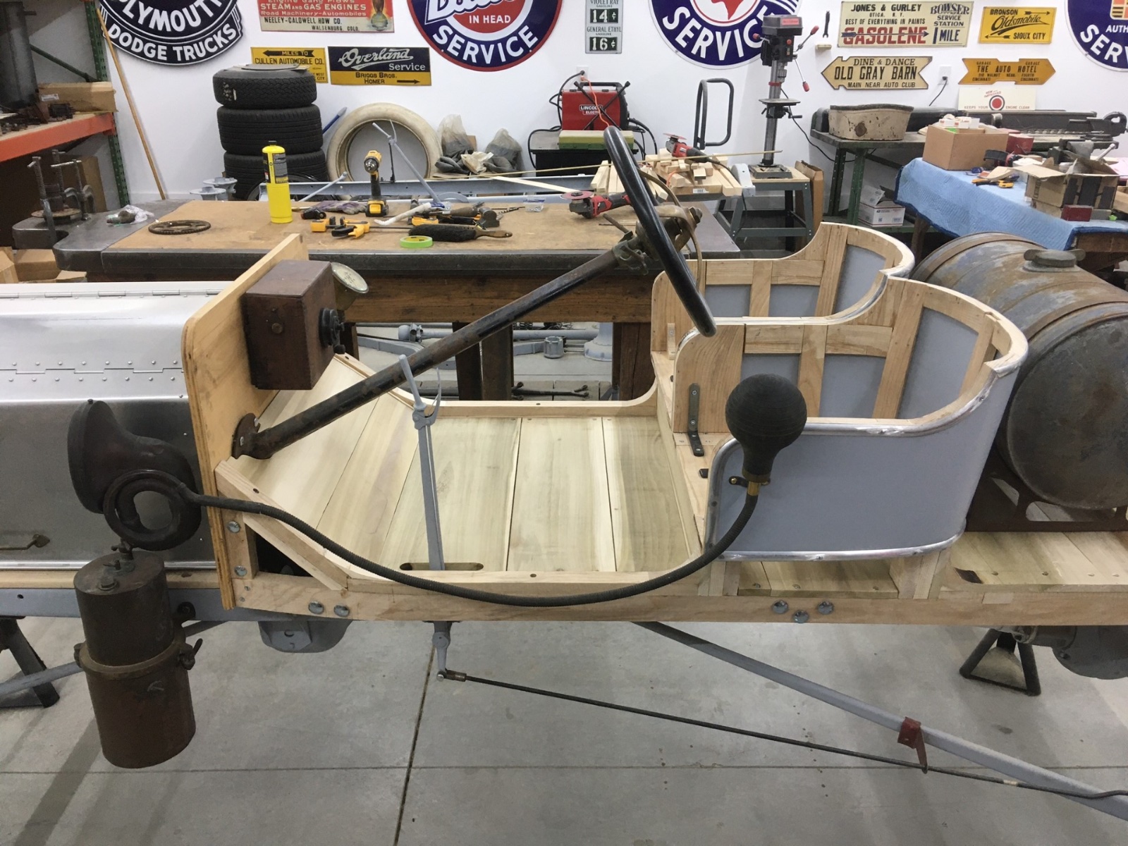

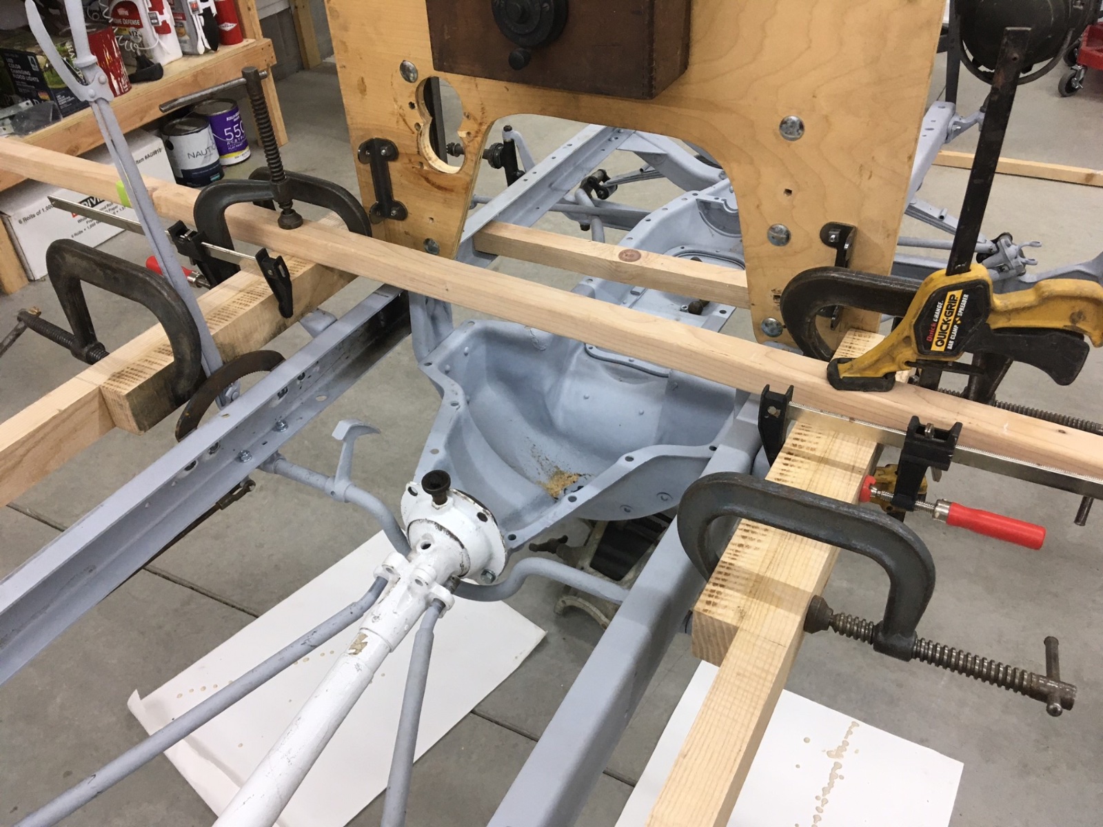

Post by Dollisdad » Thu Jan 11, 2024 12:47 am

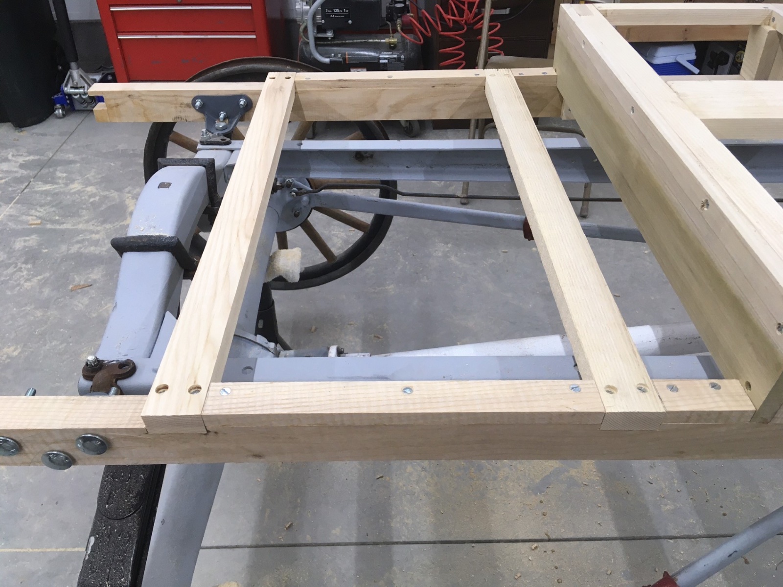

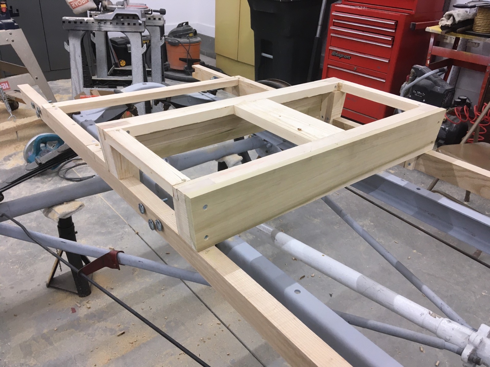

I decided to go along these lines.

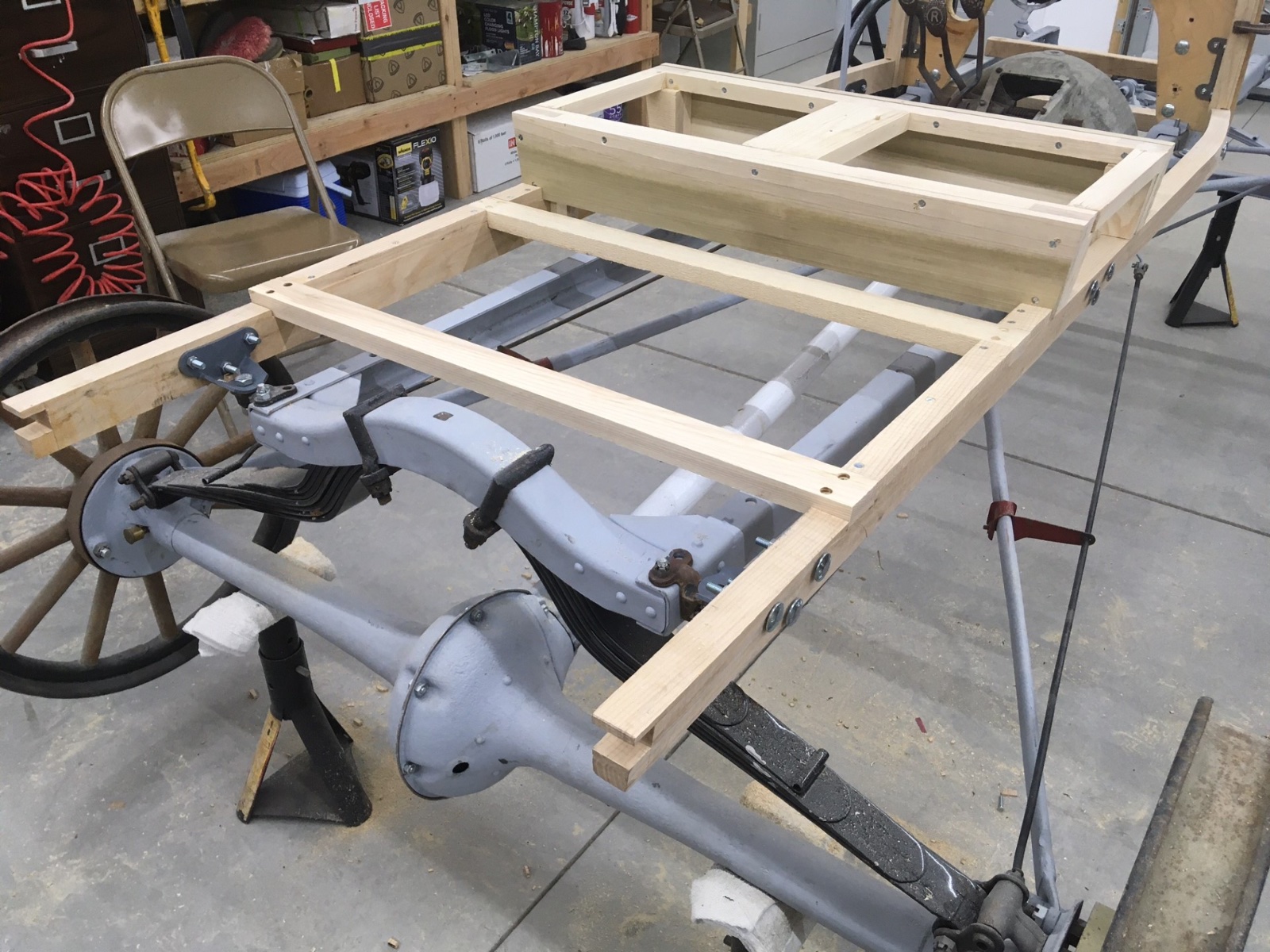

So I ripped a pair of stringers 2 1/4 x 1 1/2.
Glued in pieces to reach the body to firewall brackets.
Cut curve in front and drill body mounts.
Posts: 3875
Re: You tell me
Post by Dollisdad » Thu Jan 11, 2024 12:56 am
Look at mock-up positions.
Start seat riser after cutting 7 degree taper along outside of stringers and riser.
Posts: 4415
Re: You tell me
Post by Wayne Sheldon » Thu Jan 11, 2024 2:16 am
Looks like you are heading in a good direction! Even if you hide a stock engine under that long hood, it would be a great speedster and a lot of fun!
It is a personal thing with me. I like to see earlier engines in early looking speedsters. And I tend to prefer them kept closer to their apparent era. But that is silly me.
But it is your car! Do what makes it most enjoyable to you.

Posts: 3875
Re: You tell me

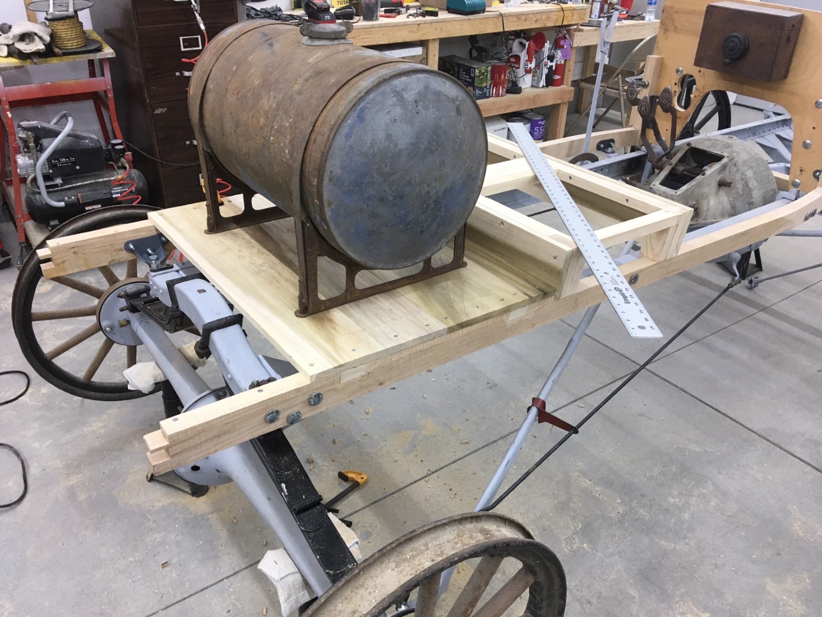

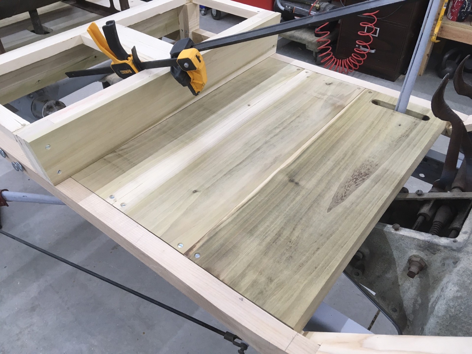

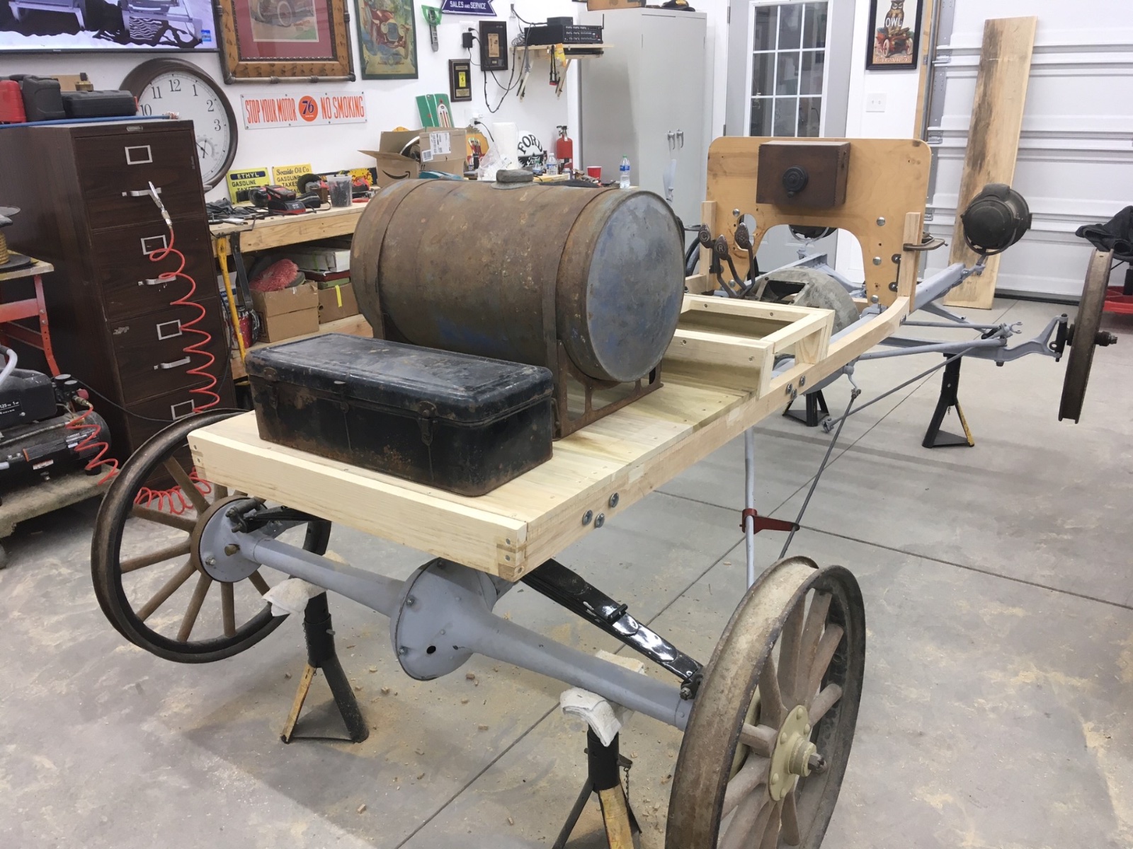

Post by Dollisdad » Sat Jan 13, 2024 11:14 pm
Set the supports for the gas tank.
And closed the ends of the seat riser.
Start to put floor on rear deck.
Posts: 3875
Re: You tell me
Post by Dollisdad » Sat Jan 13, 2024 11:23 pm
Drill mounts for gas tank.
Finish deck and end cap.
Drill mounts for tool box.
Posts: 3875
Re: You tell me
Post by Dollisdad » Sat Jan 13, 2024 11:25 pm
I think it’s getting there.

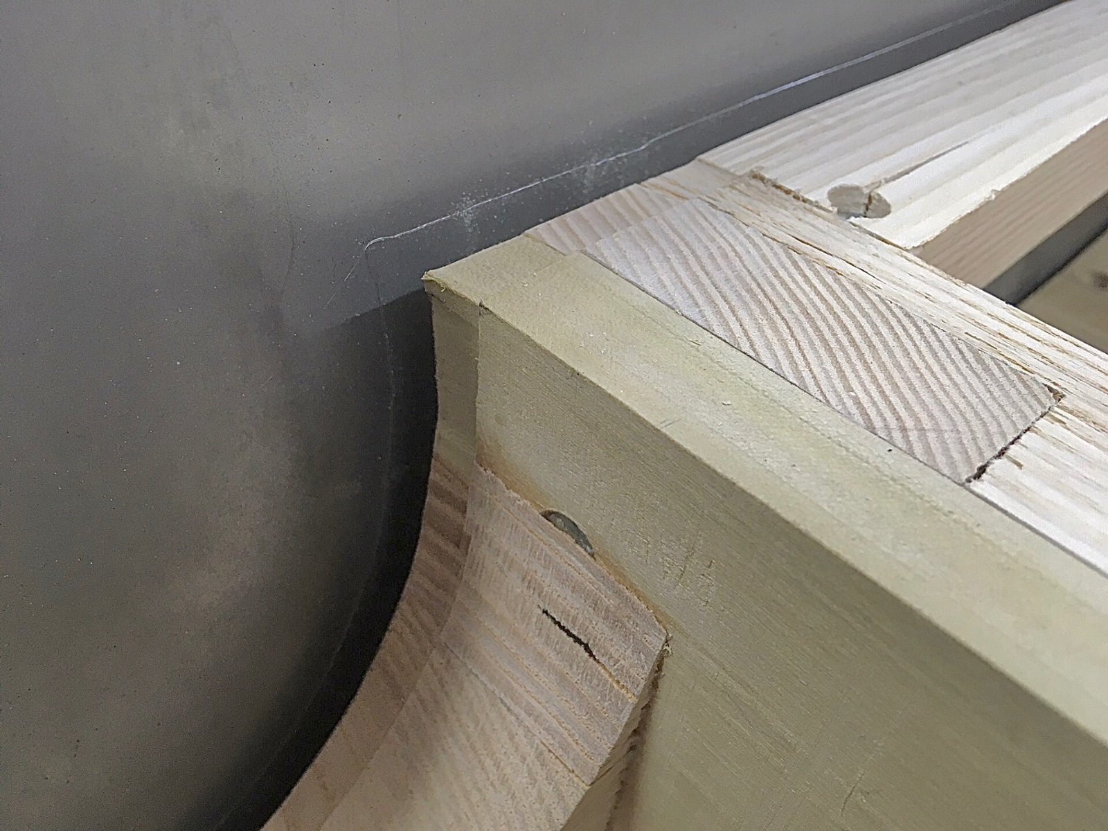

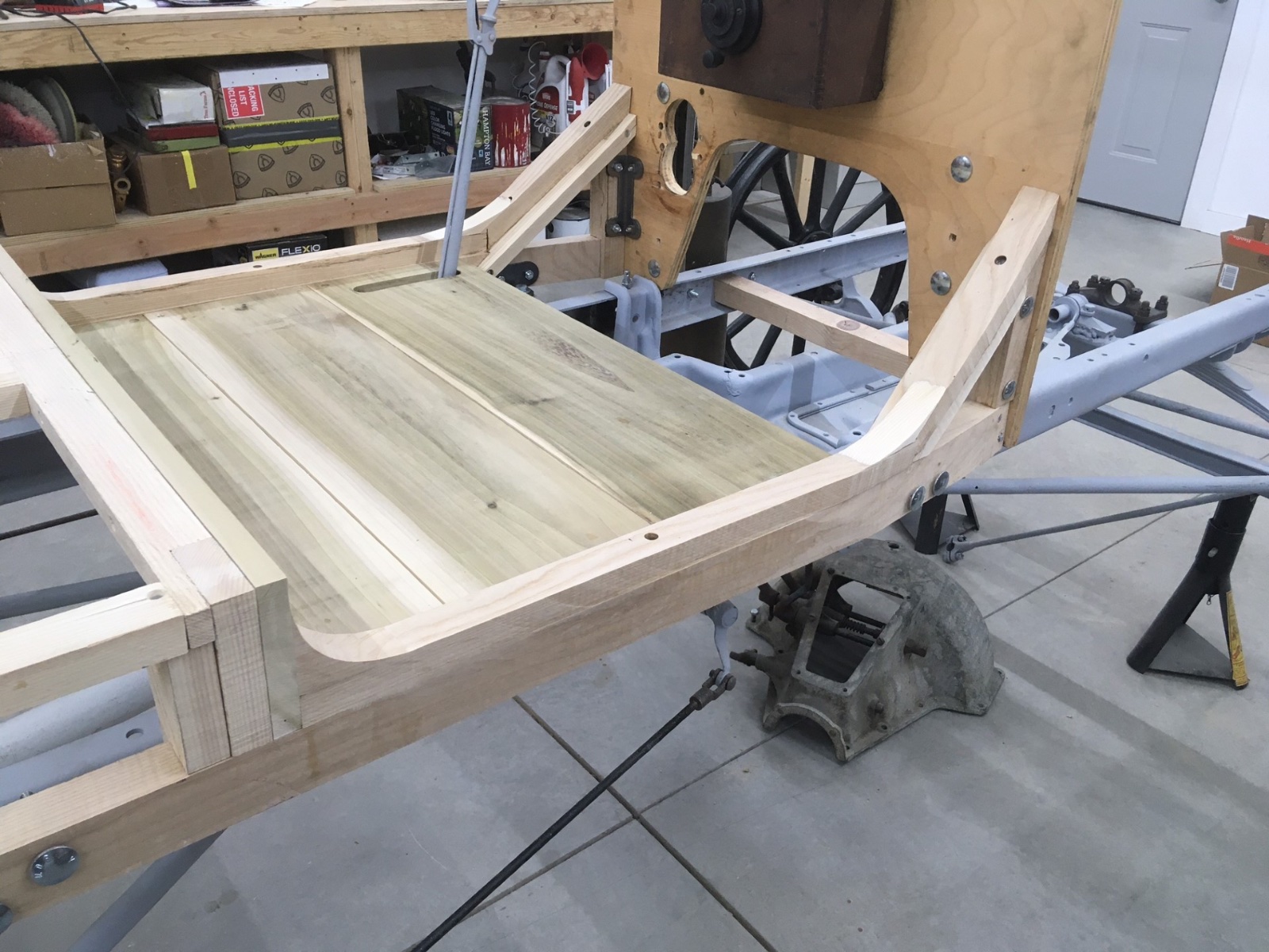

Posts: 3875
Re: You tell me
Post by Dollisdad » Sat Jan 20, 2024 1:44 am
Set the floorboards.
Set the risers.
Set the sill caps.
Posts: 3875
Re: You tell me
Post by Dollisdad » Sat Jan 20, 2024 1:56 am
Set the corners.
And forward sweepers
A little clean up,
Posts: 3875
Re: You tell me
Post by Dollisdad » Sat Jan 20, 2024 2:10 am
and I’ll make the upright floorboards when I get the pedals reshaped.
All the framework is Ash and the deck,floorboards,heel and back panel are poplar.
Posts: 3875
Re: You tell me

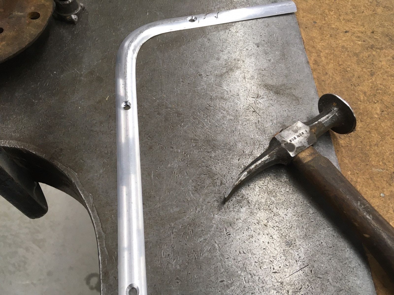

Post by Dollisdad » Tue Jan 30, 2024 11:43 am
Floor and hood sills done.
Now I need to find someone with a 8’ brake so I can start to skin the deck. In the meantime I’ll start to build the frame works for the seats.

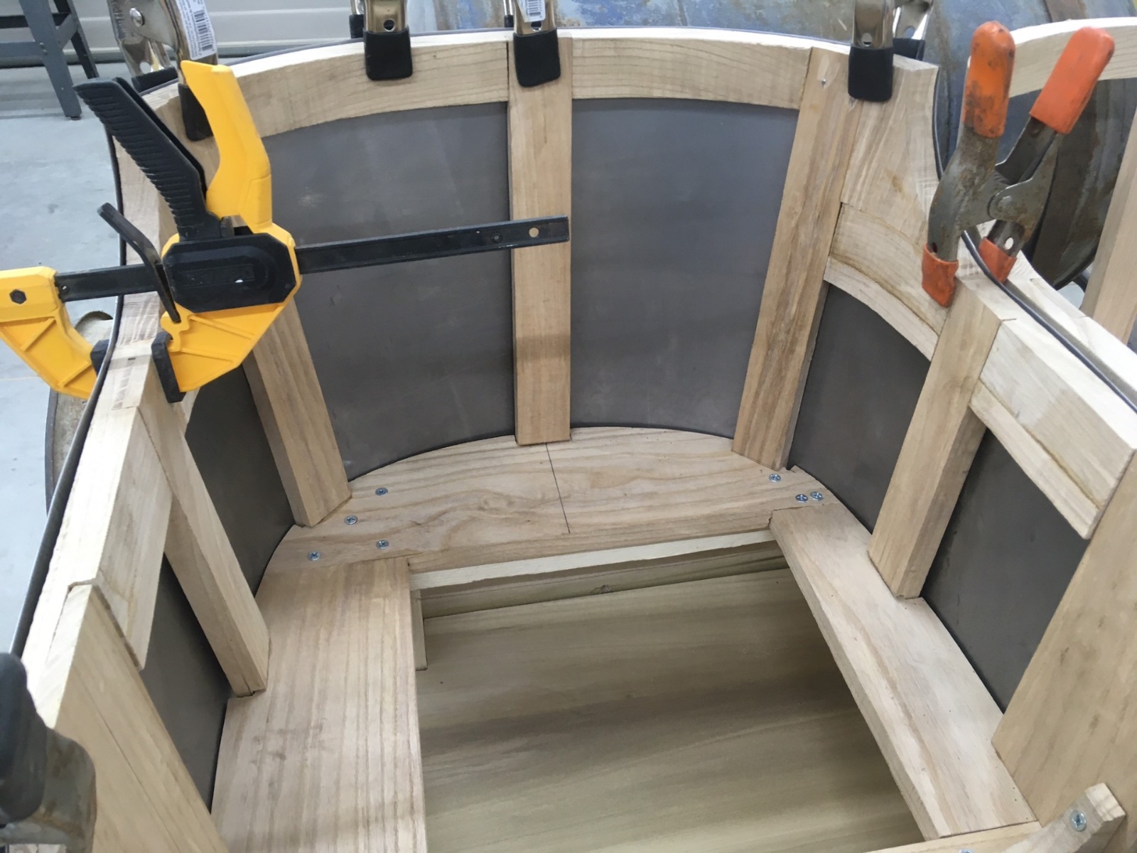

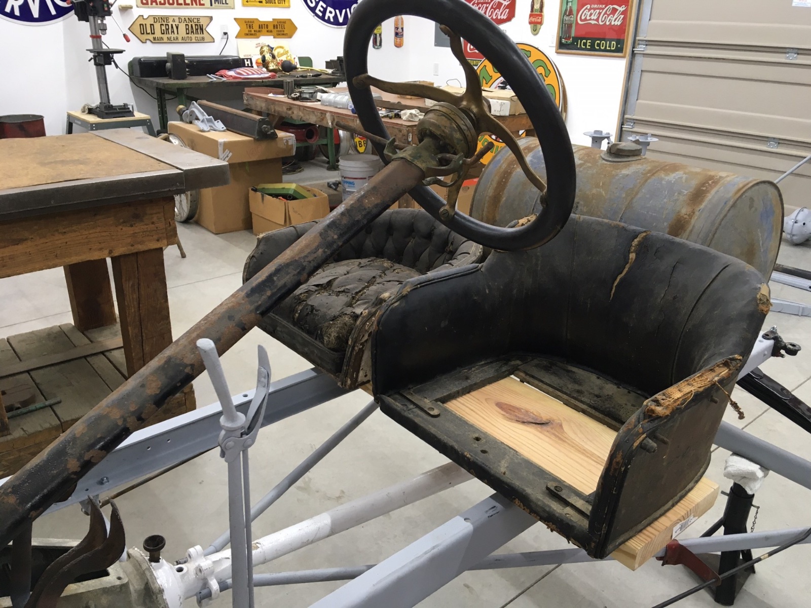

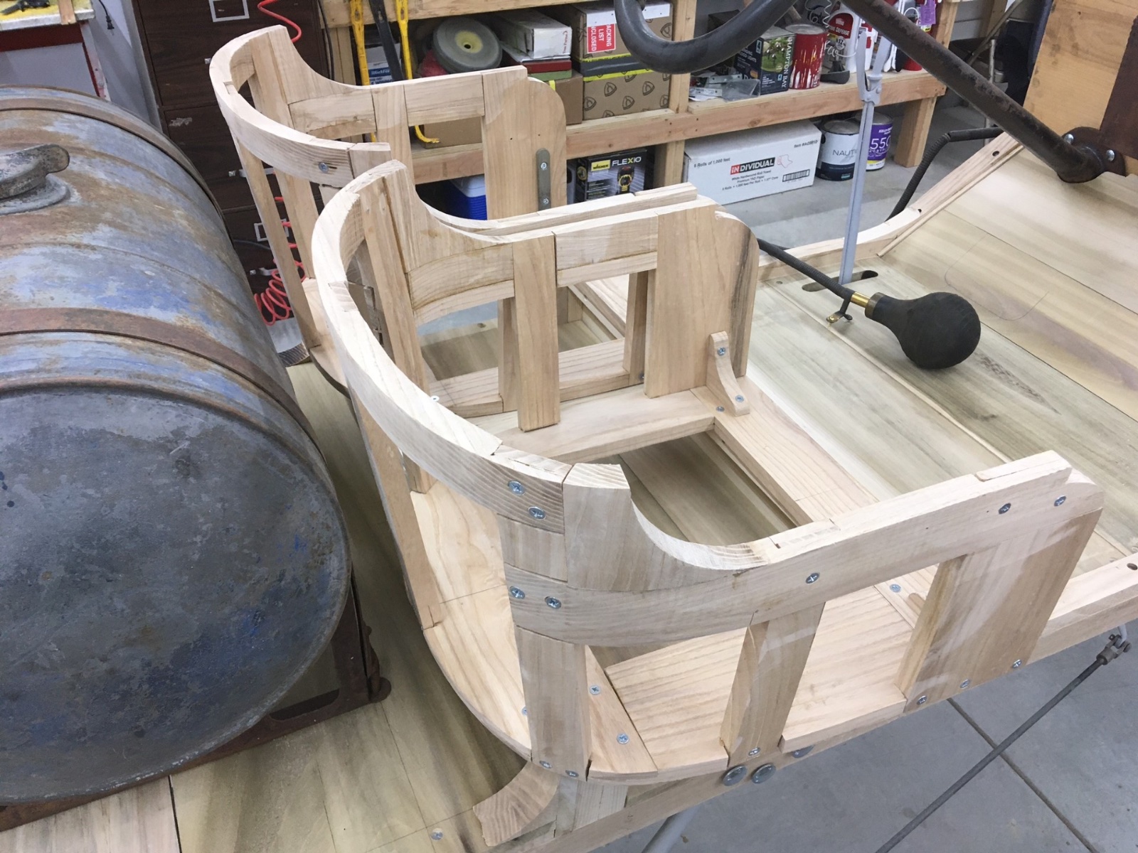

Post by Dollisdad » Thu Feb 08, 2024 6:33 pm

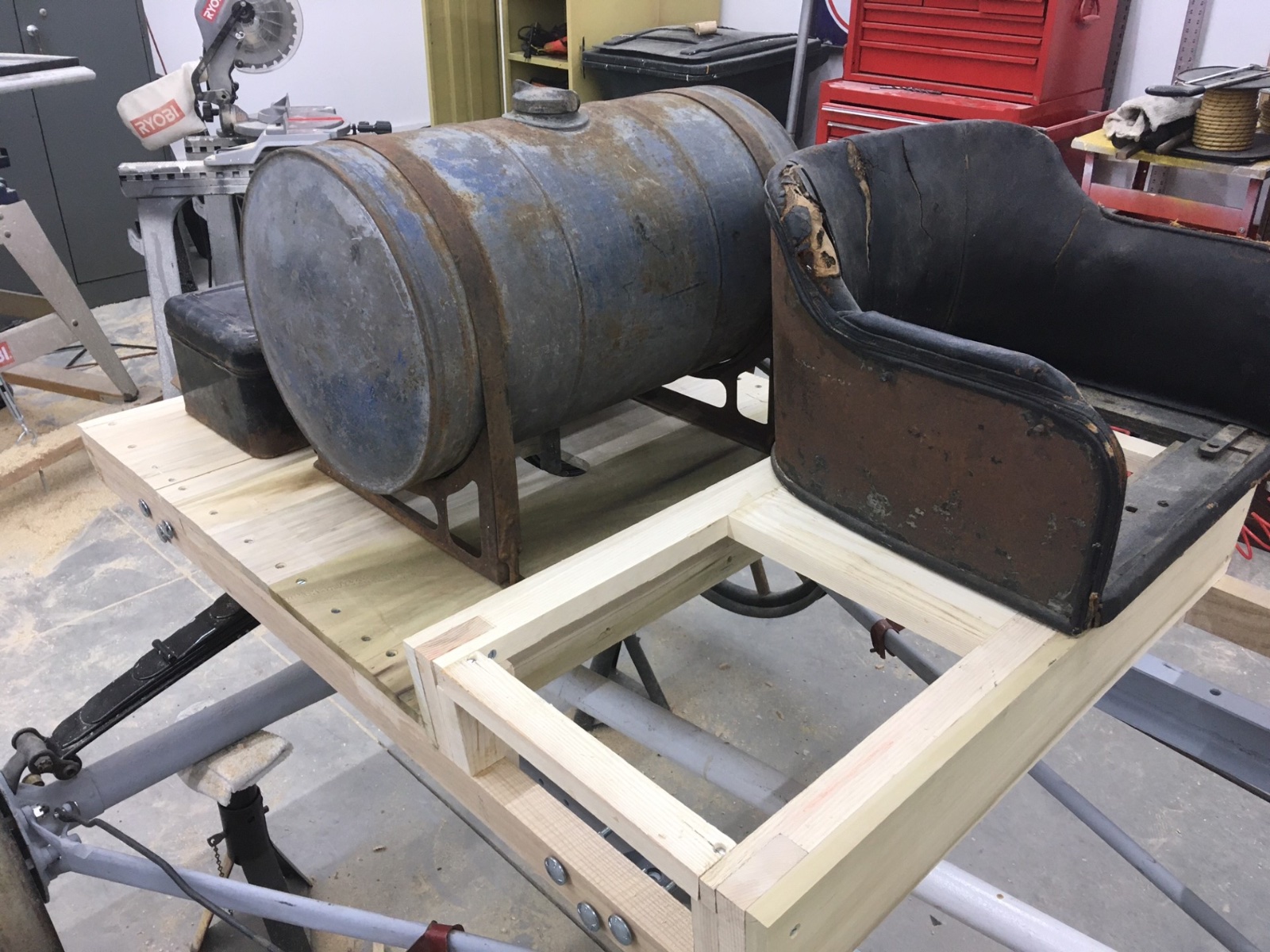

Making progress on seats

Post by Tbird » Fri Feb 09, 2024 12:38 am
Great progress Tom! It's coming together. Love the frame mounted carbide generator!

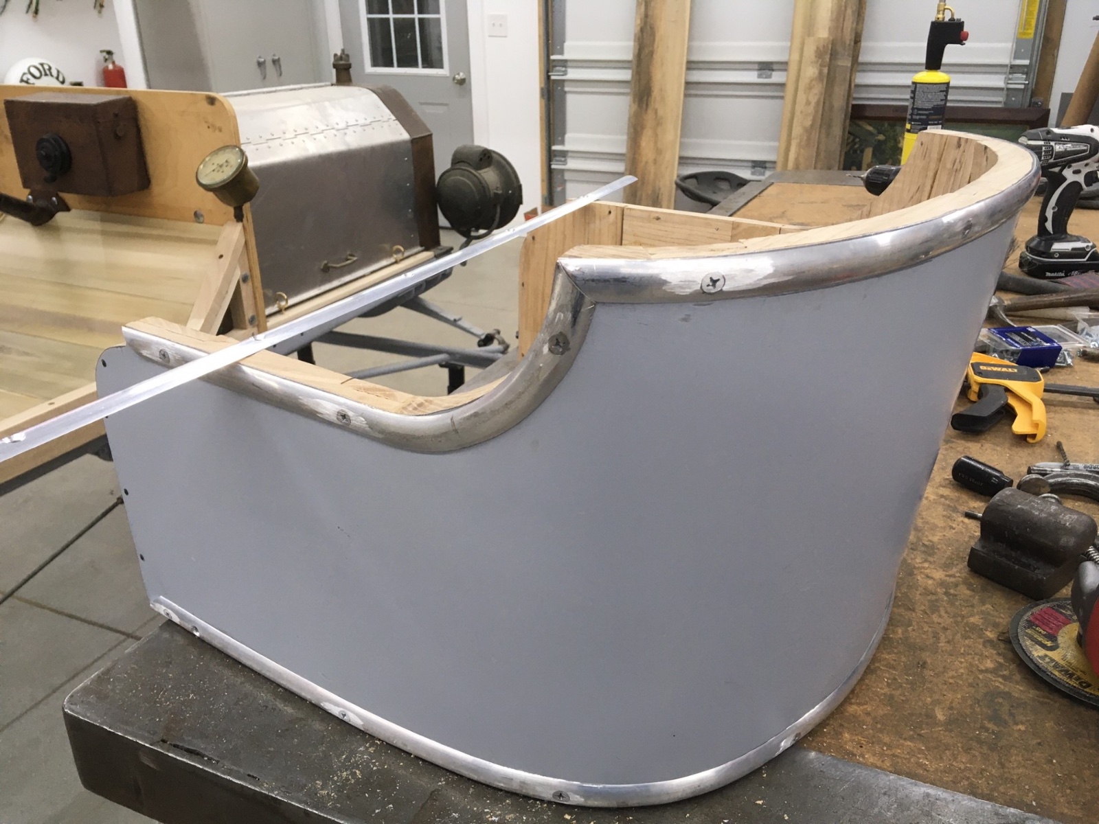

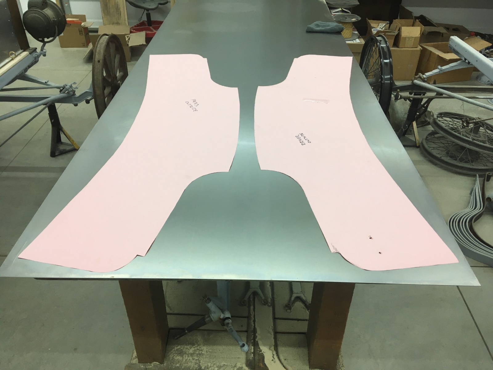

Posts: 3875

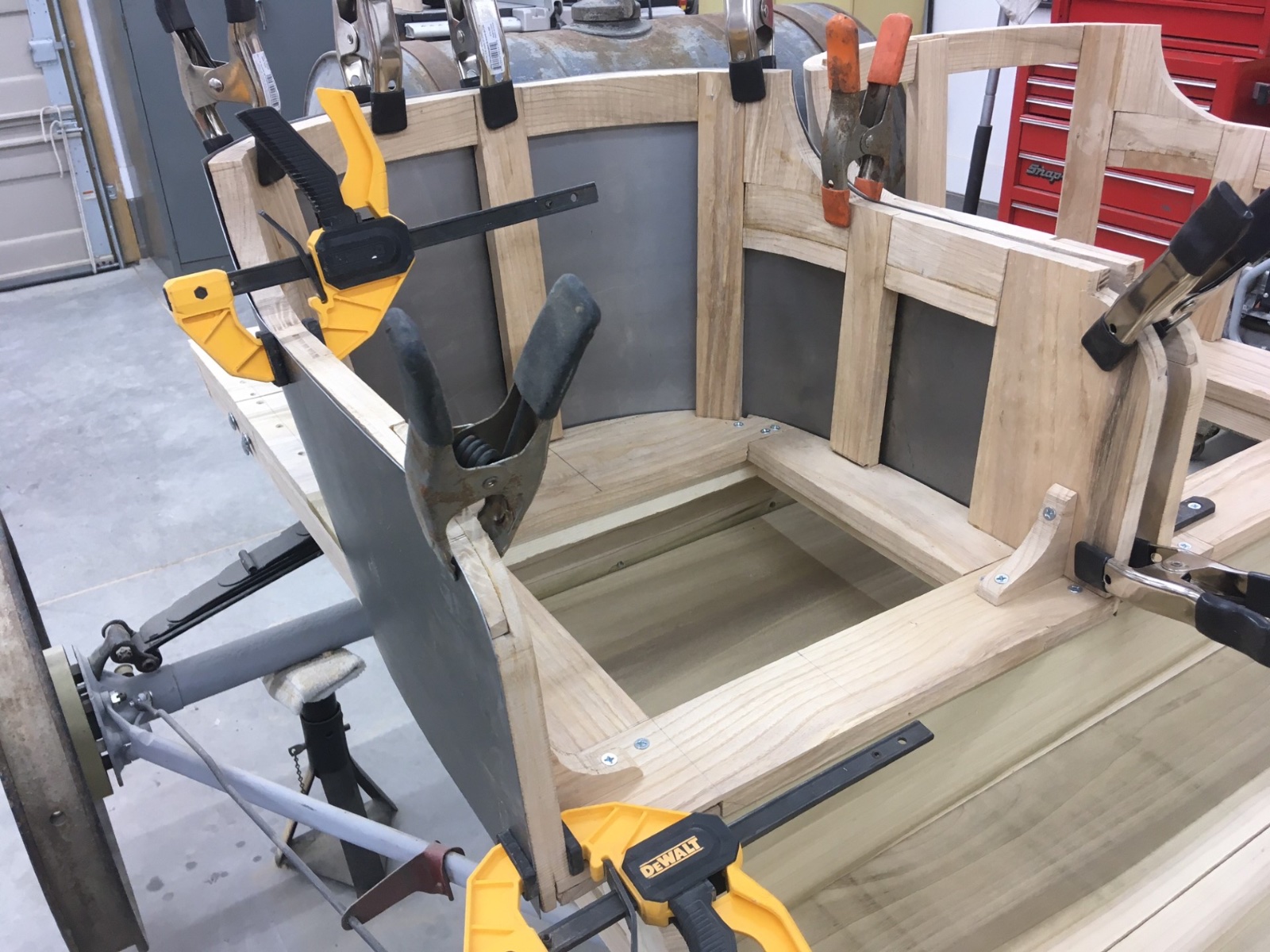

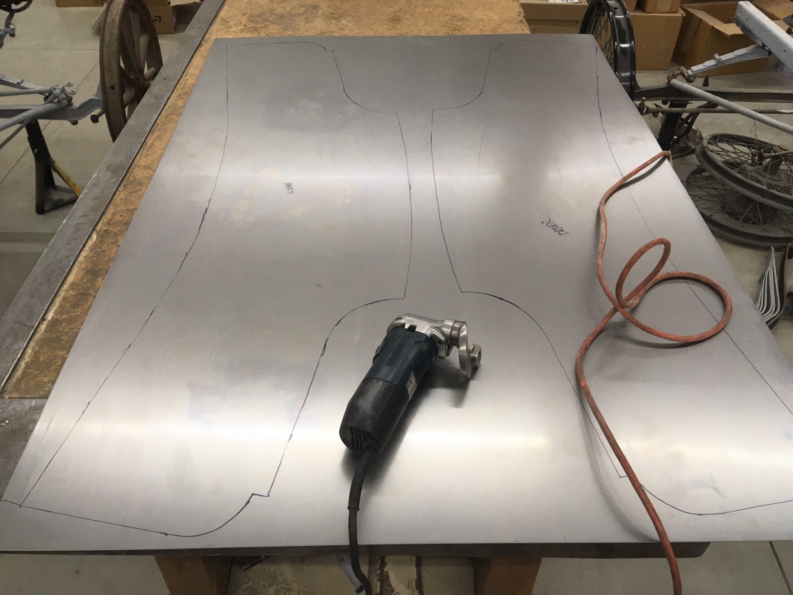

Re: You tell me

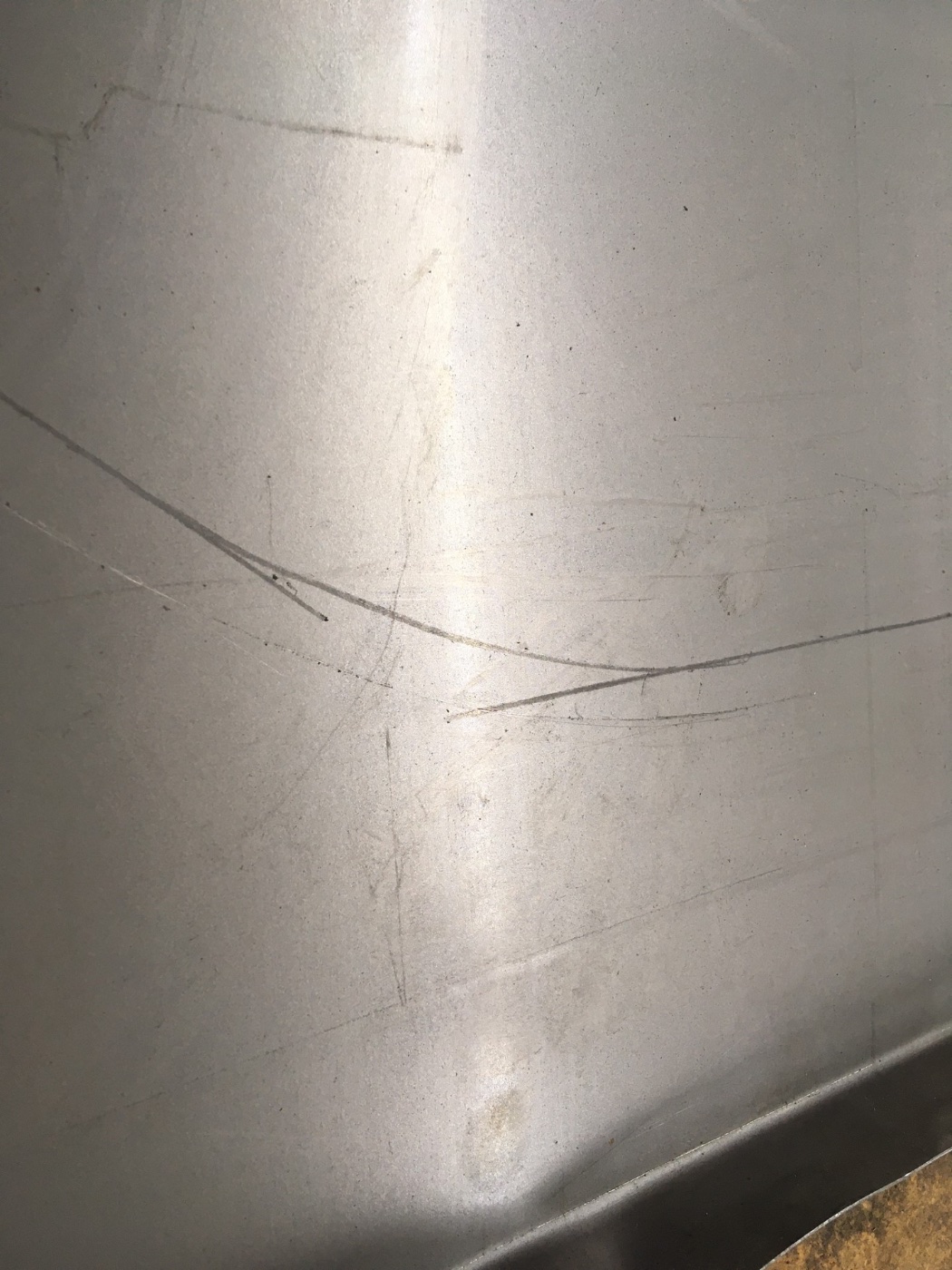

Post by Dollisdad » Wed Feb 21, 2024 6:55 pm
Seat frames done

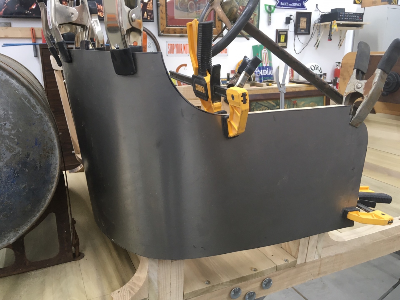

Pulled patterns and transferred to sheet
Cut out skins adding 1/16” to allow for misalignment on my part,

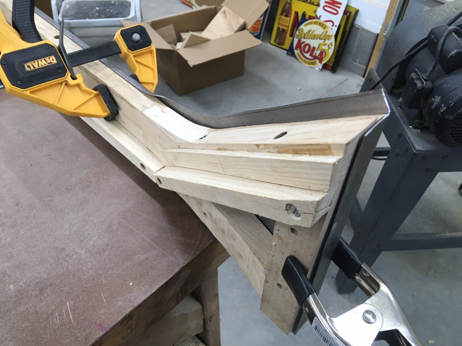

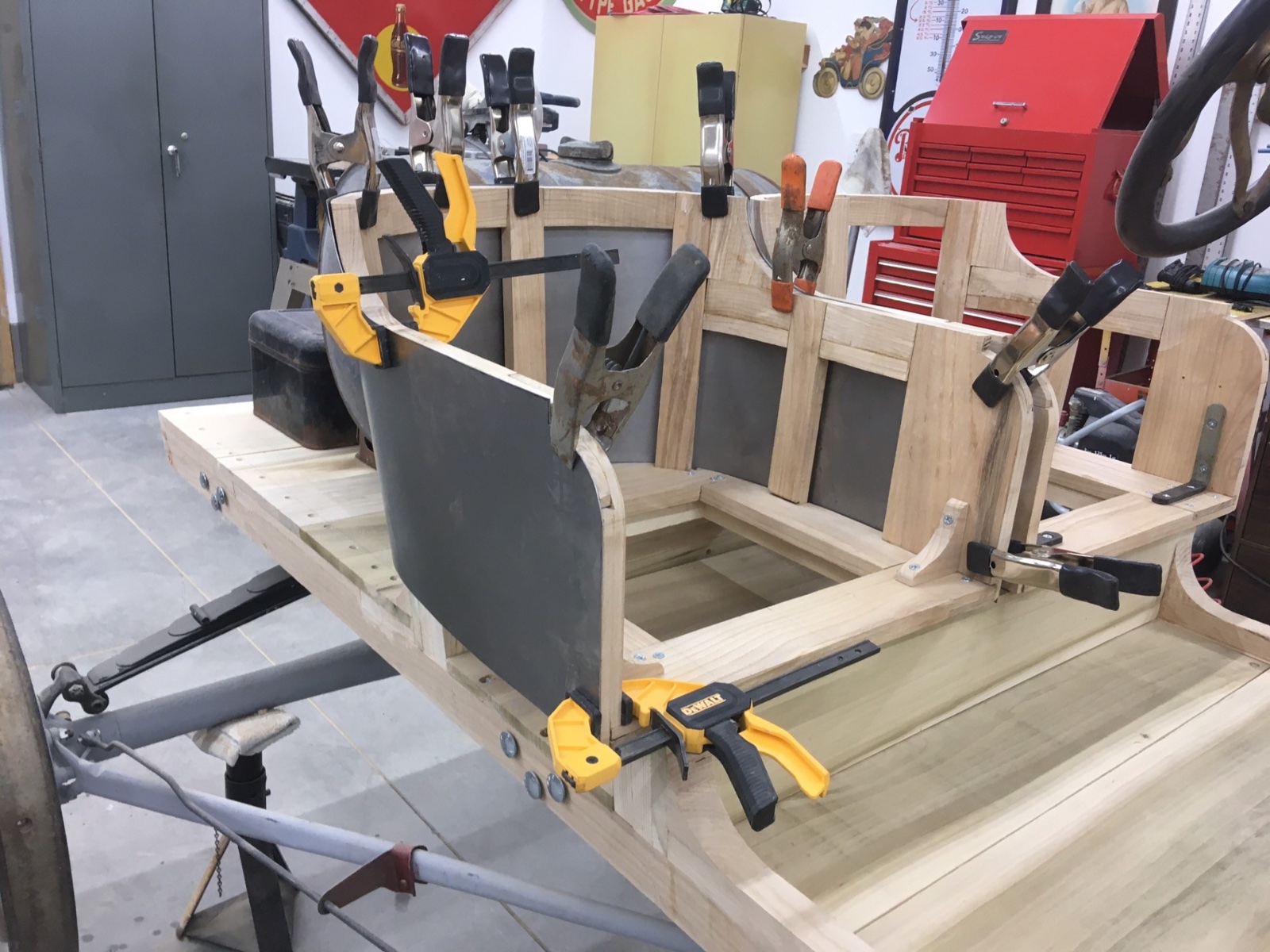

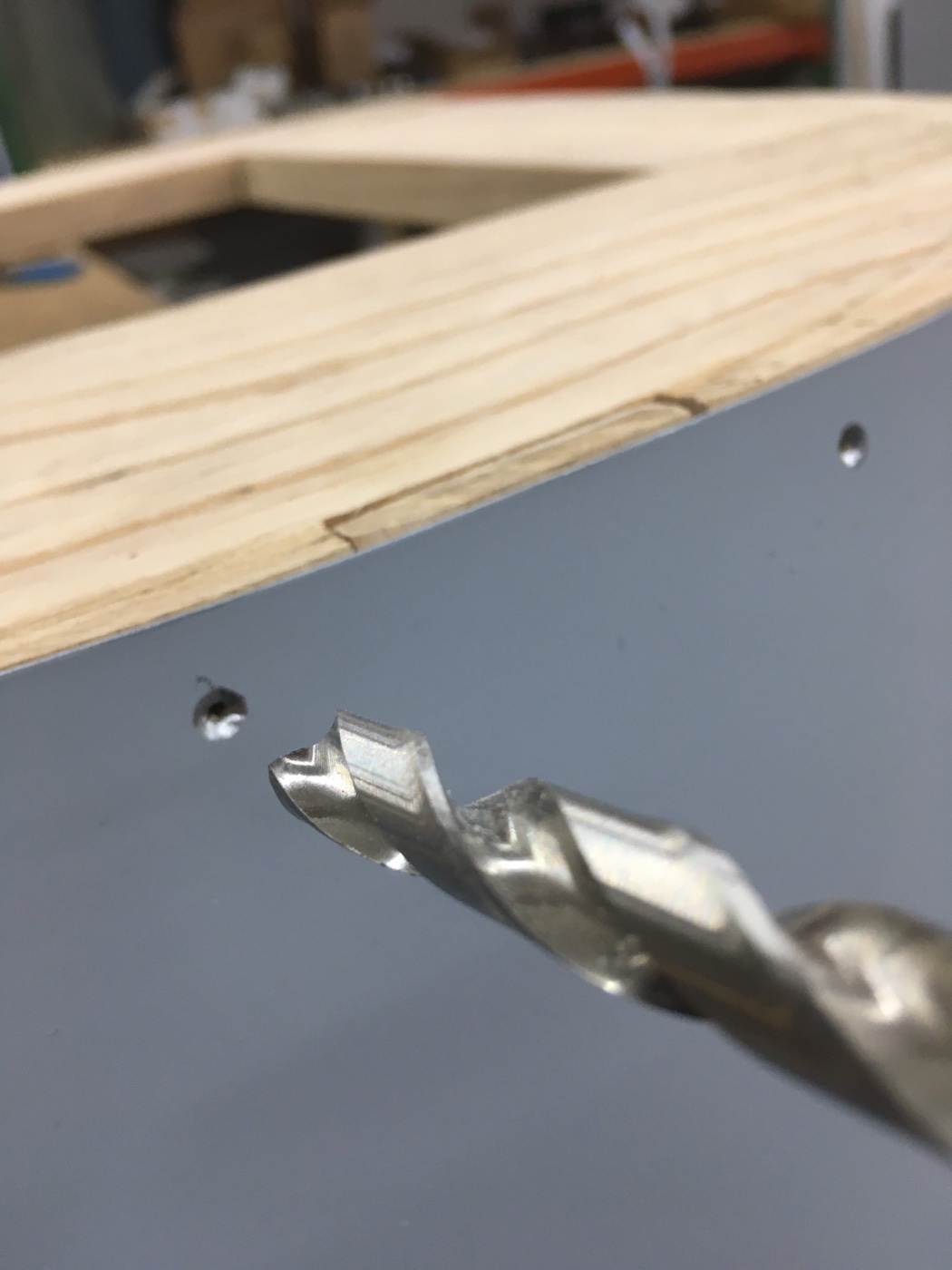

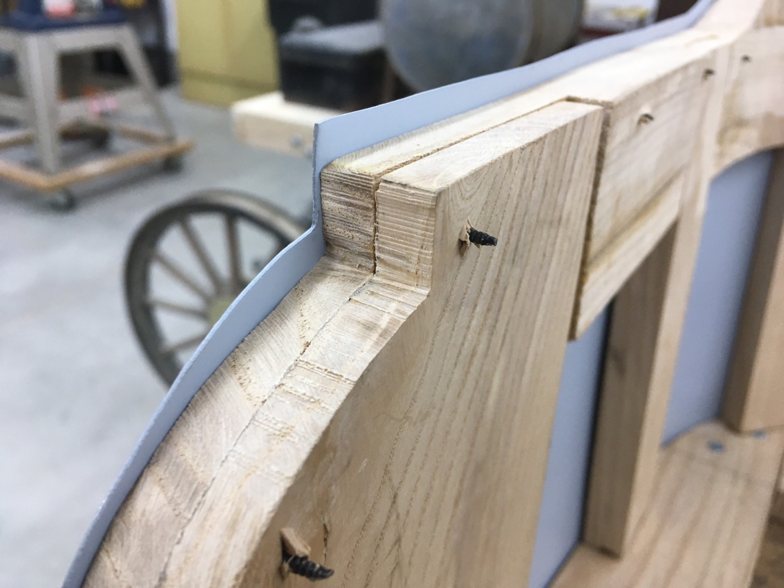

Posts: 3875
Re: You tell me
Post by Dollisdad » Wed Feb 21, 2024 7:01 pm

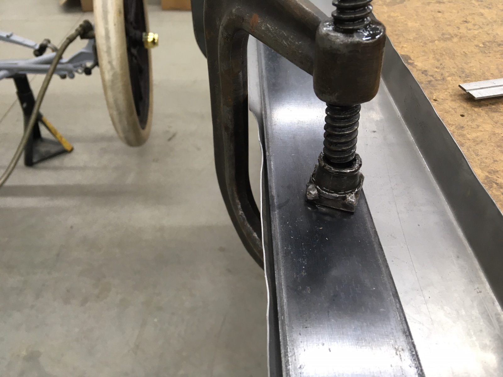

Clamped skin to the frame on one end and pulled it around and clamped as it made contact. Pretty happy with the trial fit. Material is 20 ga. cr.

Post by Joe Bell » Wed Feb 21, 2024 9:50 pm
Looks better than the last time i saw it! Nice work on the sheetmetal, who did it? just joking!

Beautiful woodwork. Poplar?
Posts: 3875
Re: You tell me
Post by Dollisdad » Thu Feb 22, 2024 11:50 am
Jim, all the floorboards are poplar. The deck and seat skeletons are ash. Here in Ohio, on Facebook marketplace there are quite a few people who process and sell rough cut lumber off their own land or others. So I’ve been buying 6/4, 5/4, and 4/4 rough material, so I can plane it to my needs. Ash is getting harder to find due to the Emerald ash borer which has destroyed millions of ash trees. You can buy green if you have the time to air dry and save money. Otherwise kiln or aged works best.
Posts: 3875
Re: You tell me
Post by Dollisdad » Thu Feb 29, 2024 8:20 pm
So here’s what I use to treat the sheetmetal, to seal the sheetmetal, to nail the skin to the frame and screw the moldings on.
Here’s the skins drying.
Posts: 3875
Re: You tell me
Post by Dollisdad » Thu Feb 29, 2024 8:42 pm
I drill two holes at the center bottom and countersink them to better sink the nail heads. Then center the skin best I can and proceed to nail the skin on.
The left side came out pretty good.
The right side not so good. My misalignment.
So I had to grind the sheetmetal down to the wood. That’s why I oversize the skin.
Posts: 3875
Re: You tell me
Post by Dollisdad » Thu Feb 29, 2024 9:05 pm

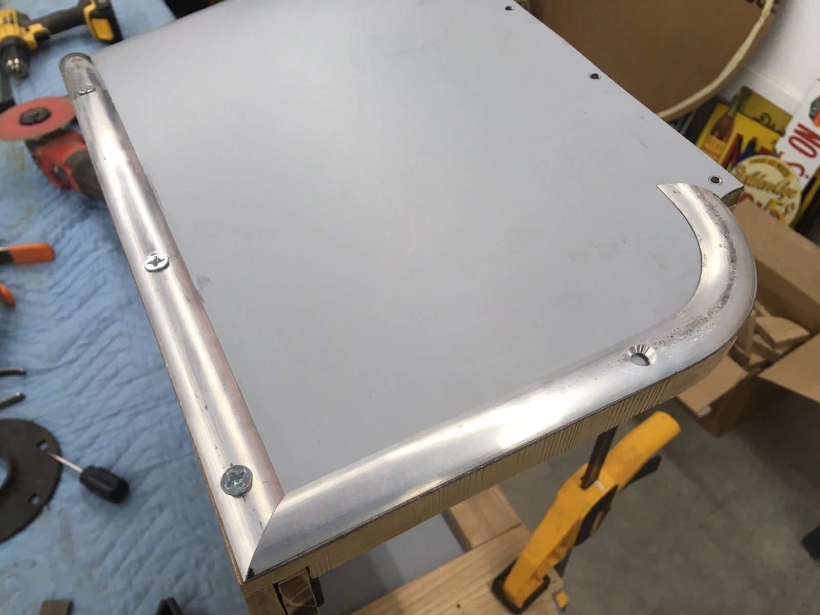

Then I put the moulding around the bottom after I anneal the rear portion of the moulding.
And around the top.
Then form the front corners around a front wheel hub.
Takes around 4-5 times annealing to get it to form. It will buckle and you have to tap it flat between annealings, but it comes out flat in the end.
Posts: 3875
Re: You tell me
Post by Dollisdad » Thu Feb 29, 2024 9:18 pm
And fits pretty good.
Then bent the up swings. I use the paper pattern I pulled for the skin as a template. I made a wood buck to bend them around as I could not find anything the right shape. You see where I have scribbled on the moulding with a sharpe. That is the area I want to anneal. So using a hand held torch I evenly heat that area until the markings disappear. Then it is ready to bend. Like I said it will take 4-5 times to complete the curve.
Posts: 3875
Re: You tell me
Post by Dollisdad » Thu Feb 29, 2024 9:36 pm
This is what I use to anneal.
Ready to cut the angle.
Almost done.
What was leftover from 24ft. of moulding.
Posts: 4415
Re: You tell me
Post by Wayne Sheldon » Thu Feb 29, 2024 9:37 pm
Beautiful workmanship! And nice tutorial.
Posts: 3875
Re: You tell me
Post by Dollisdad » Thu Feb 29, 2024 9:42 pm
I like the look it has. I ground off the nails that went thru and ground off the screw heads. Now I need to fill the heads and get them ready towards paint. I’m debating wether to try upholstery as I have never done that. We will see.
Rob

Post by Dollisdad » Thu Mar 21, 2024 8:55 pm
So back to work. Got the wheels painted(with a brush.
Then got the tires mounted.
So time to skin the body. I start by routing the edges where I want the sheet metal level with the wood.
Posts: 3875
Re: You tell me
Post by Dollisdad » Thu Mar 21, 2024 9:06 pm
Cut the blank for the side.
Since I don’t have a 8’ brake at home, I sandwich a 1” flange between two 3/16” strips and knock down with a rawhide hammer, checking to see it is approx. 7 degrees short of 90.
Then clamp it to the woodwork.
Next I scribe the edge of the woodwork.
Posts: 3875
Re: You tell me
Post by Dollisdad » Thu Mar 21, 2024 9:19 pm
Then I add 3/8” to the scribe lines.
I use an electric hand shear to cut out the part.
Using the strips I knock the straight stretches up with the rawhide and then straighten the edge with a steel face hammer and dollie.

I pie cut the bottom so it will sweep inward at the front and bend the end cap.
Next I test fit the panels on the skeleton.
Posts: 3875
Re: You tell me
Post by Dollisdad » Thu Mar 21, 2024 9:29 pm
Posts: 3875
Re: You tell me
Post by Dollisdad » Thu Mar 21, 2024 9:36 pm
Today I took these patterns down to my steel shop and they are going to plasma cut me some 3/16 plates so I can knock up the seat riser curves and the floorboard riser sweeps. I will also pickup a piece of pipe to shape the radius for the rear deck to seat riser. Little by little.

I had to bend aluminium moldings for my 1912 van and my 1925 wide body roadster, and used a wooden former like yours for each, but with a slight difference in technique. I cut the formers to the OUTSIDE diameter of the curve needed. Then I used my table saw to cut a grove around the curve. The cut was set to the depth of the molding width. I had to do two cuts side by side to get the groove as wide as the molding was thick.
I did not have to anneal my 1/2" wide molding. Within the confines of the groove, it had nowhere to go in the third dimension, so I could just pull it around by hand. Others may find this helpful.

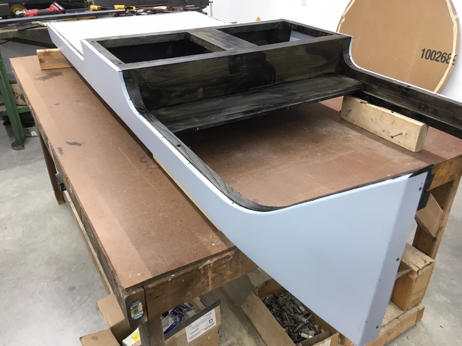

Then acid treat and prime the panels.
I routed the rear corners and inserted small corner shields to back up when I weld the corners shut.
Then start to nail panels on starting with the bottom.

When I put the rear deck top piece on I shoot some liquid nails under it to kill any noise that may arise from rpm vibration
ThenI bolt the tank down to press the skin to the framework. I will leave this now fora few days to make sure the bond has cured.
