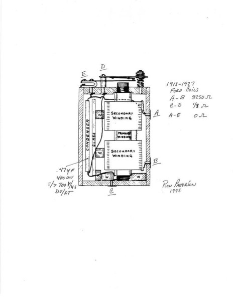

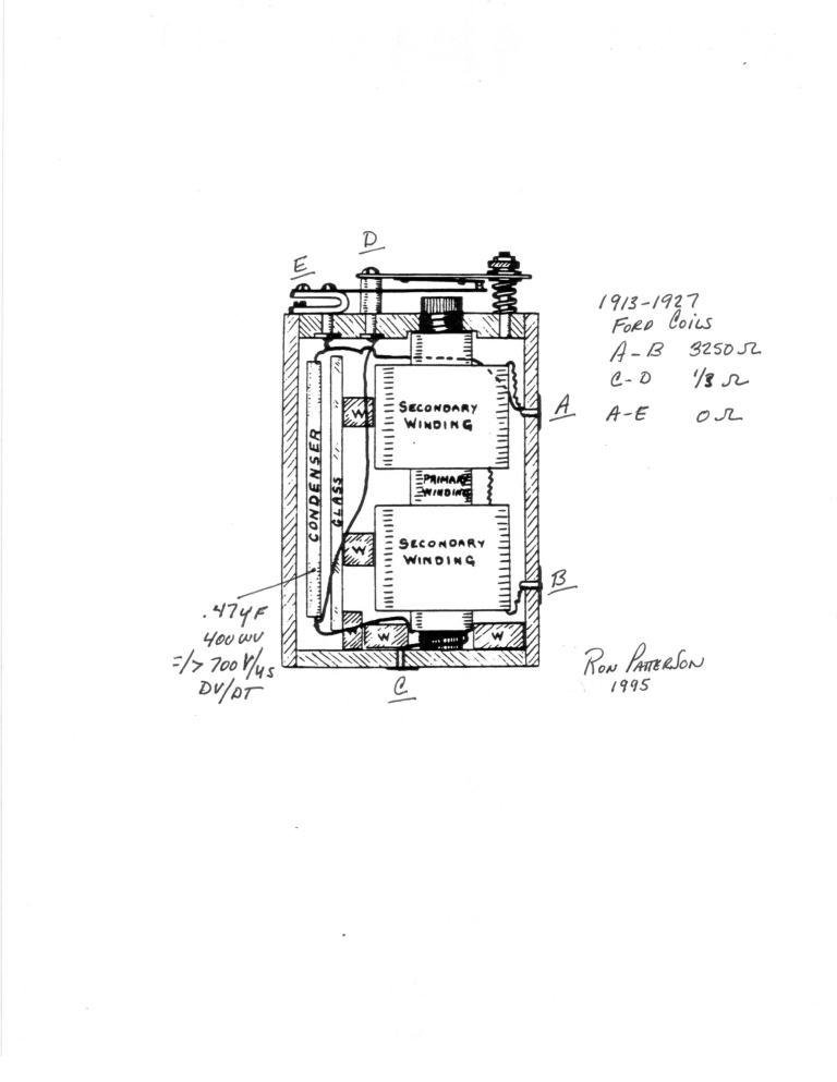

This assumes you have the 418P47494 type capacitors and a Ford manufactured coil.
There are two ways to install them: one is to remove the glass separator to make room for the cacpacitor OR; if you prefer, remove the glass separator AND the two wooden blocks between the glass separator and the secondary winding, after installing the capacitor reinstall the glass sedparator in the area previously occupied by the wood blocks.
Regardless which way you go, always repot the coil with tar to firmly hold the new internal parts/wiring from moving.
