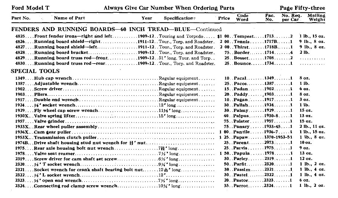

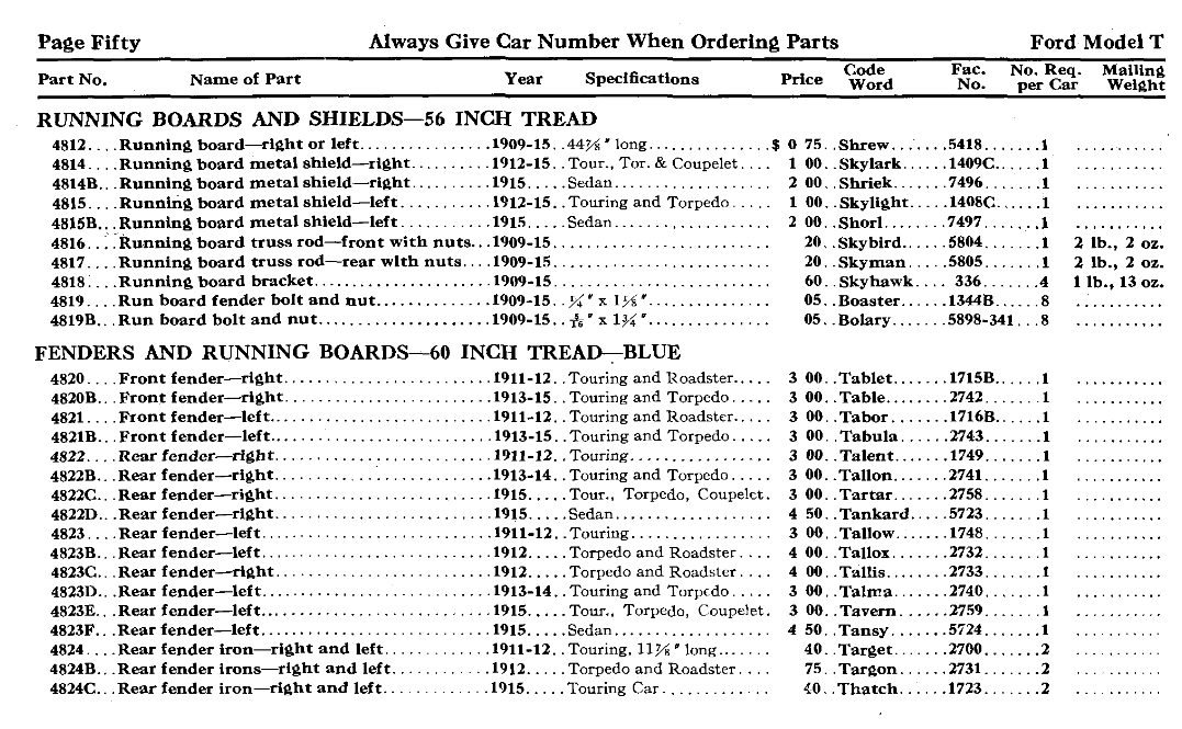

I checked the 1920 parts book and found that the rear fender irons are the same from 1913 through 1920 and both the coupe and the roadster used the same iron. When I measured from the top of the front and rear fender irons I get the measurement of front 34 1/4 inch and rear 37 3/8 inch. from the floor to the top of the fender irons. That means that the rear fender sits 3 inch higher than the front fender, Is this what it is supposed to be? I have wire wheels both front and rear are 30x3 1/2 but that should only make a difference of 1/2 inch.. I don't have access to a 14 roadster to check to see if both fenders are the same height from the ground. The same parts book lists the front fender iron Right or Left from 1909 to 1920. Before I started the restoration I checked the frame to be sure it was straight, and it is.
