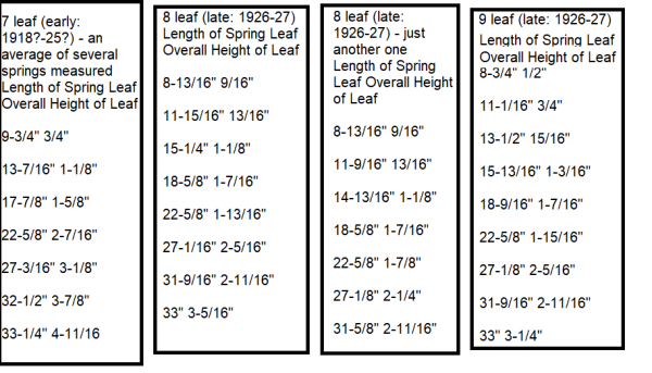

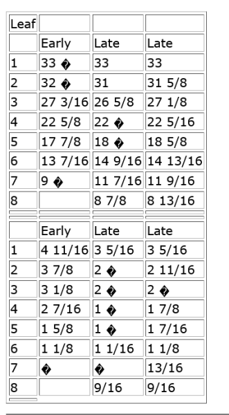

All I have is some data collected from previous discussions. It should be possible to measure the height with a main leaf by compressing its eyelet ends to the correct length (whatever that is for sure). There is agreement on the data for a height of 4-11/16" for lengthsCraig E. Luton wrote: ↑Fri Apr 19, 2024 10:53 pmDoes anyone know the amount of arc the front taper leaf spring had from the factory? Thank you... Craig

I have a 1926 copy of an Australian spring maker setting chart which gives the measurement for a Model T Ford car front 7 leaf spring between bushing centre's as 31- 5/16 to 1/2 inch.

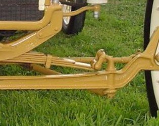

Sorry if I sound dumb but what should be the distance of the main leaf on a 7 leaf spring. Eye to Eye.
Also should that measurement be taken when it is assembled with all springs attached or by itself. On the floor or on the shackles.
Would a spring that is too long only get longer when compressed and rest on the axle if long enough and bang on bumps.
Look at this reverse eye spring. This looks like any bump in the road is going to result in the spring hitting the perch and not having much spring at all. I would think that an assembled spring attached and under weight should have the shackle at about 8 O'clock.

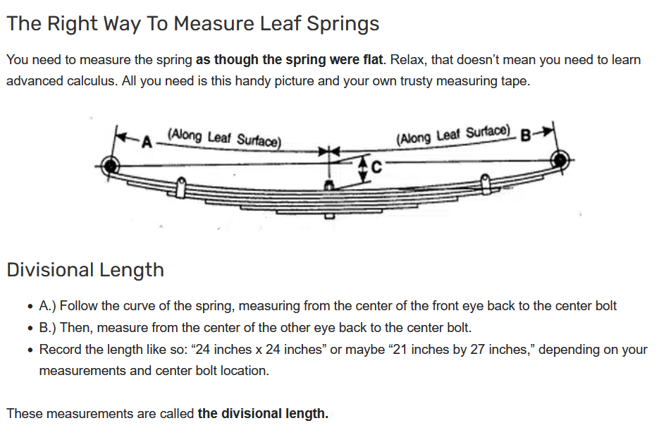

Leaf springs specifications are measured independently, unattached to anything, eye to eye. Several sources indicate the main for the 7 leaf is 33-1/4". Measuring leaves clamped together or under load would give a different reading.
https://mtfca.com/phpBB3/viewtopic.php?t=14560
viewtopic.php?f=2&t=2803
The method to measure an assembled used spring is different when ordering an assembled one
https://www.eatondetroitspring.com/how- ... f-springs/

The eye-to-eye dimension was given above, by "Luxford". My assumption is that it would be taken on an assembled spring in the free state, (meaning not installed on the car).skyhunter wrote: ↑Wed Oct 15, 2025 12:18 amSorry if I sound dumb but what should be the distance of the main leaf on a 7 leaf spring. Eye to Eye.
Your spring shackle position looks perfectly normal.
