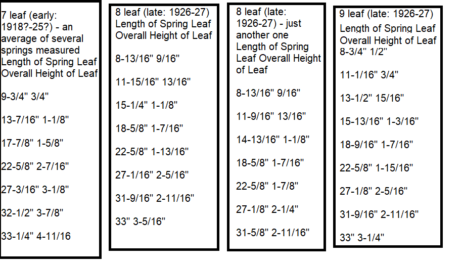

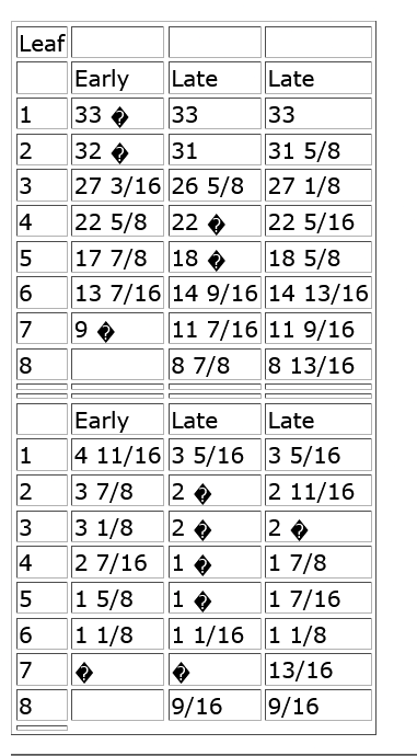

All I have is some data collected from previous discussions. It should be possible to measure the height with a main leaf by compressing its eyelet ends to the correct length (whatever that is for sure). There is agreement on the data for a height of 4-11/16" for lengths

I have a 1926 copy of an Australian spring maker setting chart which gives the measurement for a Model T Ford car front 7 leaf spring between bushing centre's as 31- 5/16 to 1/2 inch.

Leaf springs specifications are measured independently, unattached to anything, eye to eye. Several sources indicate the main for the 7 leaf is 33-1/4". Measuring leaves clamped together or under load would give a different reading.
