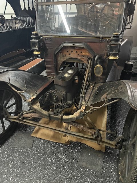

Began the process of tearing down the Delivery Car body to prep the wood for painting and staining.

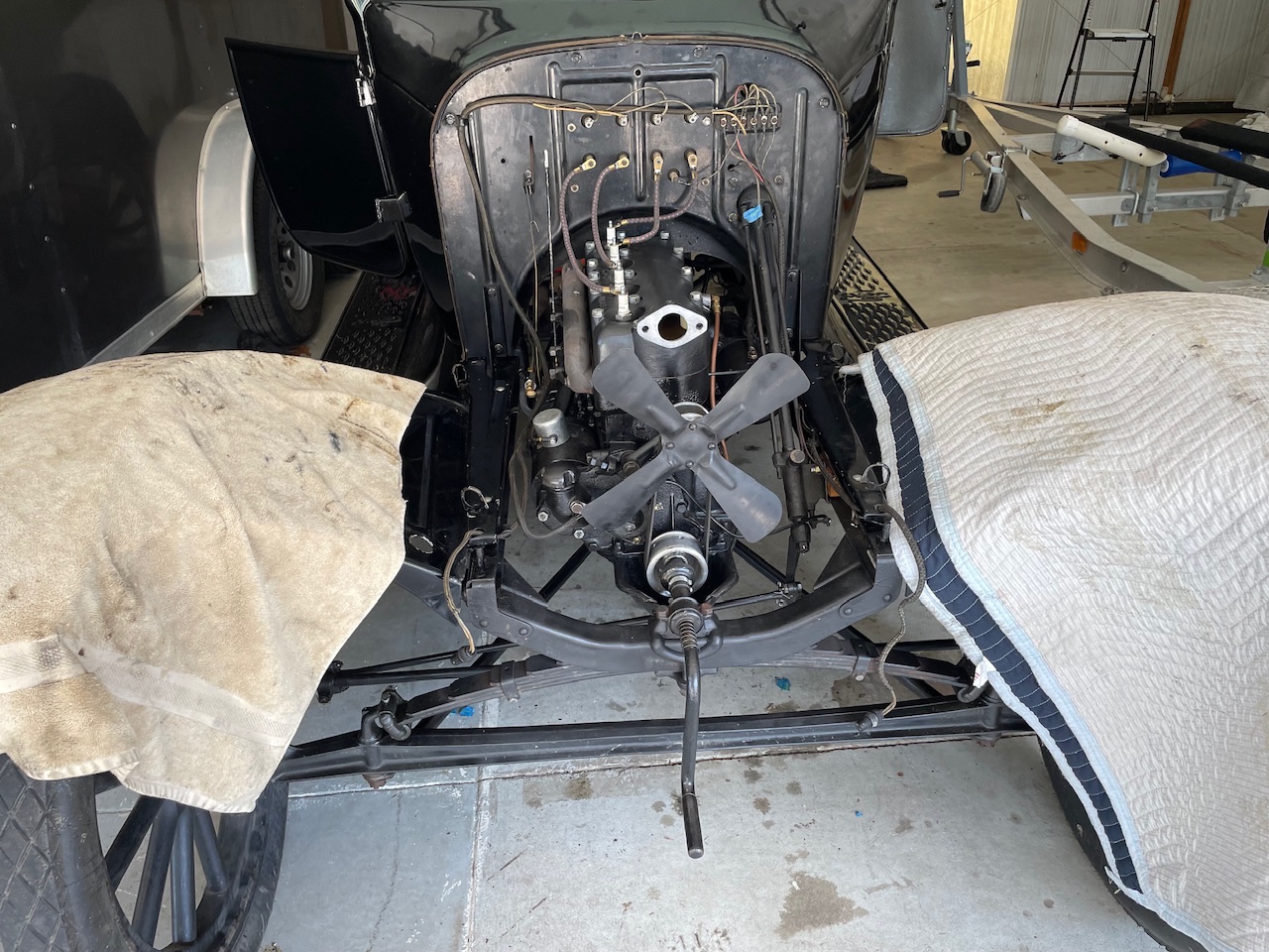

I'm 99% done reinstalling the engine in my '25 Touring. Also decided it was time to rewire the whole car. I just need to wire the taillight and brake light and she's done. A little impromptu rotten wood repair is being snuck in as well.

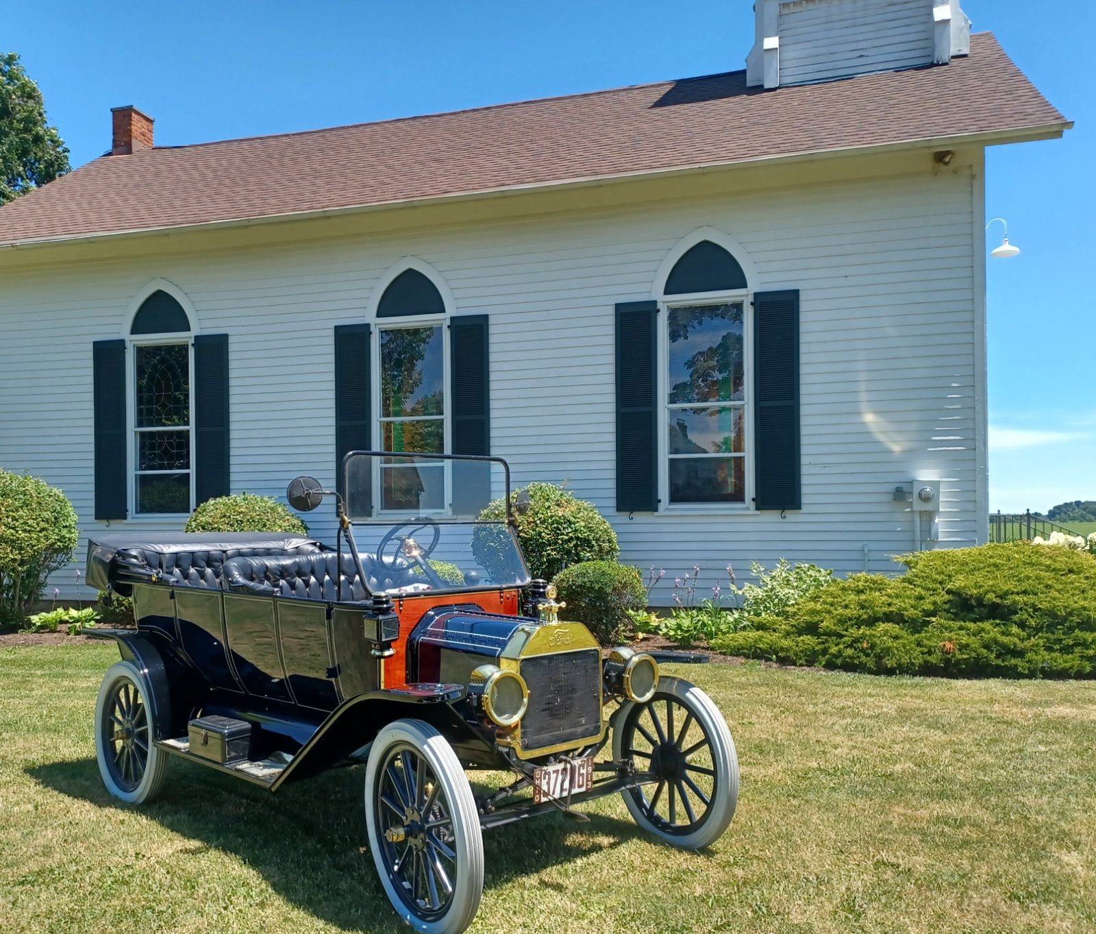

I took the 15’ to go see the Union Pacific Big Boy 4014 while it is in town.

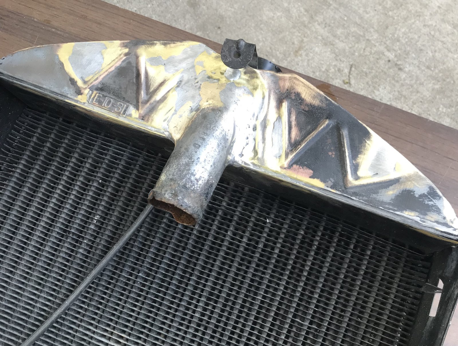

Reattached the upper neck to my radiator and fixed about a dozen small leaks. Put it back on the truck and it performed perfectly. No leaks. At least for now.
I have since painted it and it doesn't look half bad, considering that the upper neck was only held on by about an inch of brazing at the very top.

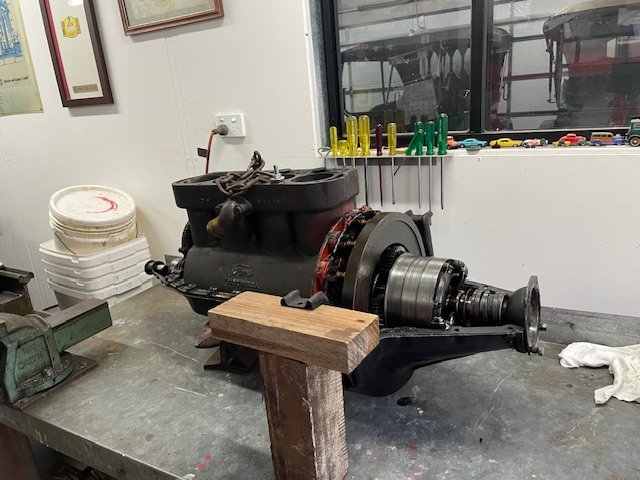

Down in Australia I have stripped the engine/transmission and diff out of my original 14 touring car and am going through it all making sure it is all up to scratch before I register it. I purchased the car from the States as an original car that has had a mechanical restoration but retains all it its patina. Well the engine is in great order but the transmission rebuild seemed to consist of a new set of bands lol.
The brake drum was totally notched up, broken clutch plates and worn out 4th main. The diff was also quite bad, loose pinion gear with a totally flogged male and female taper.
Anyway its all coming along nicely and I have enjoyed working on my first T, I love the car, it is very original and was quite correct with just a few later style parts that I have swapped out. A big call out to two gentlemen in the States who have helped me out with parts and shipping, Mr George House and Mr Phil Oldenhage.

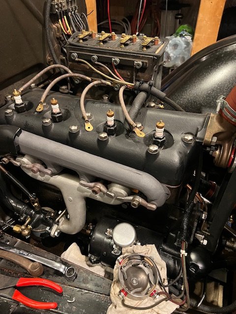

Spent the month sorting out little things, installed the new old commutator, flushed out bits of rag and hardened rubber from the radiator and block.

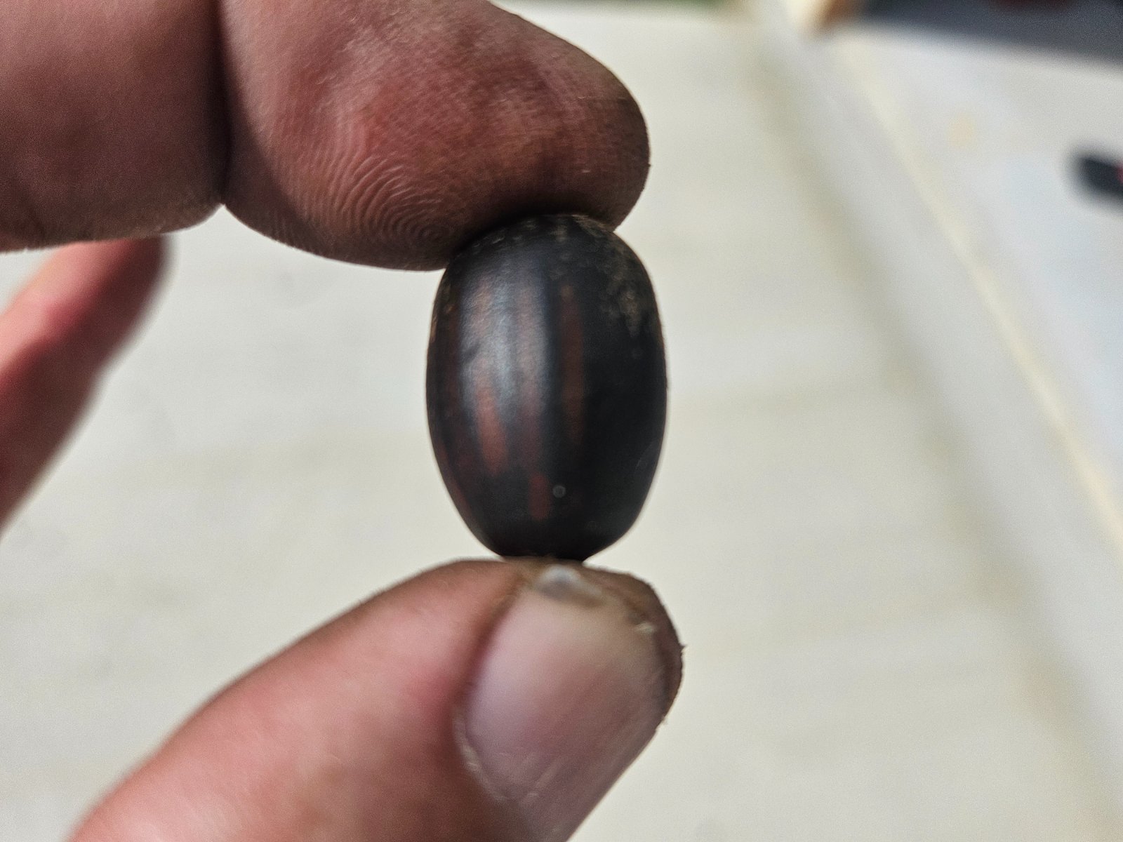

Continuing the process of going thru all the components of Daisy still working towards first crank.

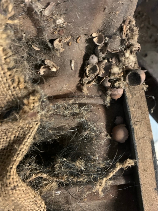

Worked on the radiator, having removed it, and what came out of the lower tank? A small acorn!!!!!
I then ran a hose into the head outlet to flush the engine, and what rolled out of the lower hose.... more acorns and broken acorn shells!!!!
The car had sat in a barn since 1930 with a rollout for partial restoration in late 60's, but back in the barn since then. The guy I bought it from mentioned the T was his plaything growing up. I sent him an email asking if he knew if the upper radiator hose was gone before the 60's repairs, suggesting a critter dropped them, or if he happened to be a bored kid at one time! LOL
My neighbor is a plumber, so he used his camera snake as best he could to check the head/top of the water jackets for more...didn't see anything....but lord ya just never know what you'll encounter!!

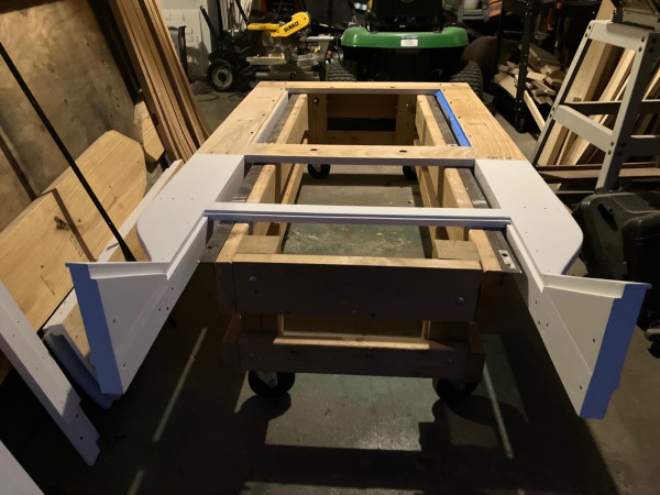

I broke ground on building my speedster body this month. My goal is to have it ready in time for the Foothills Model T Tour in Alberta next July.
