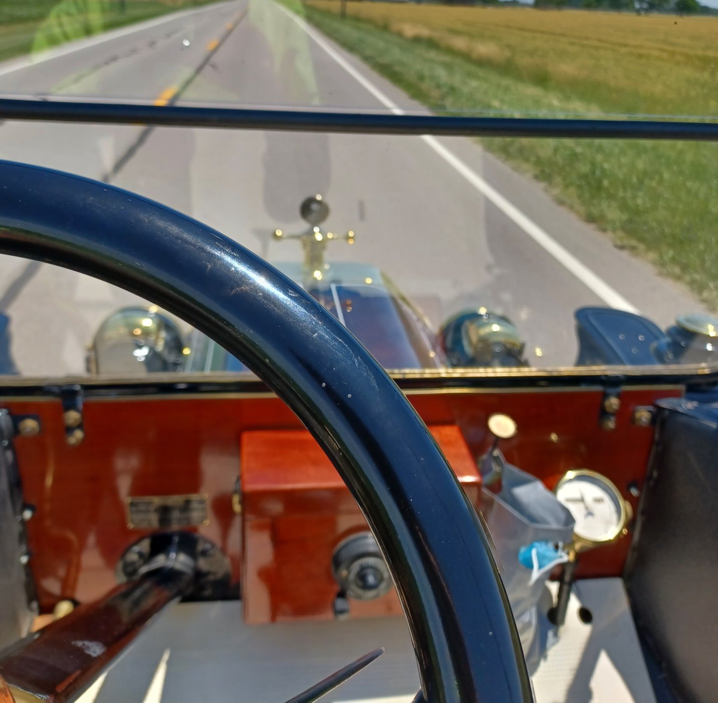

Post by TWrenn » Tue Jul 09, 2024 6:32 pm
Drove them! :lol:
Sunday's Annual Put in Bay (S. Bass island) tour was great again.
We been doing a few more of our Covid inspired picnic tours too!
Another nice afternoon trip to town to run errands..why use modern right?

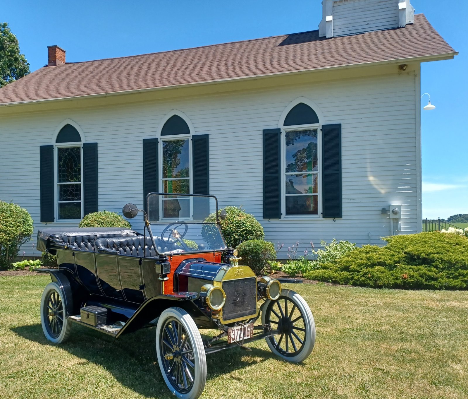

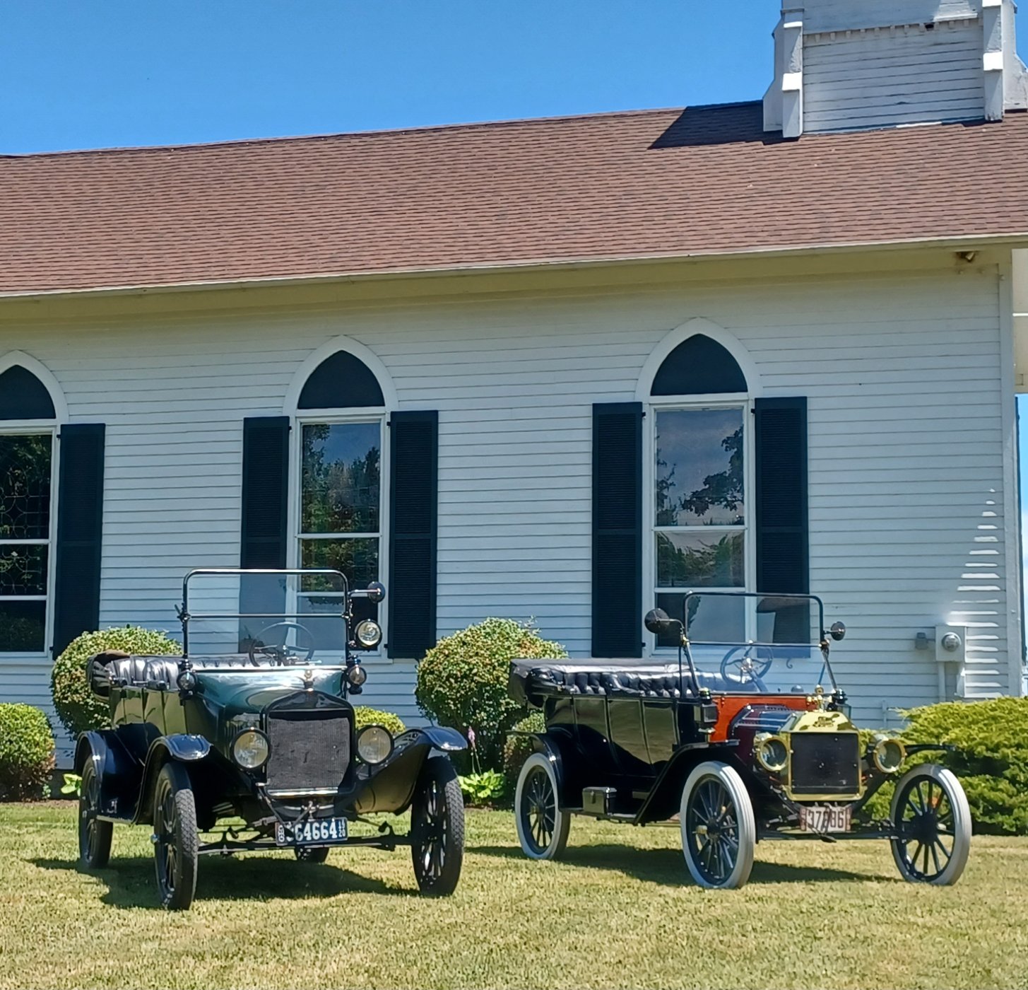

Country drive with church photo op

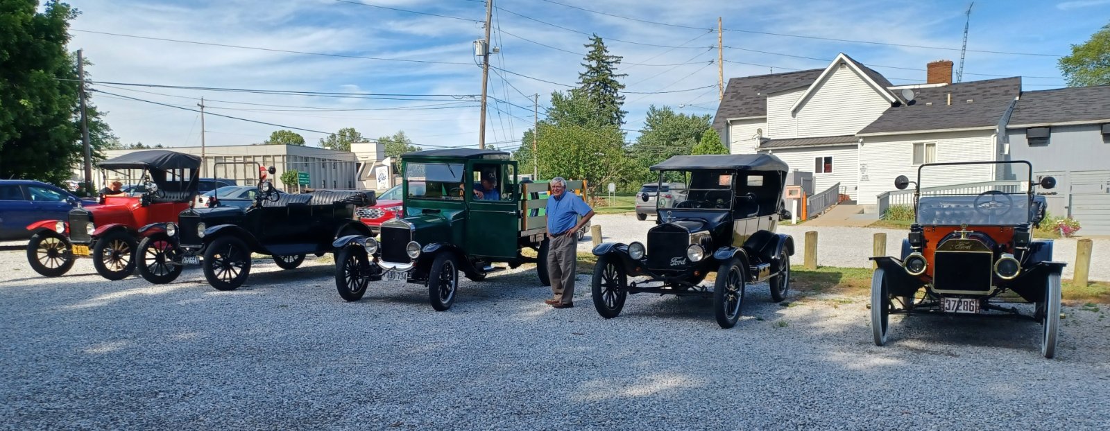

Local Lions club hosted us for dinner & show and tell! Fun!

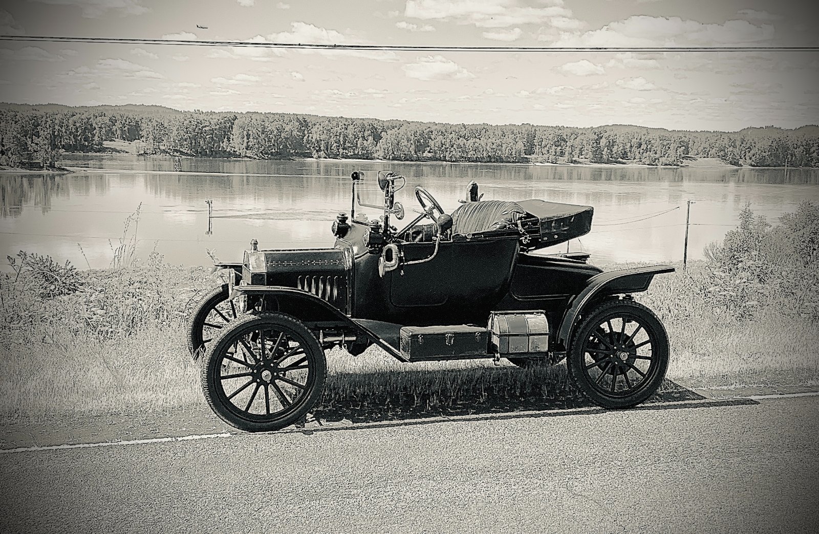

After 15 months, the running chassis completely rebuilt, finally drove "Popeye". A basic 1915 roadster, 1914 rear fenders as might have been in early '15, and a fresh 26 engine / trans. .020" over, .280 cam, Chevy valves, Prus high compression head, Winfield V4 carburetor. Runs the old Evergreen highway along the Columbia river well.

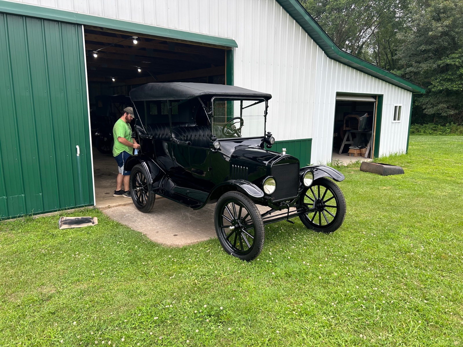

Helped my son finish his early 18 touring Monday of this week.

My gosh Mark, I thought it was finished when I saw it a few weeks ago. Hard to imagine it could get any prettier/better! Looking forward to seeing it again next week.

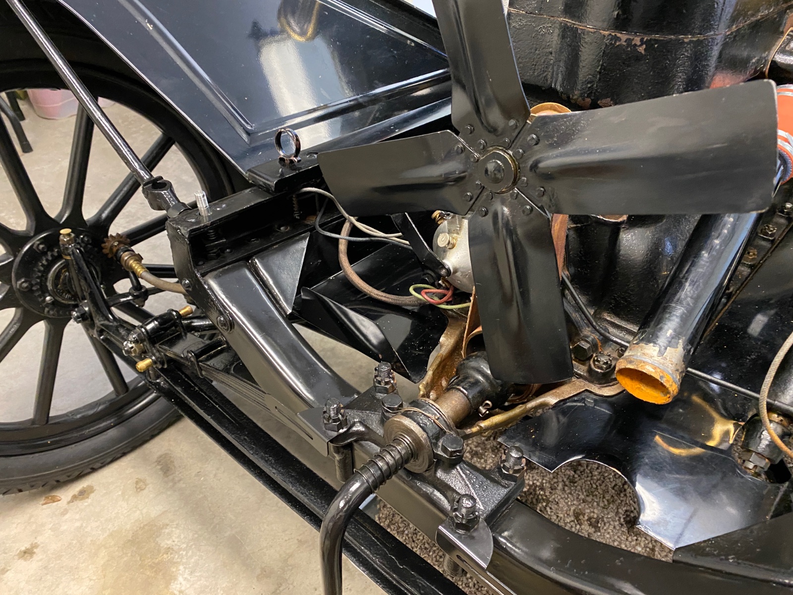

I'm 99% done reinstalling the engine in my '25 Touring. Also decided it was time to rewire the whole car. I just need to wire the taillight and brake light and she's done. A little impromptu rotten wood repair is being snuck in as well.

Thanks for the kind words. He had the patent plate to put on it and he restored a set of Champion X straight side spark plugs to make it run on. It’s cut and buffed now. He is very proud of it as he should be for his first one and much as I am of him to stick with and learn how to do it right. Our hobby is in good hands with young guys like him interested!

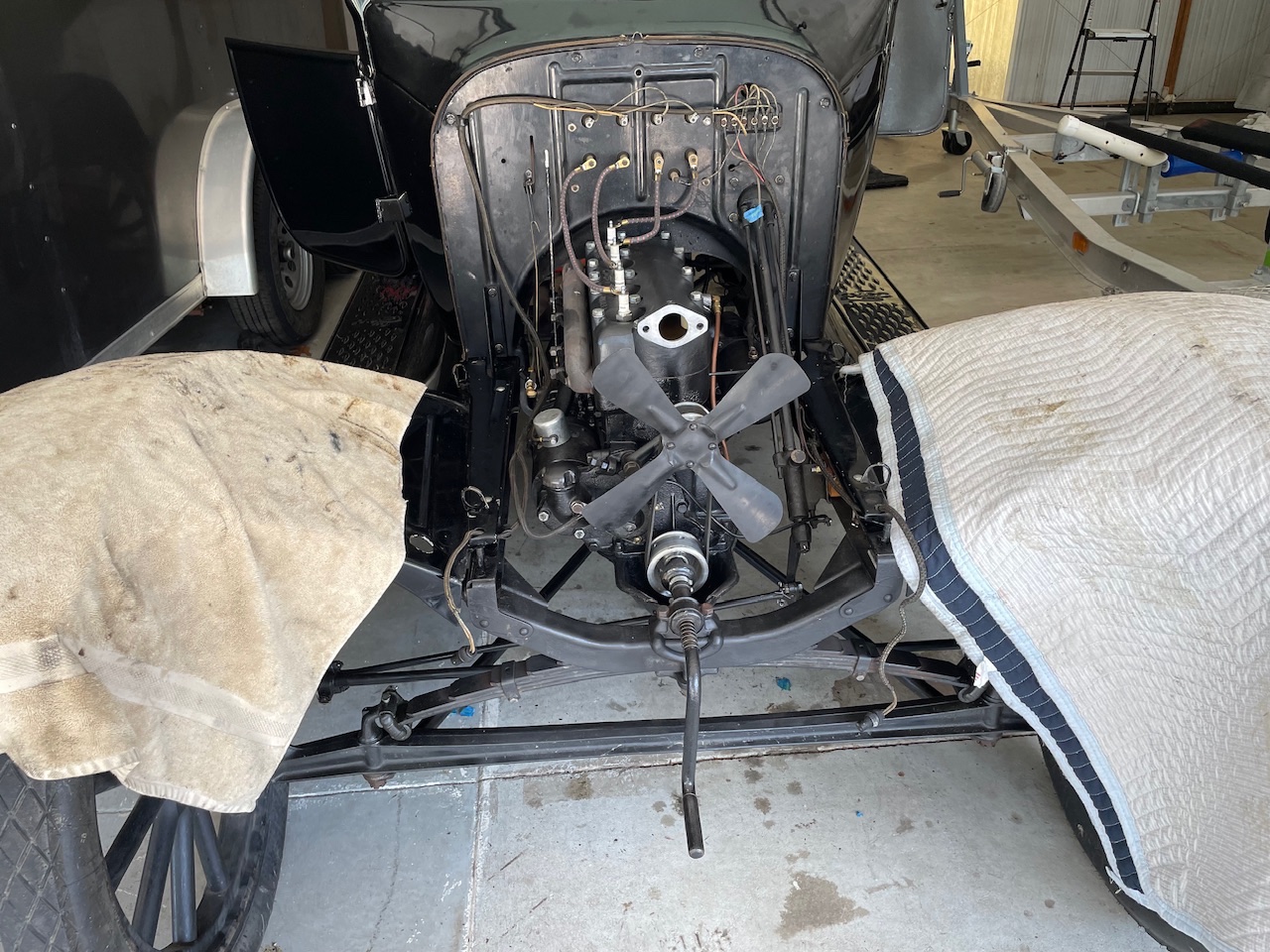

Post by mbowen » Wed Jul 10, 2024 2:04 pm
Getting the engine back installed just in time for the MTFCI tour in Cadillac, MI after the lower oil petcock loosened up and dumped the oil. A full tear down showed that the engine faired fairly well, only requiring the removal of a few shims. The transmission required replacement of triple gear pins, all bushings, and of course the bands. The drums were black from heat but not cracked. Kudos to Charlie Volkening in northern Michigan for doing a 10-day turnaround, and to Brian Dowell, Tony Osentosky, and Tim Toepel’s help on the R&R so I could make the tour!
3 hours from sitting on  floor to running!

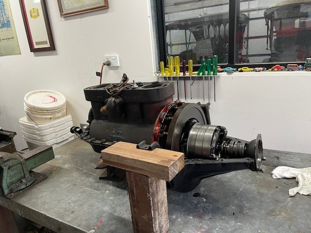

Post by Original14T » Sat Jul 13, 2024 5:03 pm
Down in Australia I have stripped the engine/transmission and diff out of my original 14 touring car and am going through it all making sure it is all up to scratch before I register it. I purchased the car from the States as an original car that has had a mechanical restoration but retains all it its patina. Well the engine is in great order but the transmission rebuild seemed to consist of a new set of bands lol.
The brake drum was totally notched up, broken clutch plates and worn out 4th main. The diff was also quite bad, loose pinion gear with a totally flogged male and female taper.
Anyway its all coming along nicely and I have enjoyed working on my first T, I love the car, it is very original and was quite correct with just a few later style parts that I have swapped out. A big call out to two gentlemen in the States who have helped me out with parts and shipping, Mr George House and Mr Phil Oldenhage.

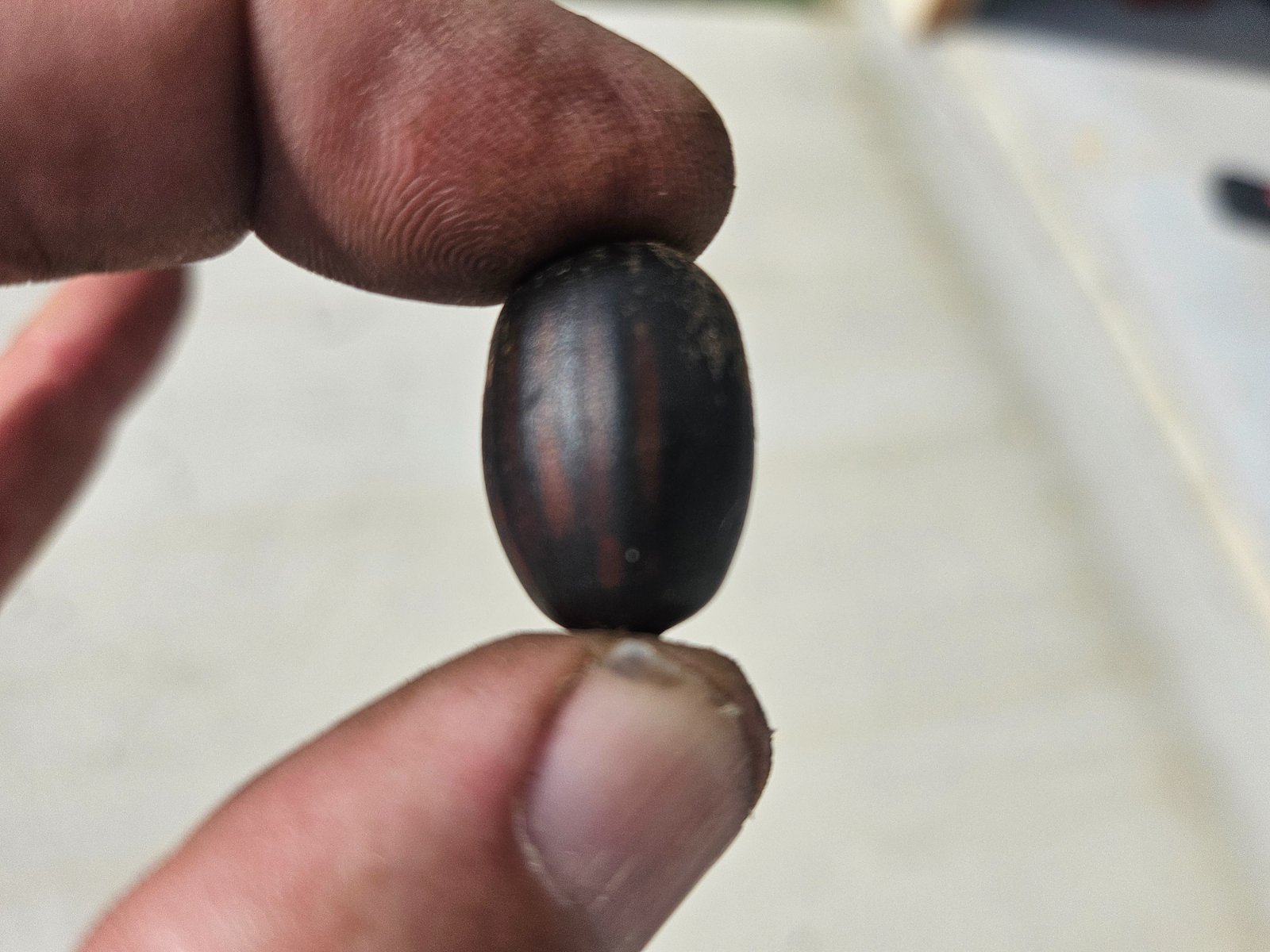

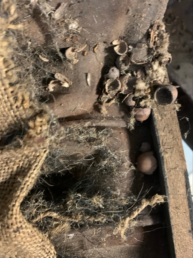

Continuing the process of going thru all the components of Daisy still working towards first crank.
Worked on the radiator, having removed it, and what came out of the lower tank? A small acorn!!!!!
I then ran a hose into the head outlet to flush the engine, and what rolled out of the lower hose.... more acorns and broken acorn shells!!!!
The car had sat in a barn since 1930 with a rollout for partial restoration in late 60's, but back in the barn since then. The guy I bought it from mentioned the T was his plaything growing up. I sent him an email asking if he knew if the upper radiator hose was gone before the 60's repairs, suggesting a critter dropped them, or if he happened to be a bored kid at one time! LOL
My neighbor is a plumber, so he used his camera snake as best he could to check the head/top of the water jackets for more...didn't see anything....but lord ya just never know what you'll encounter!!
mtntee20
Posts: 708
First Name: Terry & Sharon
Last Name: Miller
Location: Westminster, CO
Re: What have you done to your Model T in July?
Post by mtntee20 » Sat Jul 20, 2024 11:33 pm
Steve Jelf aka Dauntless Geezer, has a very good video on flushing a radiator and engine. I believe it's on his Dauntless Geezer site.
Plant that acorn and see if it grows :lol:
Good Luck

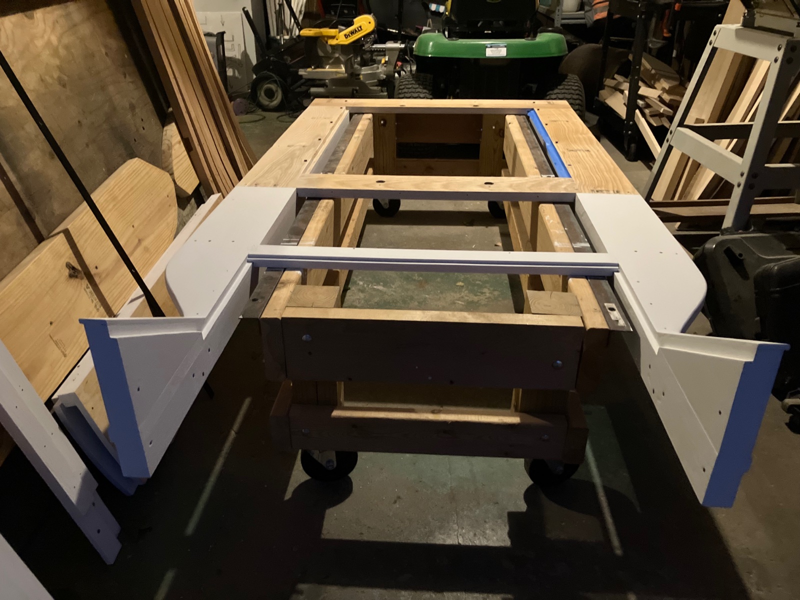

I broke ground on building my speedster body this month. My goal is to have it ready in time for the Foothills Model T Tour in Alberta next July.

Frame black.
Had a new 4140 steel ring machined for the flange and new bushings installed.
Put together a new engine stand.
Been doing some filler work on the old torpedo deck
Made gas tank straps.
Polished a lot of brass parts.
Keeping busy….

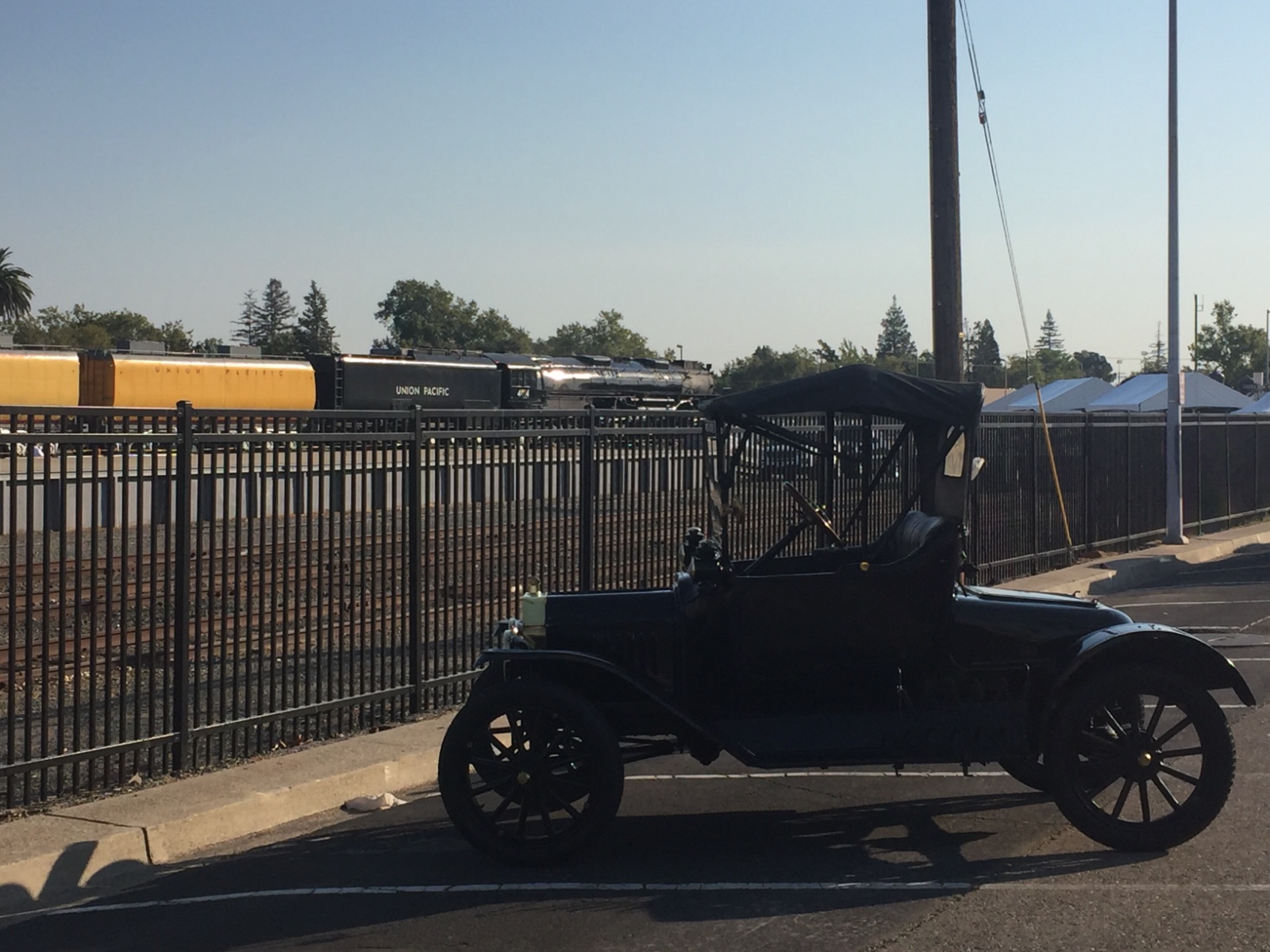

Cheyenne Frontier Days kicked off, it’s a total of 4 parades over a week. Just wrapped up the first parade yesterday!
https://youtu.be/PZCkUIJeG5I
