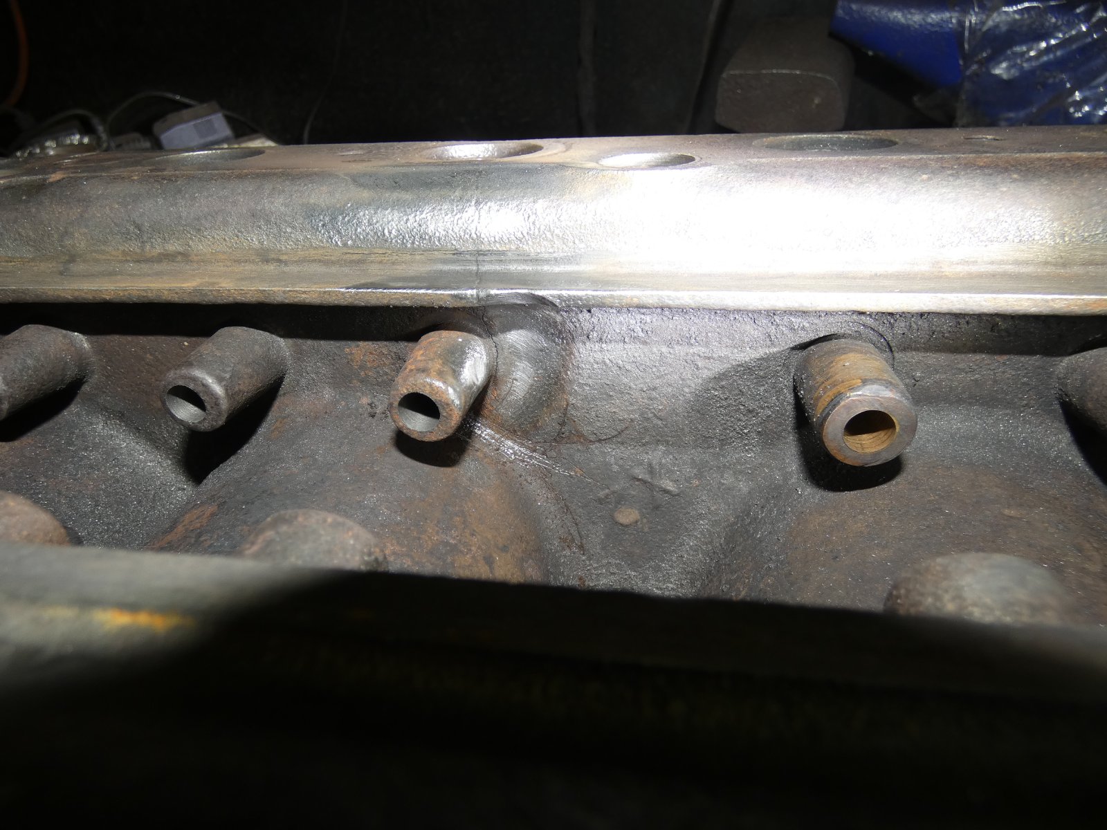

Topic author - Posts: 525
- First Name: Andre
- Last Name: Valkenaers
- Location: Scherpenheuvel
Re: Lock-N-Stitch
John,
Thanks for the advice.
I use this to find the cracks.
Andre
Belgium
Andre
Belgium
- Posts: 1434
- First Name: DAN
- Last Name: MCEACHERN
- Location: ALAMEDA,CA,USA
Re: Lock-N-Stitch
Andre- a magnetic crack detection setup is much faster and reliable. You can use a large permanent magnet or electromagnet with the powder. There must be the same available over there. Much better than dye penetrant.
