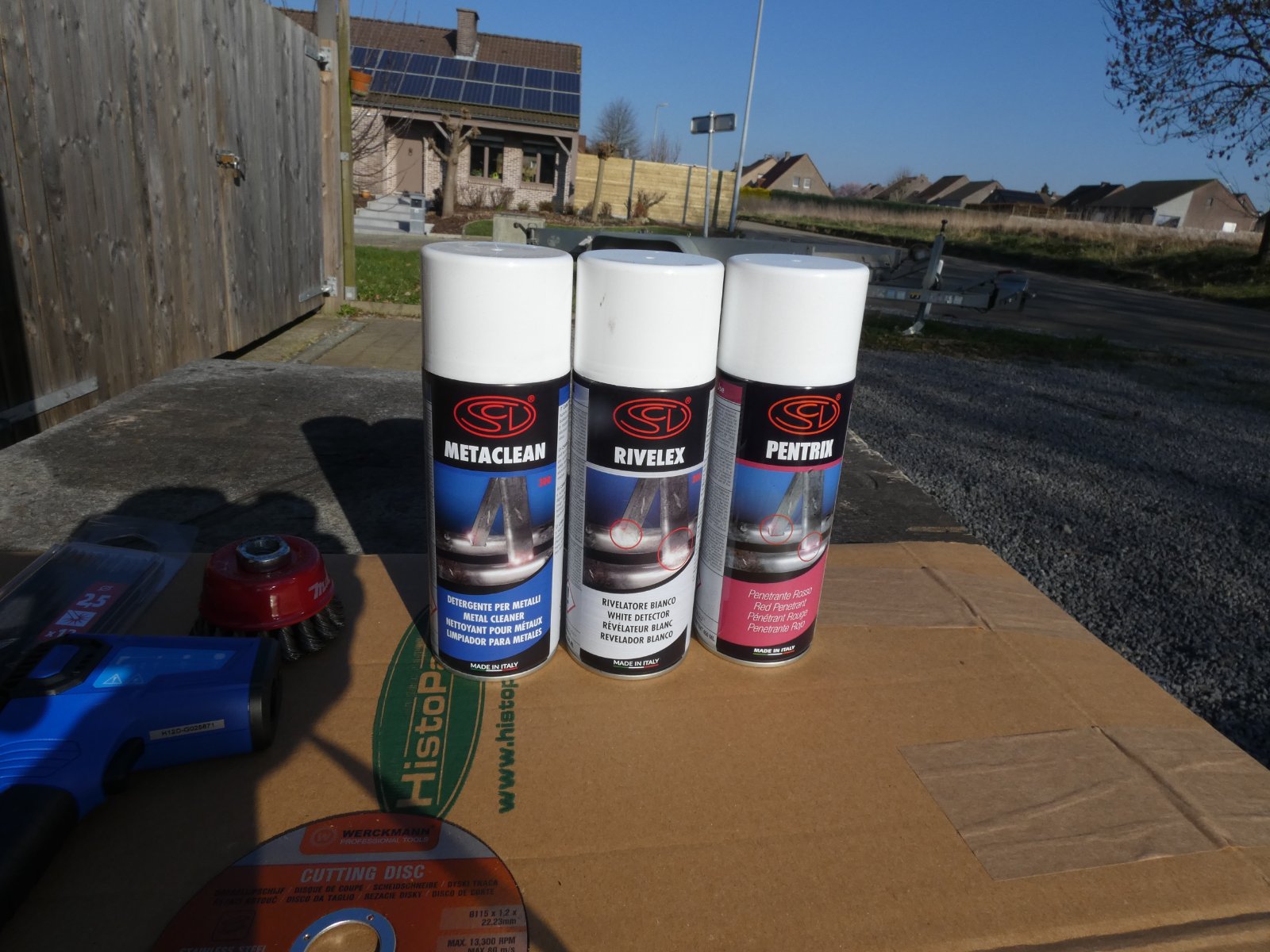

I use this to find the cracks.

Andre- a magnetic crack detection setup is much faster and reliable. You can use a large permanent magnet or electromagnet with the powder. There must be the same available over there. Much better than dye penetrant.
