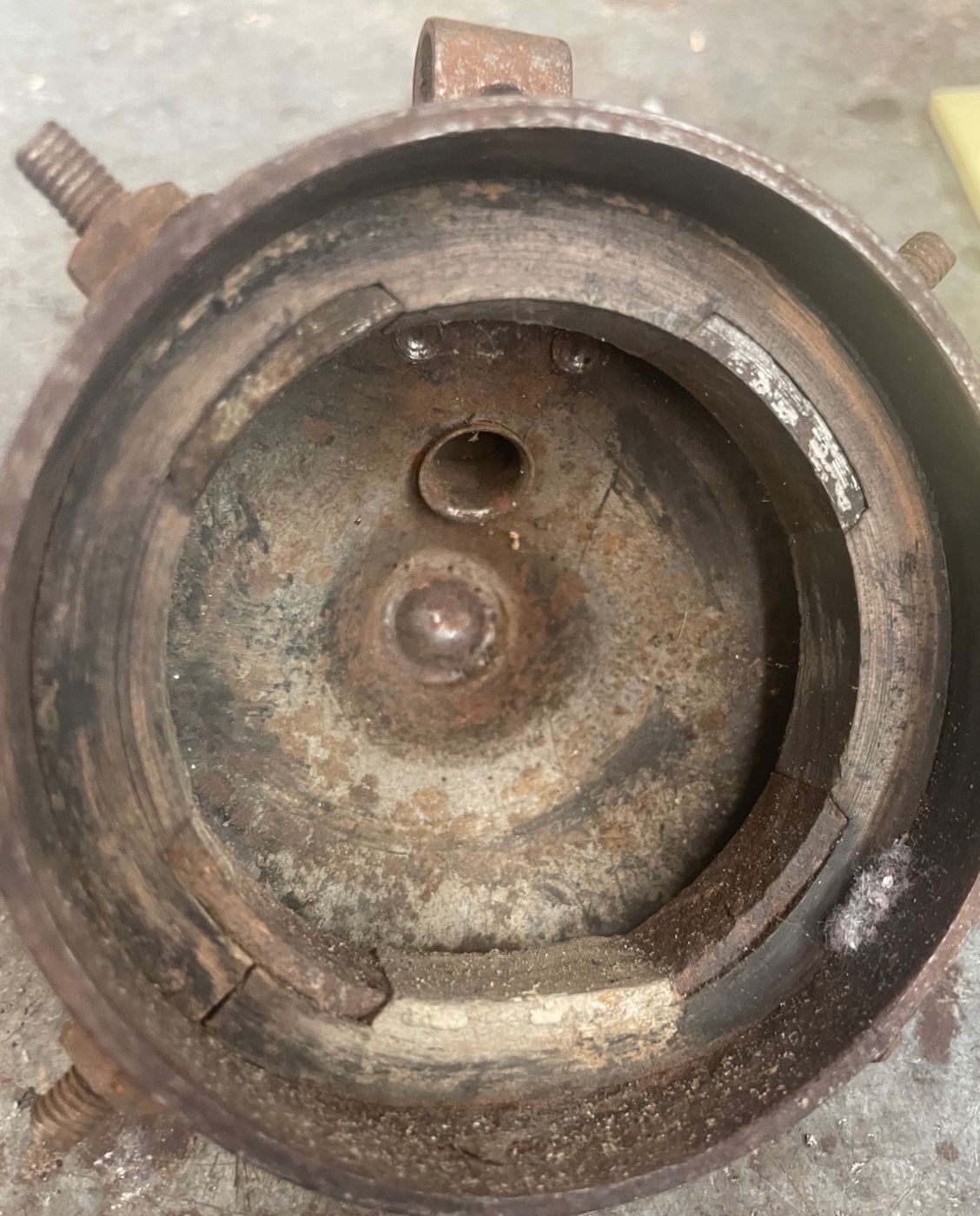

Don’t have timer available. Could someone answer questions in photo? FYI: am going to make insulator and the 4 contacts.[/size]

Don't forget to make the insulators for the threaded posts going through the commutator metal housing.

Some thoughts. I made the race ring from delrin and cut the contacts moon shaped. Easier to cut the contacts from a bar and the ring to imbed the contacts. Connected the contacts and terminals by threads. I got the dimensions by measuring an NOS timer.

Dimension approx. from a used Ford pressed steel roller timer.
A. contact thickness 0.120"
B. contact length 0.800" contact width 0.400"
C. contact radius ?
D. thread 10-32NF (overall contact + thread length .900")
E. thickness insulator 0.335"
other: contact conical insulator thickness 0.265"
C. contact radius ?

The timer Dan posted is the one I want to build new internals.
Dan: I was thinking I could use a 3” pipe and mill segments out of it. However, my timer case is at different location. The radius I could (pipe) use could be 2-1/2” or whatever. I don’t have the old segments handy.

The posted measurements are they from the posted pictures? If not where did they come from?

Those measures were made from my used Ford timer in the pictures . Used digital calipers on the parts shown.

Exact measurements taken? Timers wear at different rates. What would you say is the wear factor in your timer internals? I’m trying to build one as if it were brand new. Would a loss of 10%, 20% etc … be a good value of your photo attached?
Not that I am anal about it. I am curious as to the measurements when new and figured if the measurements were available I would build one that way.

Really, rather than asking for insulator thickness and contact radius, knowing the inside diameter of the contact ring would be more helpful, I believe. That's ultimately the dimension you want to control.

Jerry: exactly, when new! Have any idea what the value would be? However, values requested would be needed to complete project.

Addendum: You may/ may not know when you install just the insulation ring, pressing it in there is a lip you need to navigate, slight as it is, that value needs to be accounted for.

There is NO one single right answer to any of those dimensions! Even within the Ford factory, between 1911 and 1927 when that general style was used, the specific dimensions changed slightly several times. It does need to be noted that much of 1912 used a very different timer, required for a very different timing gear cover.
Cast aluminum, cast iron, and a few variations of stamped steel bodies did vary in thickness. That variance results in variations in the thickness of the insulator ring. If the literally more than a hundred after-market makers and models of timers with additional variations are considered? The insulator rings and roller contacts have dozens of variations in dimensions.
Insulator rings and contacts can often be swapped from one variation to another, with some creative effort. However, if you want a specific exact dimension you must first settle on which specific maker and model timer you wish to duplicate.
I guess a serious question is, what is your goal to duplicate here in the first place?

This is my point exactly, which is why I suggested concentrating only on the inside diameter of the contact ring.Wayne Sheldon wrote: ↑Thu Feb 13, 2025 4:53 am
Wayne's question, as to your goal, is also a great one. You've been a bit mysterious as to what you're really trying to do, (unless I missed something above). Making a 100% new timer? Making a new insulator ring & contacts to put in an existing case? Again, forgive me if I missed your intentions in previous posts.

The goal is! I have a worn out ford timer for my 26 coupe in which I want to rebuild, as I have the equipment to do so. That’s it!
I don’t want an aftermarket timer.
It was of my opinion someone in this community must have persued this project at one time and could have supplied answers. Although, I have received great suggestions. I am only a simple man trying to solve a simple problem.
As far as Ron’s suggestion. His solution is spot on if I were to start manufacturing the part. I am well aware of the costs associated with obtaining ford diagrams, as I have attempted it in the past.
Again, alls I want is to fix my car and not trying to start a manufacturing process. It’s a hobby not a career.

As Jerry states, you should be concerned about the diameter. Well, anyone have a new aftermarket timer who is willing to take a measurement?
