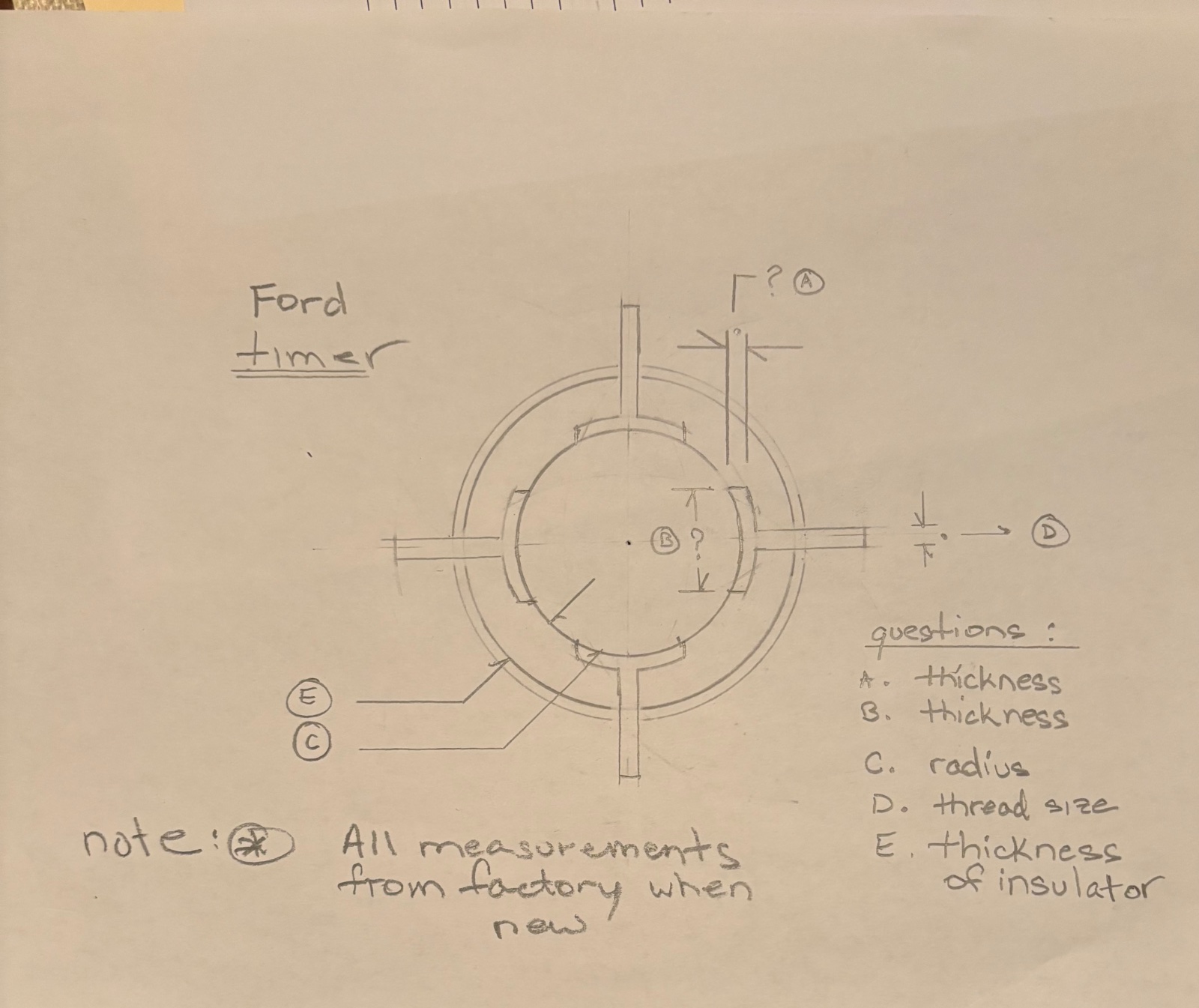

Don’t have timer available. Could someone answer questions in photo? FYI: am going to make insulator and the 4 contacts.

Don't forget to make the insulators for the threaded posts going through the commutator metal housing.

Some thoughts. I made the race ring from delrin and cut the contacts moon shaped. Easier to cut the contacts from a bar and the ring to imbed the contacts. Connected the contacts and terminals by threads. I got the dimensions by measuring an NOS timer.
Good luck.
Good luck.

I can loan you an original pressed steel script Ford timer but you realize the cast iron & aluminum were slightly different SO which one are you intending on replicating ?

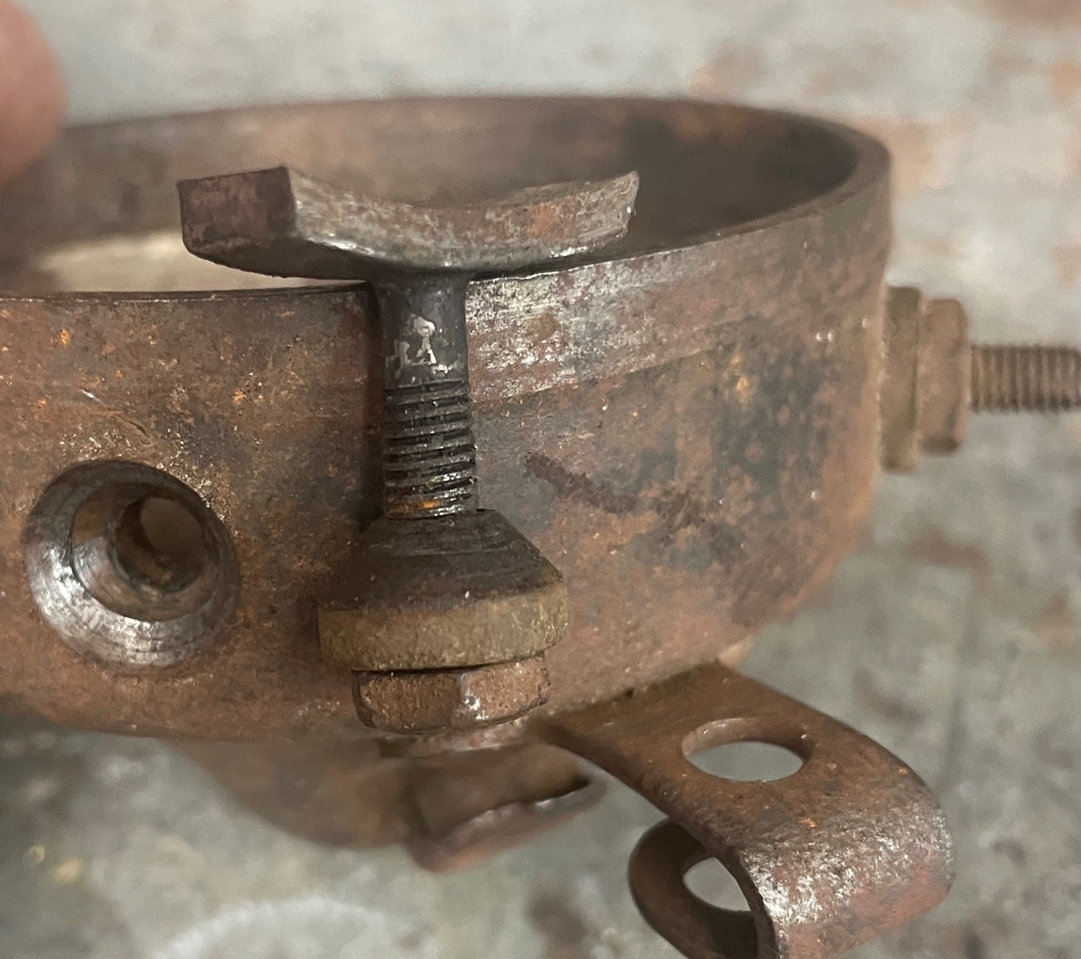

Dimension approx. from a used Ford pressed steel roller timer.
A. contact thickness 0.120"
B. contact length 0.800" contact width 0.400"
C. contact radius ?
D. thread 10-32NF (overall contact + thread length .900")
E. thickness insulator 0.335"
other: contact conical insulator thickness 0.265"
C. contact radius ?

Steve:
The timer Dan posted is the one I want to build new internals.
Dan: I was thinking I could use a 3” pipe and mill segments out of it. However, my timer case is at different location. The radius I could (pipe) use could be 2-1/2” or whatever. I don’t have the old segments handy.

Dan:
The posted measurements are they from the posted pictures? If not where did they come from?
Thanks,
John.
Thanks,
John.

Those measures were made from my used Ford timer in the pictures . Used digital calipers on the parts shown.

The steel in pipes is rather soft. The steel in drawn tubing is likely harder and more consistent. The steel in timer contacts may well be something different again. It would be a shame to start the project with materials which are not up to the demands of the application. Time spent working this out may be time well spent.
Can anyone show some light on the subject?

Exact measurements taken? Timers wear at different rates. What would you say is the wear factor in your timer internals? I’m trying to build one as if it were brand new. Would a loss of 10%, 20% etc … be a good value of your photo attached?
Not that I am anal about it. I am curious as to the measurements when new and figured if the measurements were available I would build one that way.

Really, rather than asking for insulator thickness and contact radius, knowing the inside diameter of the contact ring would be more helpful, I believe. That's ultimately the dimension you want to control.

Jerry: exactly, when new! Have any idea what the value would be? However, values requested would be needed to complete project.
