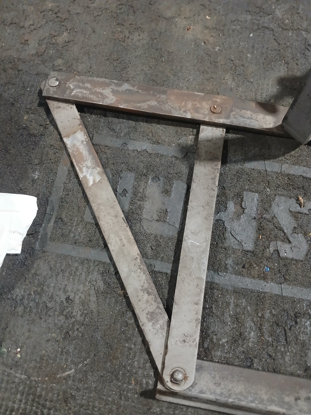

Does this style of luggage rack fold?
Does this style of luggage drag fold, if so how? Thanks.

Re: Does this style of luggage rack fold?
Yes. It folds flush to the edge of the running board so you don’t have to remove it.
If either end of the diagonal brace has a latch/release, then you can fold it.

Topic author - Posts: 886
- First Name: Austin
- Last Name: Farmer
- Location: N.W. Illinois
I looked at that thread and noticed that the style they mentioned had a cut out latch on the Triangular side. This style does not have such a latch. I wonder if it is homemade?
It looks to me that it is completely riveted together.

- Posts: 4623
Use some WD40 or a little oil to lubricate all the joints. Carefully use pressure and it will fold up. Move back and forth a few rimes and it’s OK.
- Posts: 7133
Austin, one end of the diagonal must detach if the thing is to fold. Perhaps in its past the detachable end has been fixed permanently in position. Check that all the rivets are consistent, looking for some difference in one at the diagonal strut end.
A simple way to bring it back into operation is to add a bolt and wingnut in place of a rivet.
The fact that each of the braces are rounded have rounded instead of square ends is most likely an indication that it folds.
Also, did you check if to see if the end of the diagonal brace that is covered by the vertical brace is slotted so you can push the diagonal brace forward or backward so it no longer rests on the pin/rivet?

- Posts: 7133
Another indication that is meant to fold may be the presence of washers between each component of the rack. This is done so they do not bind/scratch on each other as they fold.

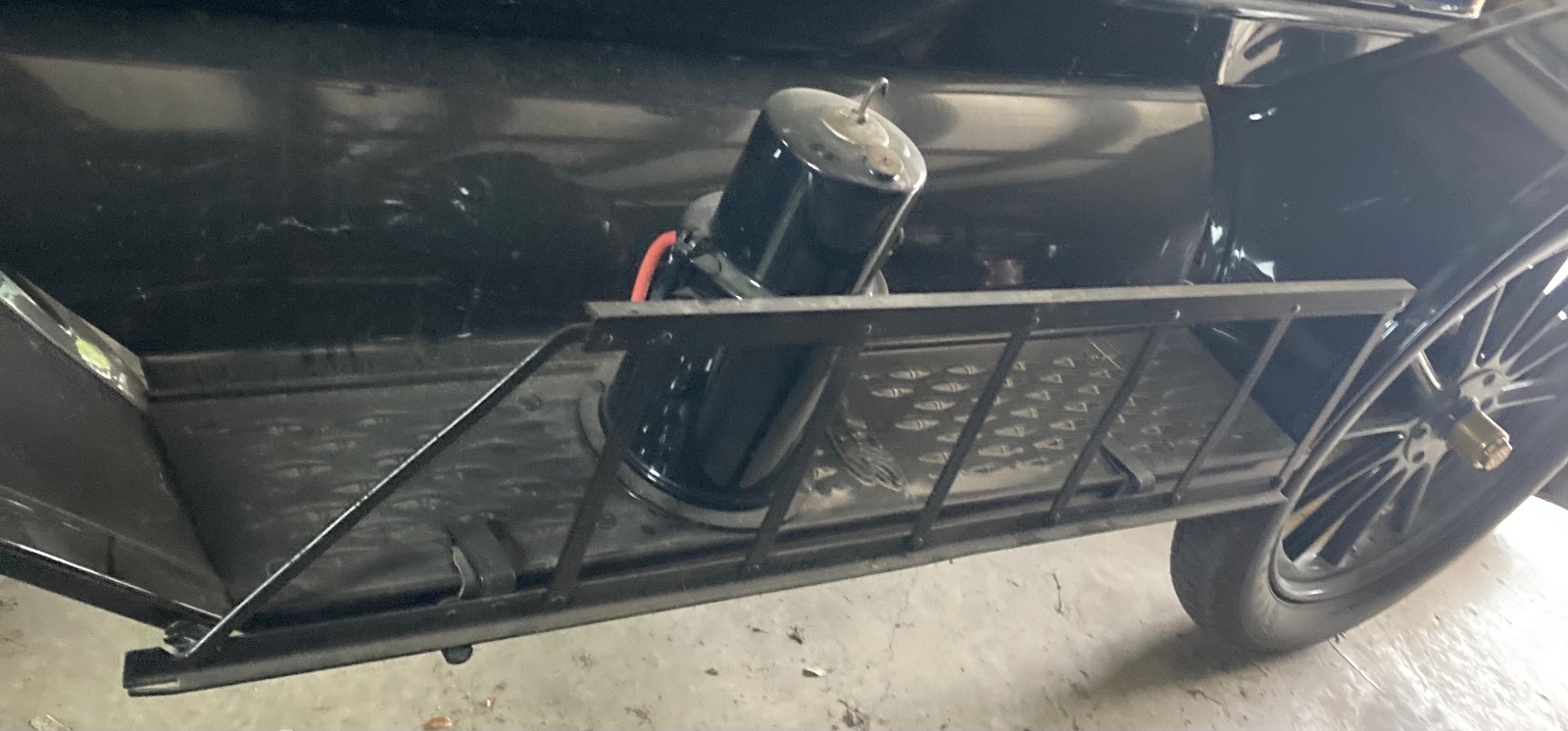

I have one of these and yes it folds down and will be flush with the running board .
- Posts: 6541
Zooming in it appears that there is one pin position that may provide a disconnect from the angle brace. It may be rusted, see if it will pop out.
The fact that the lower rivets for the uprights are on the inside of the horizontal piece and the rivets on the upper horizontal piece would allow for a flush fold down to the floor board. If they were both on the same side the upper horizontal piece would rest on the lower one when it was collapsed, not flush as others described

- Posts: 7393
If the diagonal brace can be disconnected, yes.
If it can't, no.

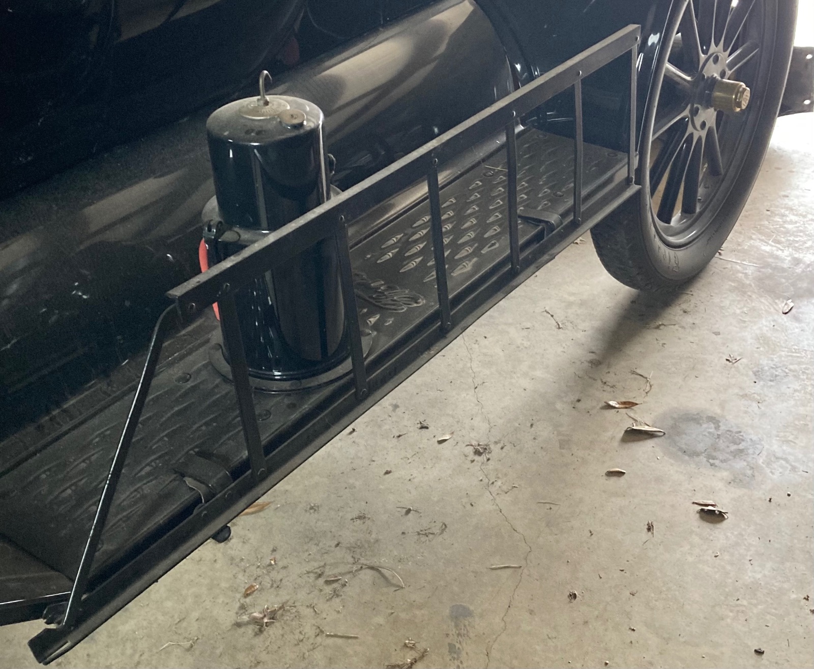

- Posts: 2993
- Last Name: House
I’m going to say it will fold down once lubricated. Altho slightly different, mine folds down…
- Last Name: Farmer
Thank you all for your help and ideas I looked at it closer and found that one of the rivets indeed has a larger head and a cut out on the angled bracket, I popped that off with a ball peen hammer and it folds right up now!
