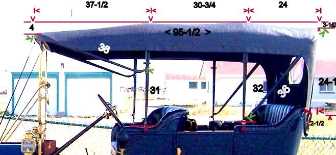

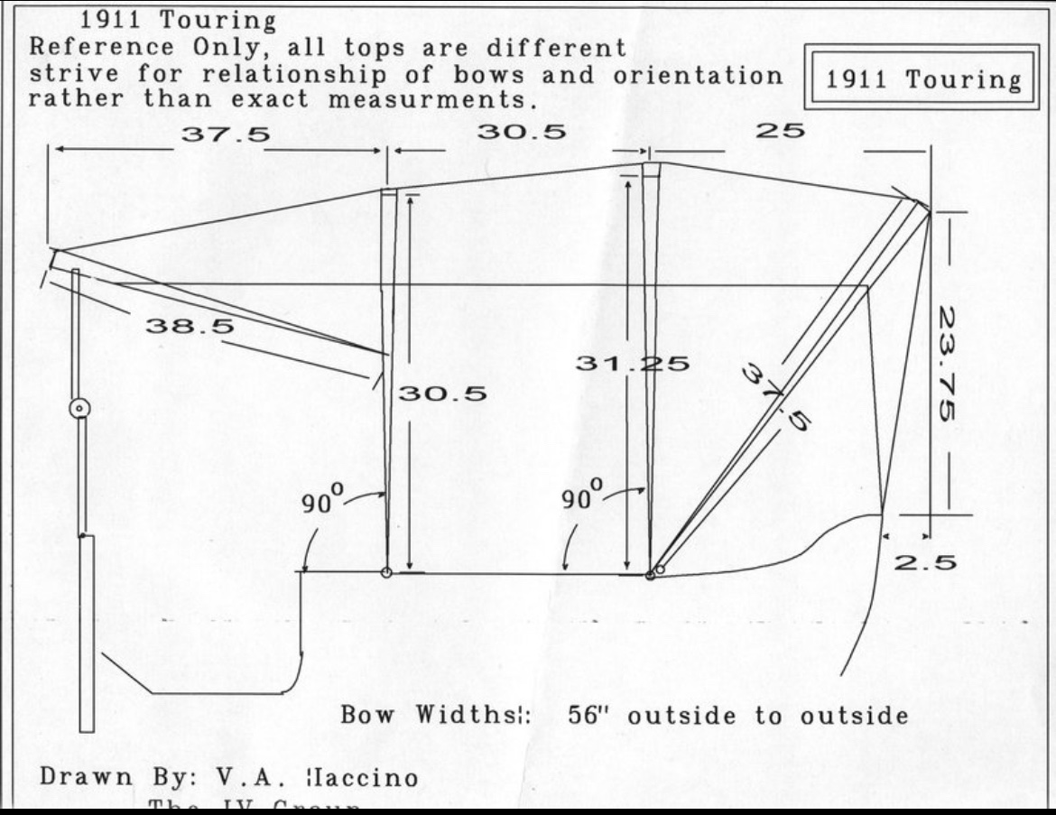

Hope these help:
These are the dimensions on my top. Note the vertical bows should be close to the same height.
-Keith
-Keith

I just saw the attachment Keith sent. That nailed it exactly

John
Did Vince make diagrams like that for all years?
I have his video on DVD
dave
dave

Re: A few questions about 12 Touring Top
My thanks to all that responded. Keith Townsend established contact and with his Late 1911 touring has provided great photos and responses to my questions. I am off and running now with my trimmer making the new top. I am new to T's and this forum, what a great forum with helpful folks!
