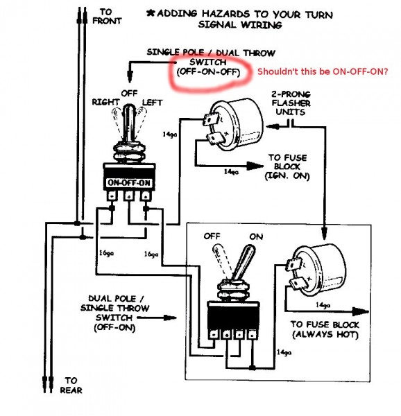

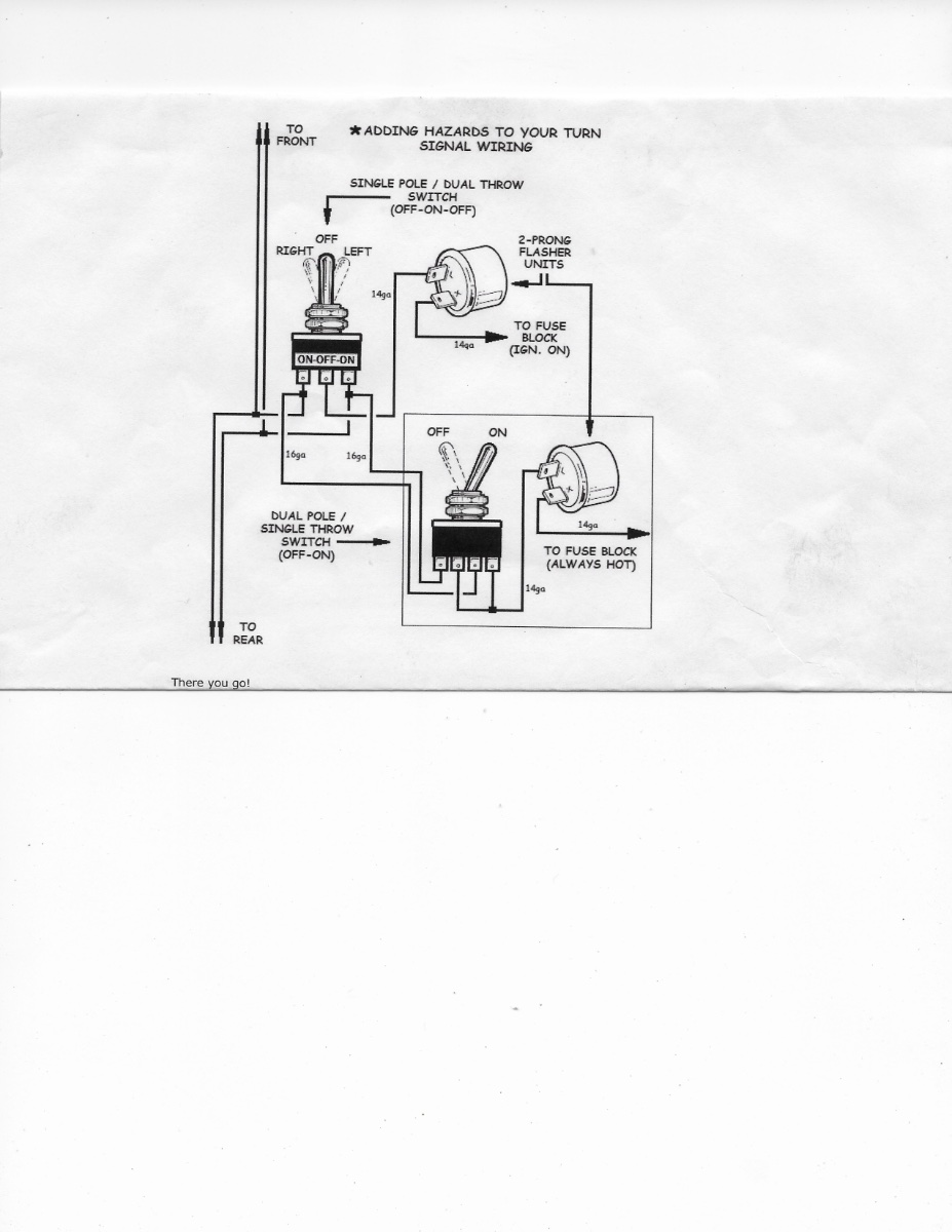

Re: LED turn signals?
Here you go folks! Simple, works Great, the hazards are optional.
All the Best,
Hank in Tin-A-See
All the Best,
Hank in Tin-A-See
- Posts: 1201
- First Name: Adrian
- Last Name: Whiteman
Hank, that is a nice touch and looks easy to add it in to the existing wiring. Might give it a go

I have not figured out putting the flasher before the switch. Usually on a set up we would be using on a T would have 2 flashers after a 3 position switch. One for the feed to the left lights and one to the right unless you were mounting a regular turn signal control which is designed to use 1 flasher.
Topic author - Posts: 7393
Looks like that diagram should do it, but...

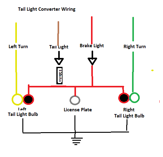

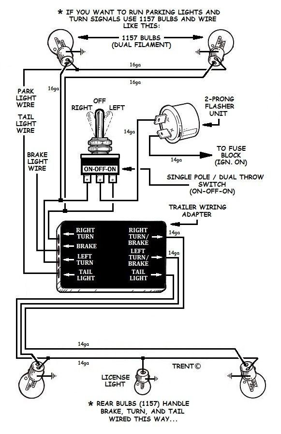

- Posts: 6540
Here is a wiring diagram that can be integrated into the T wiring. It includes a black box (tail light converter - designed for trailer connections) to simplify the wiring to the tail lights if you have dual filament bulbs. I roughed out a diagram of the black box wiring to show what it does. Also if you are using LED Bulbs you need to get a Flasher that works with LED bulbs
- Attachments
- Taillight Converter Box.png (9.63 KiB) Viewed 8603 times
