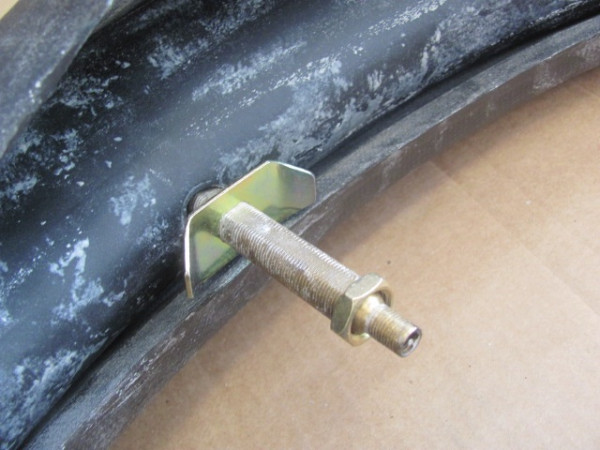

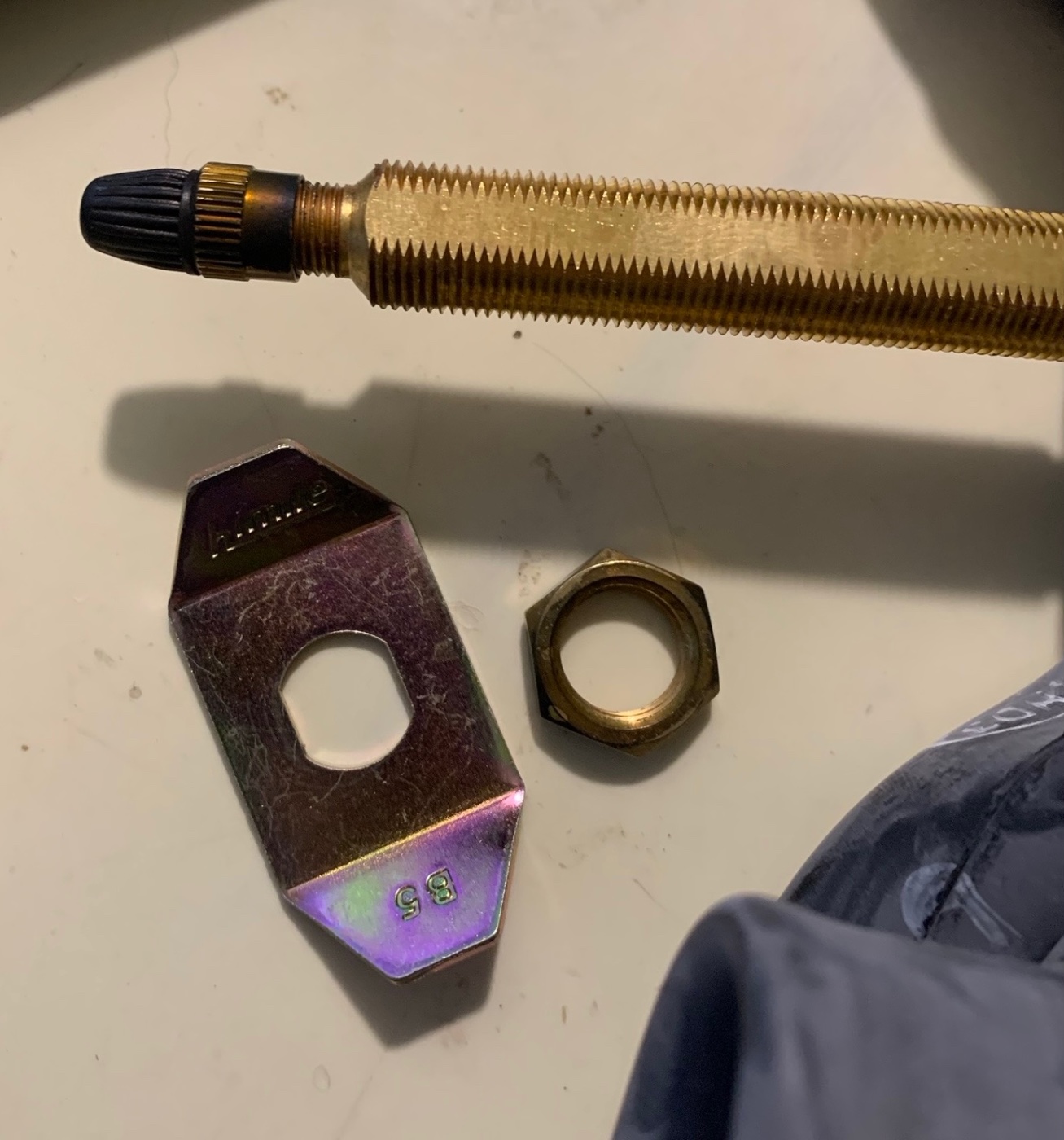

Do new Hartford 30x3-1/2" metal-stem inner tubes from Coker need bridge washers and nuts? Or can they be used like rubber stem tubes?
The old hardware has different threads and does not not fit the new tube stems.
It looks like the new tubes have the stems vulcanized, so is there a need for the bridge washers and nuts?

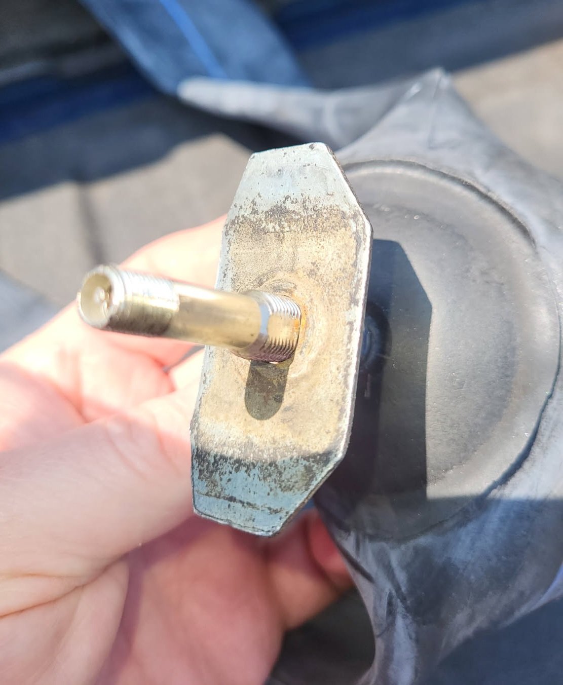

KWTownsend wrote: ↑Sun Jun 01, 2025 5:18 pmDo new Hartford 30x3-1/2" metal-stem inner tubes from Coker need bridge washers and nuts? Or can they be used like rubber stem tubes?
IMO, the bridge washer and lock nut really adds strength to the stem tube interface. A lot of lateral force is on the tire when braking , which can move the stem. Locking the stem under the felloe and above with the companion washer /nut for the stem dust cover provides the necessary support to prevent tube / stem tear.
Yours looks like wire wheel brass stem, shorter type, on wire wheels, if under a higher powered chassis, the max protection for the tube may be best.

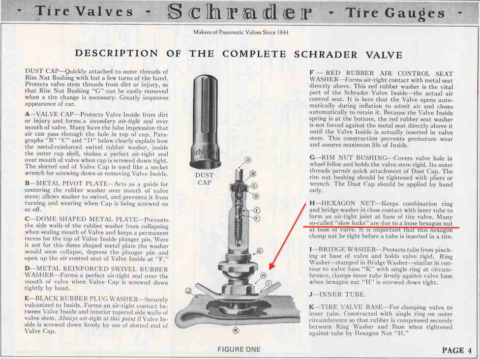

I use them - otherwise when you tighten the valve stem you can actually pull the tube down into the gap between the beads of a clincher tire. Like Dan says, it adds strength.

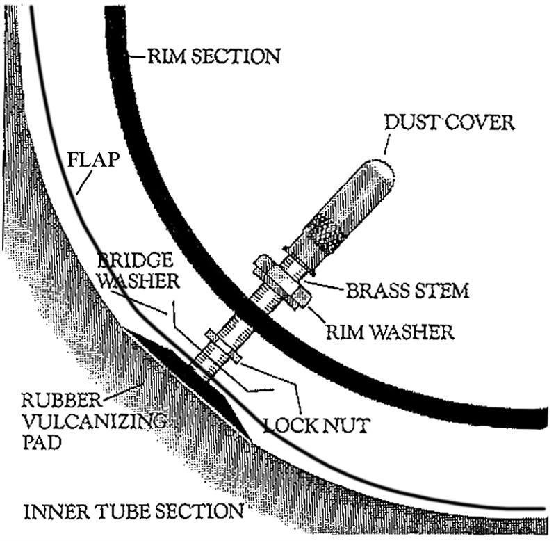

Both diagrams indicate the stem goes through the flap, then the bridge washer and lock nut are installed (one diagram shows the stem pointing up, the other pointing down.) Correct?
Dan:
If you are a flap guy, do you concur on the order of assembly? Stem through the flap, then bridge washer and lock nut?

I'm a flap guy and I've mounted dozens of 23" clinchers - I use the diagram that Tim posted above. The tube stem photo you posted above appears to be a Model A wire wheel tube ?????

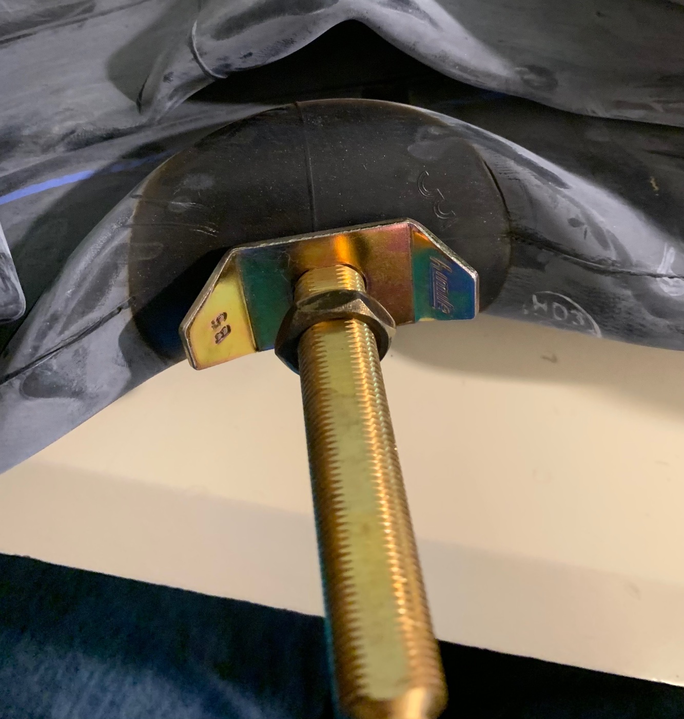

The tubes are for 30x3-1/2" tires. I don't know if they are wire wheel tubes or not. They belong to a friend of mine who had never mounter clincher tires before. My experience with the rubber stem tubes, that is the reason for my question...
Yes. That is important order.
One caveat is using a flap.....be very sure...the flap hole is sufficient to allow the hex nut over the bridge washer to completely squish the flap and tube together. If the nut is loose, the flap can wiggle on the tube, and may lead to loss of pressure.
Photo shows flap over the tube in place in the tire casing. The bridge washer going on, and the hex nut following, and really torque tightly to get the thick rubbery flap to compress onto the tube, thereby making a real good seal.
Follow-on.....note the importance of the bridge washer hex nut to be very tight against the washer and tube to prevent leakage.

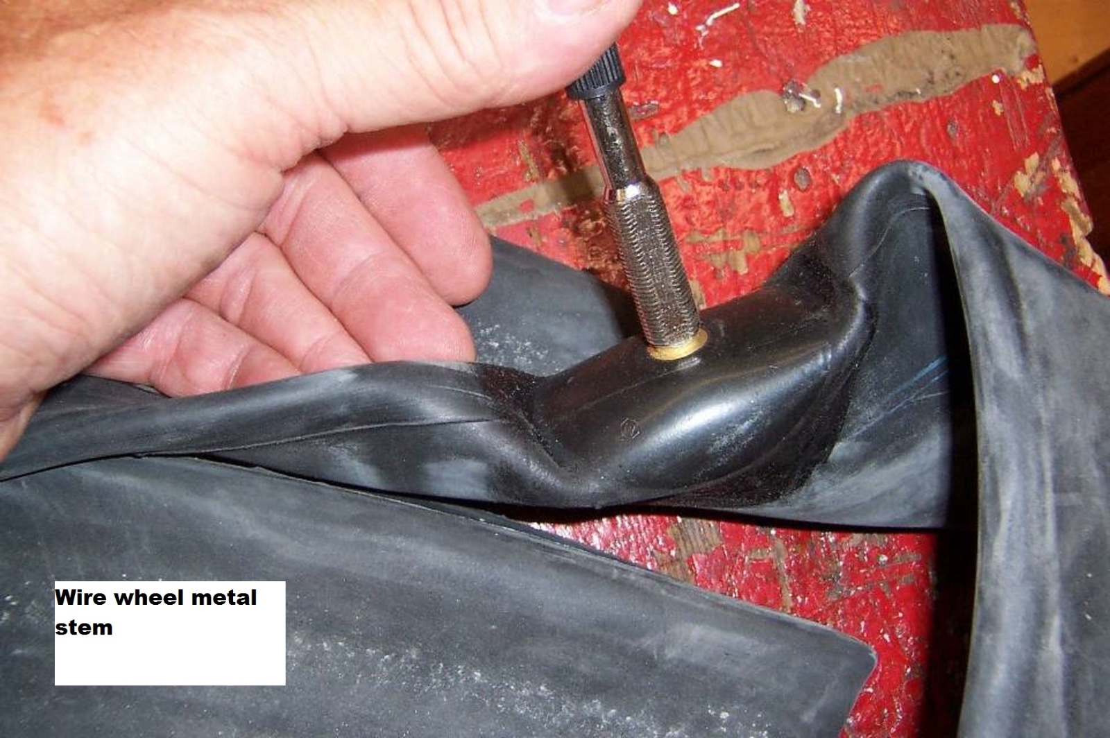

This is the wire wheel metal stem, 30 x 3 1/2, used for that rim size wire wheel or disc wheel.

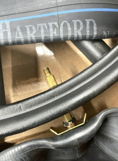

What a mix up! Original metal stem tubes have a flange on the stem that is inserted in the tube. Then comes the bridge washer, with a raised land around the hole that is designed to add crush to the rubber pad on the tube. Then comes the stem nut to make that crush. This is all that makes the seal, and it has done so for ever. That is how Henry did it.
These new tubes have the stem vulcanised into the tube to make the seal. No bridge washer or stem nut needed. In fact, the bridge washer doesn't even have the raised land to add any crush. Properly tightened it can only displace rubber from around the stem.
Then comes the flap. The first drawing shows it fitted to the tube, and held there by the bridge washer and stem nut. That means the tube and flap must be installed as a unit! Then there is the concern that the bridge washer and stem nut needs to add further crush to make the seal that has already been made by the vulcanising of the stem. Or you can add the flap after the tube is inserted into the tyre. Or, leave the flap out altogether, like Henry did. Just work on the KISS principle.
I currently have six T's with clincher tyres. Some wheels have original threaded stems with bridge washers and stem nuts. Some have newer tubes to which I have added original threaded stems with bridge washers and stem nuts. Others have original or stick-on replacement rubber stems. One even has a brass valve extension on a short rubber stem. I use Dill valve covers with the sliding thread inside on all of them, because they fit on the small end of all valve stems. It probably comes as no surprise to some that none have flaps.
