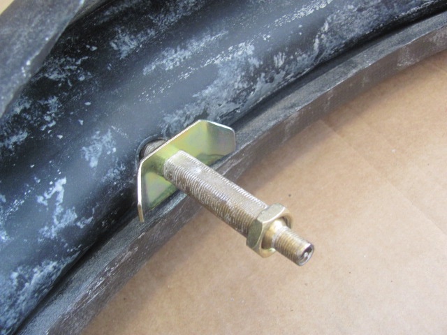

One caveat is using a flap.....be very sure...the flap hole is sufficient to allow the hex nut over the bridge washer to completely squish the flap and tube together. If the nut is loose, the flap can wiggle on the tube, and may lead to loss of pressure.
Photo shows flap over the tube in place in the tire casing. The bridge washer going on, and the hex nut following, and really torque tightly to get the thick rubbery flap to compress onto the tube, thereby making a real good seal.
Follow-on.....note the importance of the bridge washer hex nut to be very tight against the washer and tube to prevent leakage.
click on image to enlarge

This is the wire wheel metal stem, 30 x 3 1/2, used for that rim size wire wheel or disc wheel.

Just call AAA and tell them you have a flat and need the tire changed. When they arrive and take a look explain very clearly speaking very slowly that you said you had a flat tire and needed the tire changed, not that you needed a wheel replaced....
Problem solved
Posts: 7411
Re: New metal stem inner tube question
Post by Steve Jelf » Tue Jun 17, 2025 10:57 am
How many hours will it take for somebody from AAA to each my rural location?
NorthSouth
Posts: 638
Last Name: California
Location: West Coast
Post by NorthSouth » Tue Jun 17, 2025 2:14 pm
Something that no one has mentioned thus far is that the modern Lucas inner tubes have tapered rubber valve stems that do not fit all the way through original wheel fellow holes. To have these modern valve stems fully seat in correctly the stem’s taper needs to be shaved down at its base. Has anyone else run into this problem or a solution less damaging to the valve stem?
Posts: 7411
Post by Steve Jelf » Tue Jun 17, 2025 2:31 pm
I'm not familiar with tubes of the Lucas brand, but tapered rubber stems are no trouble if you replace them with Model T era metal stems.
https://dauntlessgeezer.com/DG110.html
Posts: 5599
Post by RajoRacer » Tue Jun 17, 2025 3:03 pm
Bore out the rim hole to fit !
Posts: 3953
Location: Lomita, California
Post by Original Smith » Tue Jun 17, 2025 5:27 pm
Something that Steve has overlooked, is the new rubber valve stems have had too large a base for over forty years! They have had to been filed down to fit through the rim to fit. Back in the early sixties when you could buy Monkey Ward, and Firestone tubes we didn't have that worry.
Posts: 7298
Post by Allan » Tue Jun 17, 2025 7:45 pm
I believe it is the rim hole which is too small for some modern rubber stems. By the time the tapered stem gets to the felloe hole there is plenty of room. I can see no reason why the rim hole can not be drilled a little larger to accommodate the thicker stem. With small original holes, rusty around edge, a new thicker, smoother edge may even be beneficial.
Posts: 3953
Post by Original Smith » Sun Jun 22, 2025 2:22 pm
I would never bore out the hole in the rim to fit those modern valve stems! It's easier to file or sand paper the base of the rubber stem to fit the tube. Whey mess up a factory rim? A little bit on ORIGINAL VALVE STEMS. Most of us know Ford used 777's from the factory. I have found from my experience that an 888 works just as good, and is 1/4" shorter. This doesn't affect anything except it may reduce the balance of the tire a bit.
Posts: 3953
Posts: 7298
Post by Allan » Sun Jun 22, 2025 8:25 pm
With brass stems in tubes, new or old replacements, a rusted thin original valve stem hole in the rim is of no real concern. I would be concerned with an abraded down to fit rubber stem being used in such a rim. Tyre shops stock plastic sleeves use to adapt different size holes to different stems. I have used these on rusted thin stem holes in T wire wheels. On clincher rims they are never even seen. You can be safer without making any visible sacrifice.
