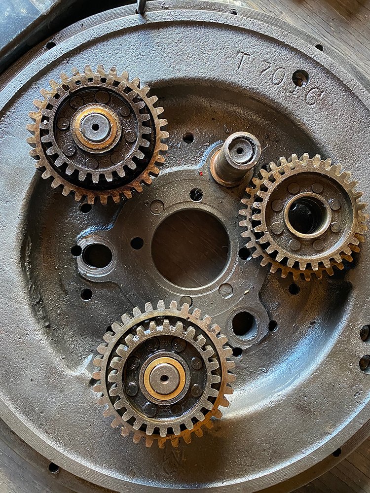

So, after a long winter off the road doing wheels, rear end, new axles and kingpins, took her for the first drive today.
Had a rotational knock noise only when rolling, and not consistent. Would happen once then fine for awhile. I thought possibly pin for the u joint slipping out. I was right. Fixed that. Drove it around again and after awhile, same noise again. Only when rolling. So I check the pin again, it's fine.
I now dig deeper. Took the cover off the hogs head and pressed each pedal. When I press reverse, I can see the triple gear that's visible, move up and down. I thought to myself, that should NOT happen! So I turn the engine over and check the others. Another was just as bad and the 3rd was as bad, but moved.
Engine and trans was professional rebuilt about 3 years ago. Was done by a guy who does mostly only T and A engines. Came recommended by Langs. He did say the trans looks to never of been touched. It did need bushings he said.
Always had a good oil level, use the Lucas classic car stuff. Changed it often. I'd say it has less than 500 miles on the rebuild.
I have a message into the rebuilder. See if he has any insight on what's going on.
Any suggestions?
Any suggestions?

If I understood what your were trying to explain is that your triple gears are moving aft toward the drums & forward towards the flywheel on the triple gear pins. Is that correct? If so you may have some issues. The triple gears are only engaged in low & reverse however if not checked for correct tolerances (0.006-0.010) with new bushing you can have some slight movement but not much, if you used the old bushings and the flange face of the bushings are way below the minimum height you’ll have even more movement. Based on the information you gave that shouldn’t be the case. Other things to consider are loose pins, loose bushings in the triple gears because running tolerance were too tight & the bushings seized on the pins. In addition could be your clutch basket wasn’t properly spaced & locked down causing some drum float. If I’m not mistaken a clearance of 0.015-0.022 is within tolerance but if the clutch basket pin is not set correctly it can cause the drums to float a bit. In my opinion you should consider pulling the engine and check your transmission others may have a different opinion. Best John

Reach in and attempt to move each triple gear around and see if there is excessive slop of if you are able to move/rotate the gear from side to side (not rotate on the pin) or move it radially toward the outside of the flywheel. Check each one- its possible as John mentioned above that one of the triple gears seized on the shaft and spun the pin in the flywheel or the bushing has started to disintegrate. Just one thing to check before moving ahead. Best of luck!

Sounds like you'll have to pull the engine. and take the flywheel off and see what happened to the transmission.
If you 've changed the oil like you mention then this shouldn't of happened unless it had no oil in it or rebuilder didn't do it correctly.

Sounds like the engine was rebuilt incorrectly. If you can see the triple gears moving then the bushings are bad. This sounds like you need to replace the triple gear pins and bushings because they wear out together. Could also be transmission problems you are not yet aware of.
Here’s my suggestion if you don’t want anymore headaches, I would pull the engine and take it to J and M Machine in Southboro Ma which is not that far from you..They are a true top tier machine shop,true pros.They have done 4 T engines for me and I have never had any issues..
What happened to you should not happen but unfortunately it does..I don’t know who did your engine but I do know of one unscrupulous builder in Massachusetts so yeah, it happens.
Good luck.
Good luck.

No, not only after and forward, but up and down significantlyJTT3 wrote: ↑Mon Jul 14, 2025 11:00 pmIf I understood what your were trying to explain is that your triple gears are moving aft toward the drums & forward towards the flywheel on the triple gear pins. Is that correct? If so you may have some issues. The triple gears are only engaged in low & reverse however if not checked for correct tolerances (0.006-0.010) with new bushing you can have some slight movement but not much, if you used the old bushings and the flange face of the bushings are way below the minimum height you’ll have even more movement. Based on the information you gave that shouldn’t be the case. Other things to consider are loose pins, loose bushings in the triple gears because running tolerance were too tight & the bushings seized on the pins. In addition could be your clutch basket wasn’t properly spaced & locked down causing some drum float. If I’m not mistaken a clearance of 0.015-0.022 is within tolerance but if the clutch basket pin is not set correctly it can cause the drums to float a bit. In my opinion you should consider pulling the engine and check your transmission others may have a different opinion. Best John

Rebuilder claims quality of bushings may be the issue.J and M Machine wrote: ↑Tue Jul 15, 2025 9:20 amSounds like you'll have to pull the engine. and take the flywheel off and see what happened to the transmission.
Will be pulling it this weekend and taking apart. Will come back and update with my findings.

Getting triple gear bushings correct & living long is a real technical skill unto itself.
They seem to be the weakest link, especially @ initial start up.
I will add, its not out of the realm of possibility to have a failure by operator error.
I once did a fellows THIRD succession triple gear bushing failure. Couldn't figure out why untill he picked up the finished T. The poor transmission screamed in agony as he backed out of my driveway. This fellow has big feet & cant see the pedals. He was engaging low & reverse simultaneously.
That tore the bushings up fast. Once made aware, no more worn out bushings/gears.

Triple gear bushings need adequate lubrication, and using a high quality, light bodied oil with high film strength in a stock T should facilitate that. As I understand it, the triple gears are idle when running in "high". Using the correct oil and allowing the engine/transmission to warm up thoroughly before running hard or fast in low gear or reverse may help the bushings survive. Keeping speeds down when running in low is probably a good idea. Needle bearings are widely used in modern automatic transmissions, and they seem to hold up very well.

I believe that the drive shaft pin is completely unrelated. It was reused, peened, but I suppose not good enough. The car continued to move no problems.JTT3 wrote: ↑Tue Jul 15, 2025 8:16 pmSo i reread your post carefully and wanted to ask several questions without jumping the shark on the builder until you know what you don’t know. You said you rebuilt the rear axle, did that include the modern pinion set up with a locking collar for the preload? Generally speaking, did you use a new pin for the universal & peen it over on both sides or the original pin same process. You said you have about 500 miles on the engine, paraphrased, how many of those miles were prior to doing the things over the winter months for the T you mentioned but after the rebuild? Did you have any issues during those miles prior to the rear axle being rebuilt? A u joint pin that is not tight & peened in the orifice can be slung out and “can” wedge against the driveshaft bell housing doing real damage to the transmission if in low, reverse & even catastrophic to the total engine assembly in high though not typically. I asked about the modern pinion bearing assembly. If you did use it, the Allen head bolt can sit very proud and cause a knock against the drive shaft housing but I haven’t witnessed or heard of that stalling an engine. As long as the engine didn’t receive any damage, minus the transmission damage, a rebuild on the problem parts will not be too costly though time consuming & aggravating. Wishing you the best of luck & a well working T post repair. Best John
The rear end was mostly cleaned, inspected, new seals, new good roller and sleeve on one side and new axles with new keyways.
I'm thinking the pins for the triple gears are the issue. Not well looked over possibly, and or the bushings not honed/reamed correctly.
Really interested in the triple gears with the needle bearings. Would certainly upgrade to that if the gentleman gets back to me.
I should have an update this weekend, once I have it out and apart!

You will need a new flywheel and pins.
When the pins get loose, there is little you can do.

You might try putting the car in "high", engine off, and have someone rock it forward and backward to see if the noise occurs, and you could also look into the transmission while the load is changing, and try applying the different bands while the car is being rocked. You might want to take out the spark plugs and have someone crank the engine while you observe the transmission's innards and apply the bands, etc. Cranking the engine with the rear wheels off the ground is another option. With the rear wheels off the ground, blocking one wheel and putting the car in gear and yanking the other wheel back and forth might help localize the sound.

If we look at it ,you know what we're going to find
Problem with a Model T is it all has to be done, there is no 50%. The first 50% will affect second 50% and vice versa.
If they didn't do transmission, though did engine part all the dirt from flywheel and magnets will reintegrate with the engine part.
As seen in submitted picture of babbitted rear main bearing with debris stuck in it as babbitt does.
You'll see the bronze speckles .
second picture is dirty transmission. Just can't expect to get these clean by washing alone.
Money well worth doing it right rather than doing it twice.

That one has seen a few miles !

It's all apart, well mostly. I'm deep enough to see the problem.
One triple gears bushing face chewed up, pin spun in flywheel.
Looks like a flywheel will be needed.

The pins are larger @ the base than the flywheel hole. They install from the magnet side & must be removed in the opposite direction. Never pushed thru. The pins must be a tight press fit. This appears to be your failure point. Pin bushing surfaces must be polish smooth. I understand some of the vender supplied pins are not.
The bushing face must be surfaced down to about .010 proud of the gear face. Specs in the service manual.
I believe it necessary to chamfer or re-chamfer the bushing face to the outside edge of the oil groves & be sure there is a good transition from the chamfer into those oil groves. (not done here) Plenty of oil is critical to the bushing. Assemble with oil, never grease.
Follow ALL specs from the service manual. The combination is critical for all the pieces to run in harmony.
Such a spec is the clearance between the driven gear & shaft face, it is deeper than flush.

Had that happen after the hill climb one year. Noisy as all H***
Find a good flywheel with decent pins, and hone the bushings to fit. A stock car will be just fine. You'll need to rebalance the whole shebang.
My 2 cents.
My 2 cents.

As stated, I bet the pins were changed incorrectly, or off spec.
Sorry that happened. It's a shame. At least it didn't grenade.

Well, now we know the story. Sorry for you, but the good news is you caught it before more serious destruction occurred.

I have had to repair many transmissions with triple gear bushing failures. All of them were built with reproduction bushings and then set up too tight. Bushing seizes on the pin and either disintegrates or rips the pin out of the flywheel. Lang’s has Ford spec bushings but they are out of stock. The ultimate solution is Dan’s needle bearing gears. Second best is new triple gear pins and a set of original triple gears with Ford bushings. I have never seen a T transmission failure due to things being too loose. Always due to being too tight and inferior bushing quality.

Makes sense.Erik Barrett wrote: ↑Mon Jul 21, 2025 12:21 amI have had to repair many transmissions with triple gear bushing failures. All of them were built with reproduction bushings and then set up too tight. Bushing seizes on the pin and either disintegrates or rips the pin out of the flywheel. Lang’s has Ford spec bushings but they are out of stock. The ultimate solution is Dan’s needle bearing gears. Second best is new triple gear pins and a set of original triple gears with Ford bushings. I have never seen a T transmission failure due to things being too loose. Always due to being too tight and inferior bushing quality.
Rebuilder did new pins and bushings.
He did state to me when I replace everything, be sure to have .0005 to .0006 thousands. Which is more to a the recommended .0004.
Will be doing Dans gears and pins, working on getting a replacement flywheel and going to start setting it all up!

How did Ford originally finish the triple gear bushings? Were they reamed, honed, or burnished?
How fast do the bushings turn on the pins in low gear at 7-8 MPH?
Triple gear bushing failure seems to be a not-uncommon issue today in newly-rebuilt transmissions, but to my knowledge, Ford factory-built Model Ts did not have a reputation for triple gear bushing failure.

i am very familiar with this problem. In 2019-2021 my newly rebuilt engine & transmission suffered a series of such failures beginning within a couple of months of getting it back on the road after a 30 year sleep. The rebuilder was very aware of the importance of adequate clearance between the pin and triple gear bushings and was never able to account for why my gears hung up. He did stand behind his work although I did provide the replacement parts.
Two of the gears/bushings seized on the pins and twisted them right out of the flywheel. One had the bushing seize on the pin and the gear spin on the bushing. I suspect the pins spun in the flywheel for quite awhile to produce that amount of wear.
Each time one failed it felt like the transmission seized up. Not knowing any better, I coaxed the car back into motion, which probably was when the pins spun free or the bushing broke free of the gear. I can remember three distinct events which I now associate with the failures. Since the 2nd rebuild I have put many thousands of problem-free miles on the car so I think it was done right this time.

I don't see any oil grooves in those.

I rarely see a flywheel with the pin holes chewed out. The few were after current, poor rebuilds. I have seen several where the bushing seizes on the pin & the gear spins on the outside of the bushing. Even to the point of an hourglass type wear pattern in the bushing.
I suspect that such flywheel damage can be traced back to the builder gluing the bushing into the gear. (locktite) That kind of removes an unintended safety for when a bushing seizes to a pin. The un-seizure finds the point of least resistance. Just a thought.

Look into “ burnishing bushings”. I am of the belief that Ford did some form of this to triple gear bushings.
Also look at ball sizing or burnishing. This is done with a harden ball of a special size to make the bushings a certain size.
